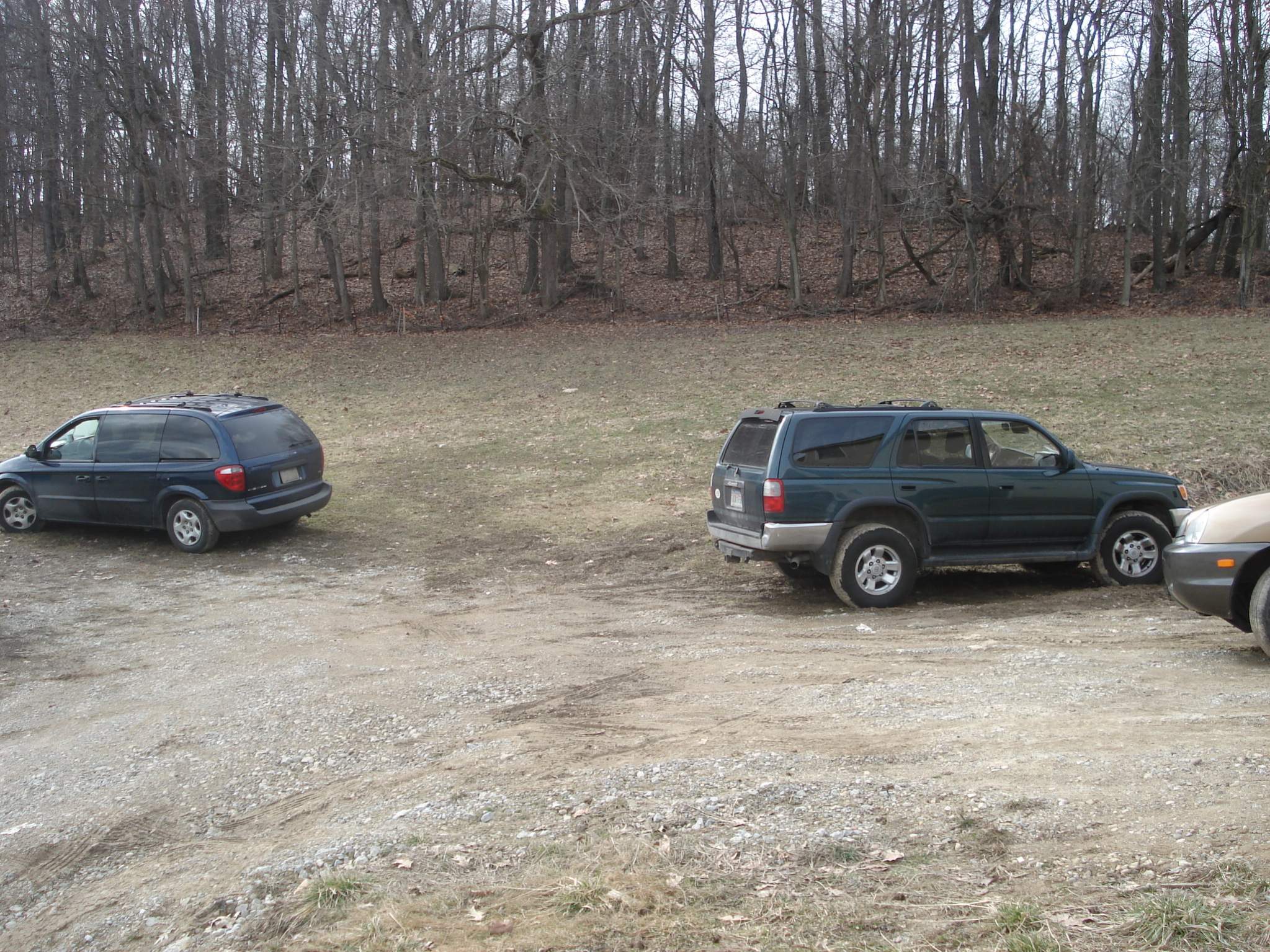

Will be building a garage next to a house, and have to cut into a slope (bank) to put it in. Any ideas on how far back I should leave the bank behind the garage? 1'? 3'? Should I put a retaining wall up? Pros/Cons? This isn't my retirement home, and will be excavating the site with my TLB, and doing everything else I can to save $$$. All input welcome!

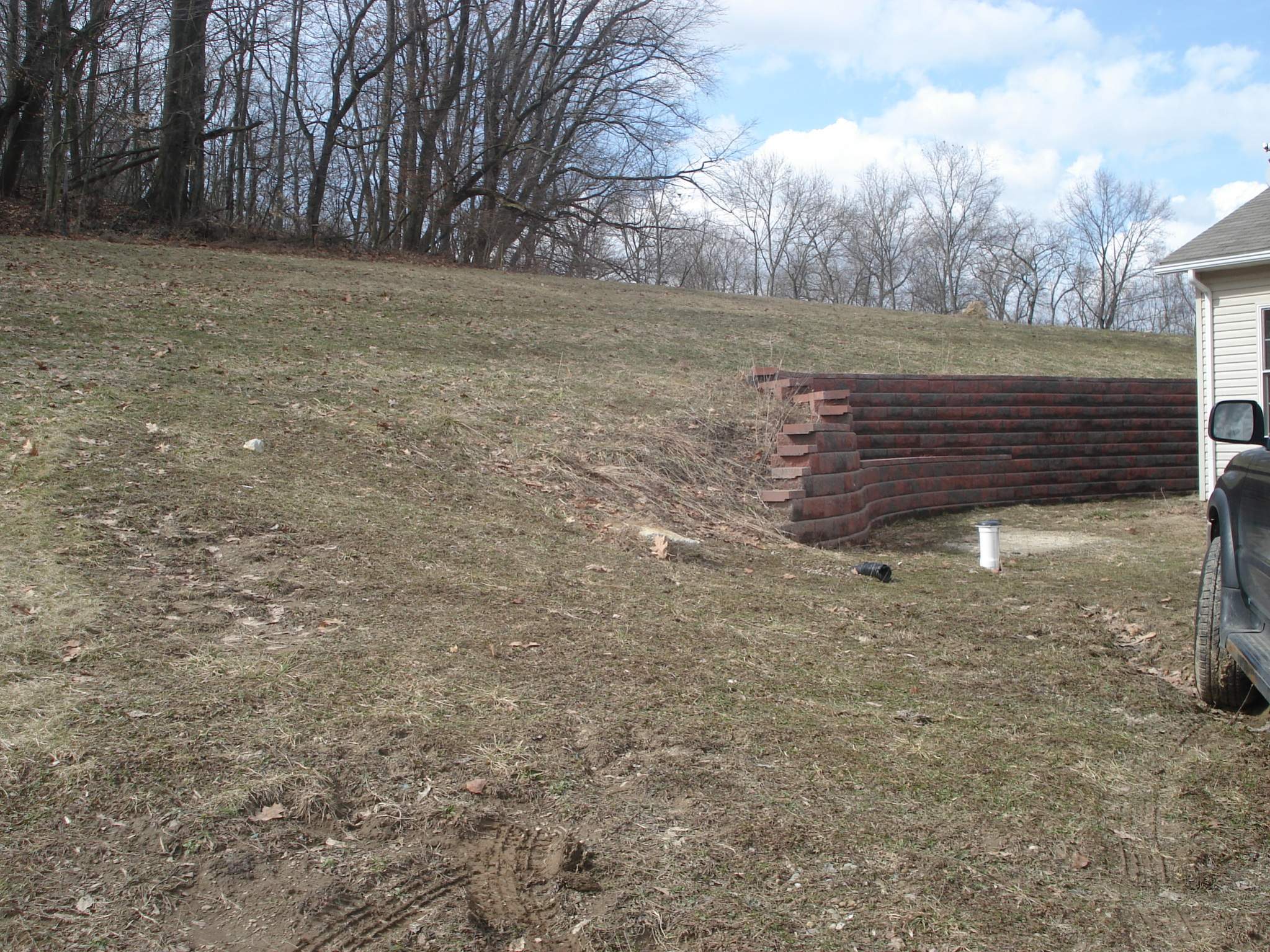

If I understand your question, you want to dig into a slope below your house to start a garage. My house is in the building stage, but take a look at this photo and see if this fits. The wall is for my lower patio, but It could be the start of a building wall if you wanted. THe builder installed a french drain behind the wall to keep water drained out> It seems you could do something similar as long as you had no underground utilities. OF course, you would need to put up the retaining wall during dry conditions and immediately upon digging out. I am building the retaining wall to hold the slab for the house. Seems that you could do the same as long as the soil type will not slough off and allow you to dig straight vertical wall. Leave enough room to install drain tile behind the retaining wall, pour a good footer that goes below the frost line and at least 16" wide with embedded rebar to set inside each CMU block in at least every other hole, fill each block hole with grout and you should have a good retaining wall.

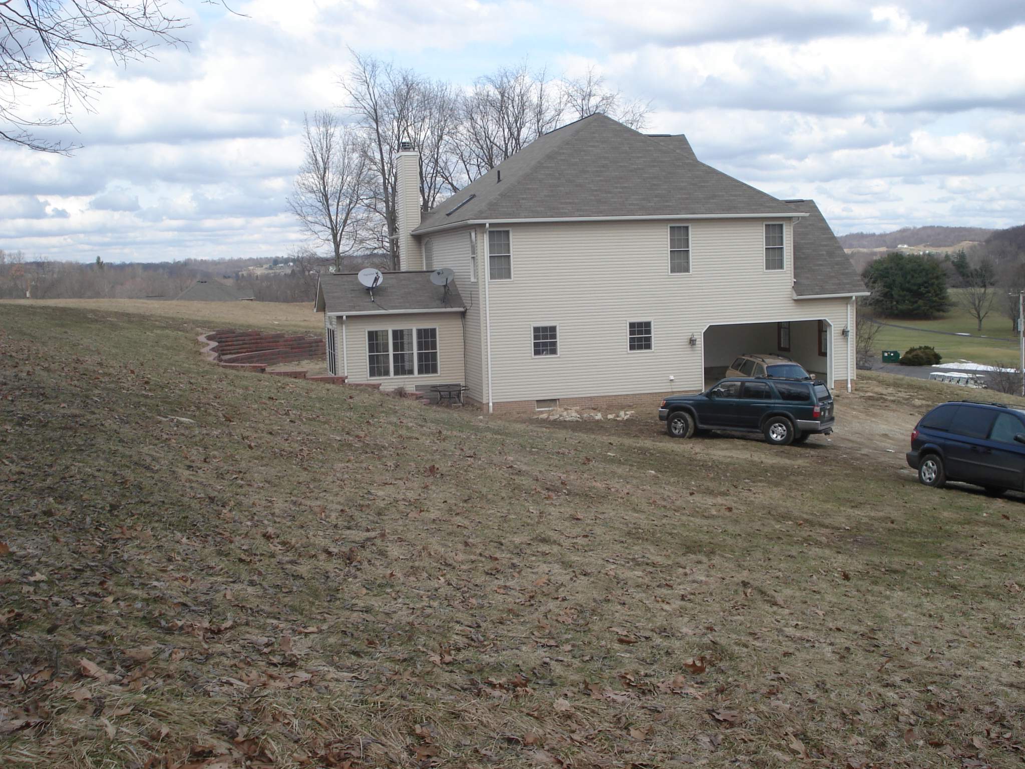

OK, some more info, and pics. I went back down this past weekend, and it is ROUGHLY a 6' rise in terrain per 30'. I really don't want the added expense of a retaining wall, unless it's absolutely necessary. I can cut the bank back farther if need be. But, I'm worried about water runoff. I will put a drain system around the back of the garage. Looking at conventional construction for the garage, approx 30X30. garage will be going between the two vehicles in the pics.
Fire away!

There is lots of good info here, but it looks to me like
the question has already been answered. Behind the
house is a beautiful retaining wall. Wouldn't you
would want something similar behind the garage? or
combine them into 1 long wall?
How tall is that retaining wall behind the house?

Dutch -
They did put a very nice retaining wall up behind the house, it's a good 6' tall. I was planning on continuing the curve around to the garage, but not behind it......as you would never see that nice expensive block!
However, Not sure if I want to cut the bank 10' behind the back of the garage.....I was thinking more like 2-4'.......hmmmm.....

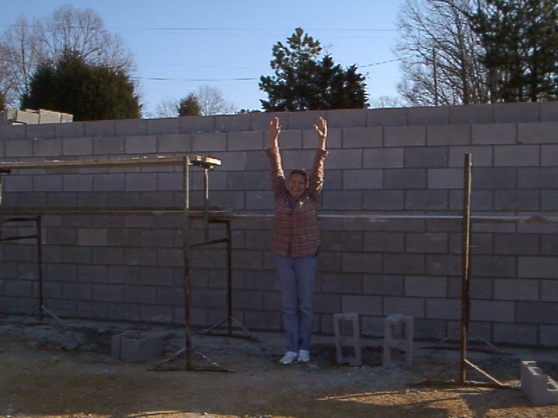

Wow- you got alot of dirt to move. Do you want to have the new garage at same level as the house ? I would- and this means alot of dirt to be moved. Hopefully you have a place to put it.
IMHO- Since this is on a deep hillside, runoff is not really a concern until you start putting up retaining walls. I would have a poured wall, with french drain at the top,behind of the wall and bottom, front of the wall. you have excellent slope for drainage anyways. Since you need a concrete floor, have the same contractor pour the floor and wall. You should have at least 10 ft or more between back wall of barn and finished retaining wall . the ground behind barn should be sloped in a Vfrom center for more drainage.

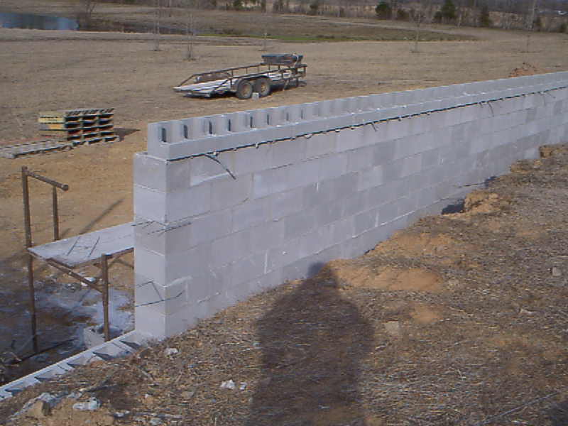

Looks like nearly 50/50 on retaining wall or not. I like the idea of backfilling against the garage for the added insulation. An open area behind the garage would interfere with a path I'd like to have to the left of the garage, going behind it along the treeline to the back of the property. My property goes up to the treeline. How about conventional construction with a block/poured back wall? I've seen garages like I want to install with a block back wall into a bank that's failing, the ground is pushing the wall in. Unsure of the drainage behind it... again, I'm trying to do it as inexpensive as possible.....

put me in the pour a reinforced concrete rear wall of the garage and be done with it.
less expensive than a retaining wall with less dirt to move.
