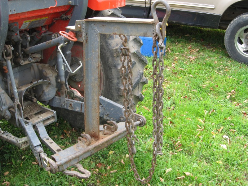

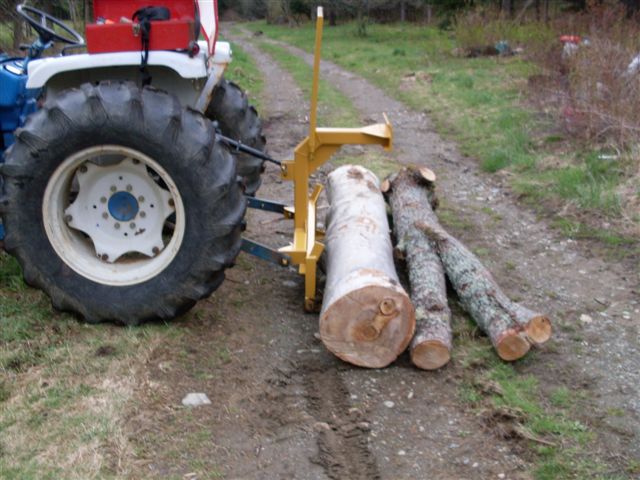

Take a look at my setup, It has no winch but you could add it to a plate welded to the post. You may want to add some gussets to the post if you do that.

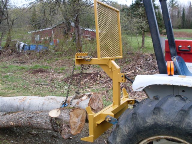

Get an iMatch and toss those tongs on the top hook. What you are picturing, won't get your log up very high.
A pic of a white oak log on the tongs.

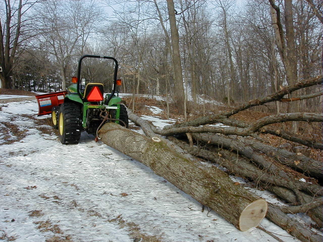

electric winches dont take the work load trust me . I built this skidder for my tractor then still bought a norse.

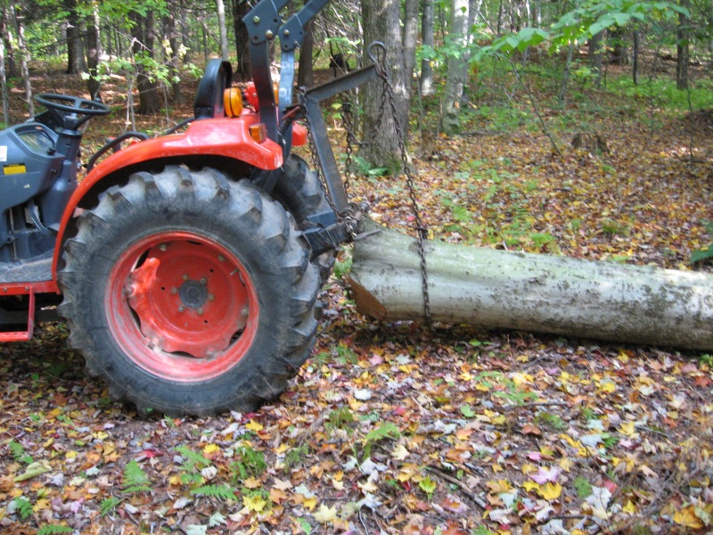

Here's how I do it. Check out the trail left behind. When I'm done, you can barely tell that we were even there. For small lot jobs, my clients prefer the less noise and small "footprint".
Some might say it is a pic of three horses behinds, but I don't mind.
