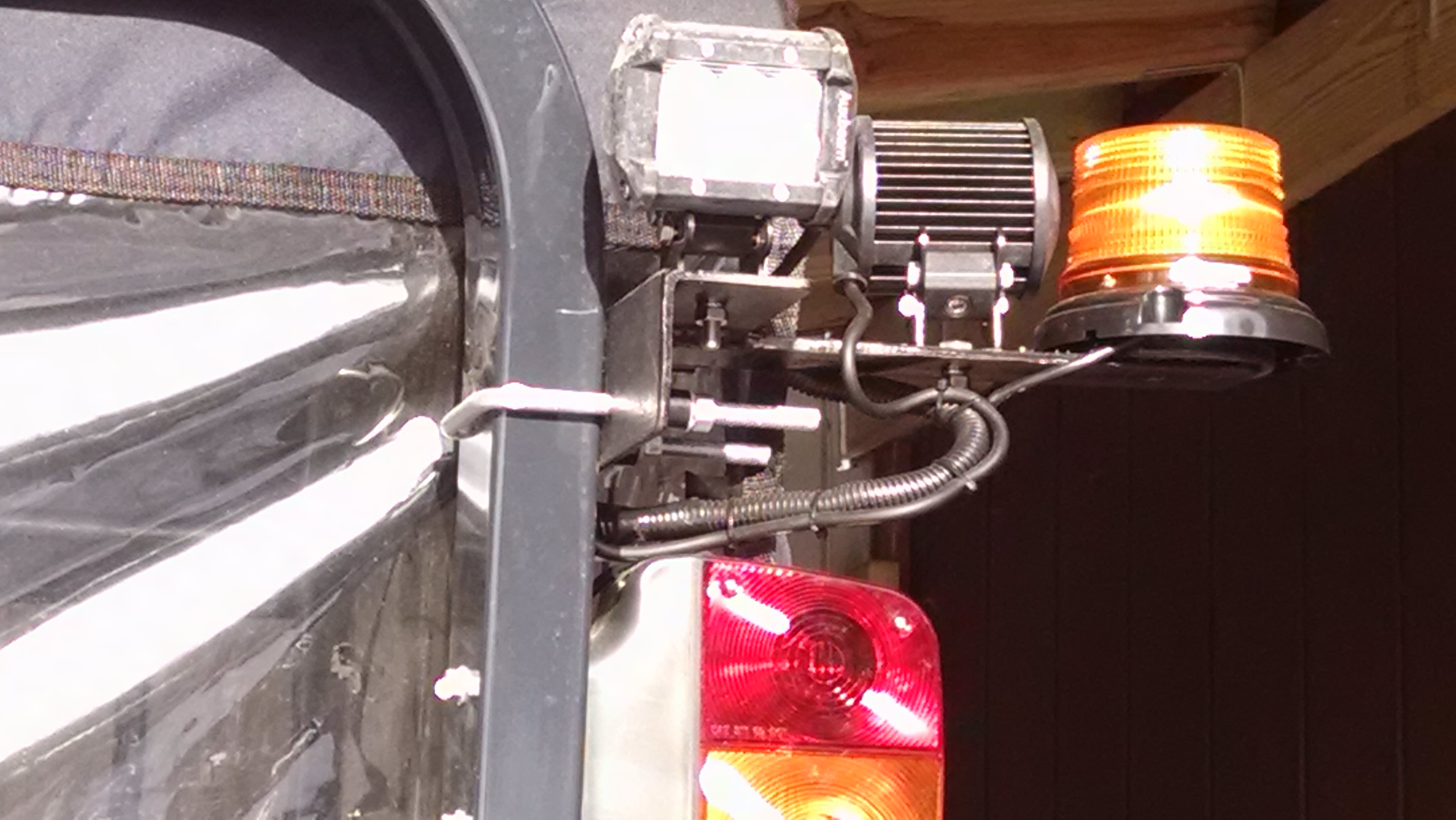

Hello,
Would someone recommend replacement Curtis Cab Roof Lights for my JD 4310. Just not sure if I should go with Halogen or LED work lights . . . primarily for snow blowing at night.

LED all the way.. They use little power, last a long time and are very bright.. A 4inch flood on all four corners is what I use, lights up the work area like daylight..

I want to hook the lights you recommended to a 6 Rocker Switch Panel - one Rocker is the main and each of the other Rocker switches control other electrical devices on my 4310 . . . I have a 20 amp fuse on the power line going to the Rocker Panel. Will the LED lamps work with this set up . . . any idea?
FredSG
/ Curtis Cab Roof Work Lights #8
I don't see why not, they draw very little.. I hooked all four to my headlight switch so when I turned on my headlights they all came on..

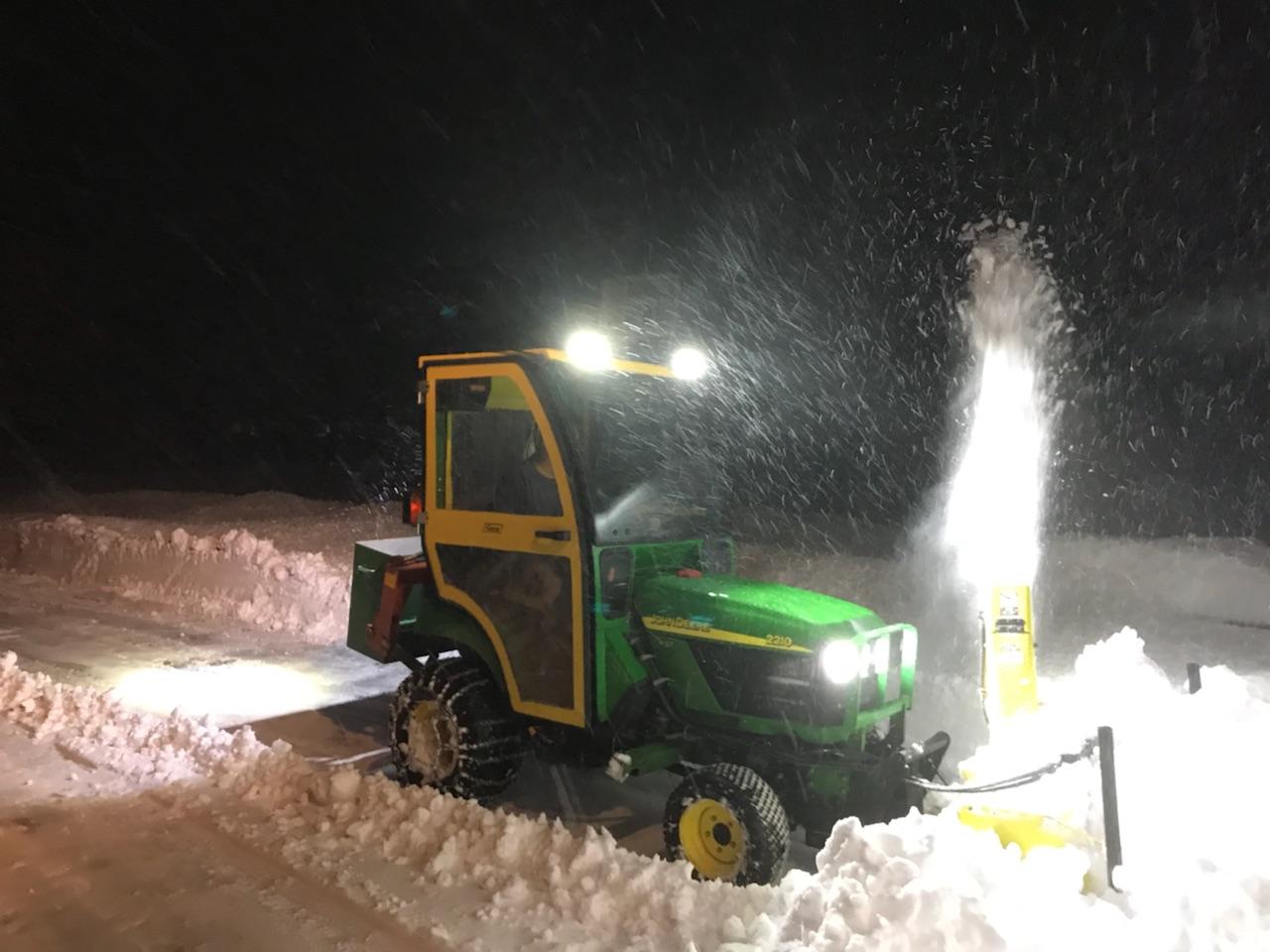

I have the 7" flood LED's from Amazon on the roof of my Curtis cab.
Amazing improvement over the old halogen lights.
