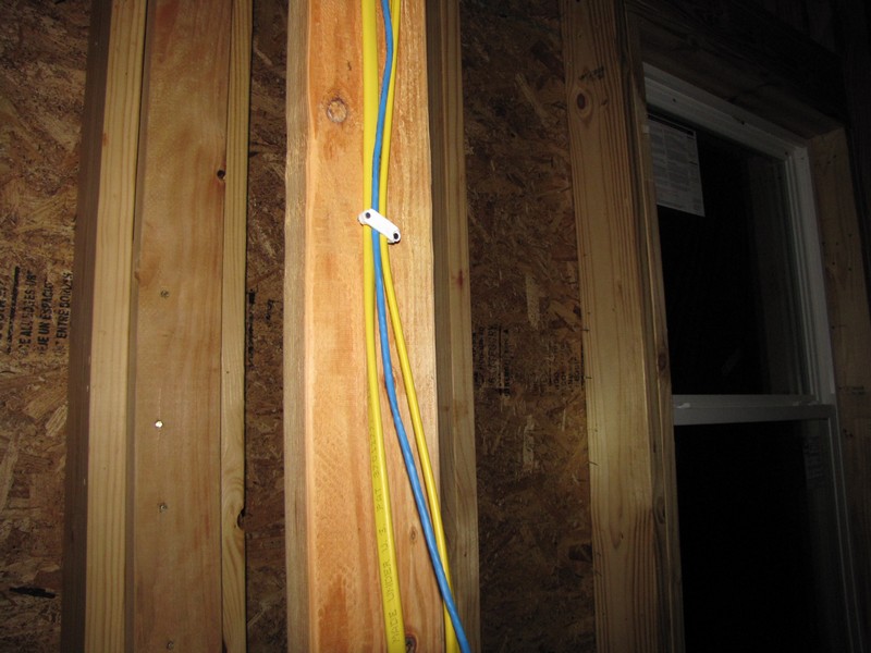

And I am not a licensed electrician, but some things just seem wrong. Here's an example of the low voltage wire and the 120v wiring.
Yes that photo it wrong. You shouldn't run cat5/6 with the romex. The inductive field around the romex can cause all kinds of issues with the cat5/6.
Based on your story I'm more concerned about the "electrician." Ask your builder to bring a full time electrician in to verify everything. If it's all good it was $80 spent for piece of mind. If it's a mess at least it will get fixed before drywall and or you are living with stuff you don't want.
Btw it is understandable that an electrician wouldn't do the low voltage. A lot of them don't do it anymore because it has become such a specialty.
