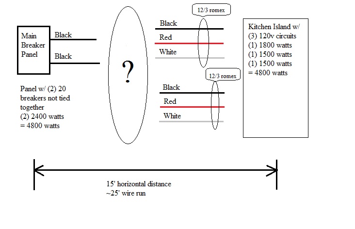

Yes, the OP is still here and following all the responses. I will need to draw y'all a circuit diagram to help explain it better, but in the mean time, I talked to be builder and we have an answer and a solution, it'll be fine. 1st, Part of the problem is that english is not the electrician's first language. 2nd, all the circuits on the island are 120 volts 20 amps. 3rd, there are 3 circuits on the island and only 2 circuit breakers and the circuit breakers are not tied together. 4th, there are (2) 12/3 romex to the island. 5th, there are no red wires going to the main breaker panel. 6th, the 10 gauge wire on the 40 amp breaker - he didn't have a 30 amp breaker in the truck.

Here's the diagram
The 12/3 romex runs to a junction box in the attic. The 12/2 wire from the breaker panel runs to the same junction box. So, here's what's going to happen: One of the 120v 20a breakers will be removed and replaced with a 240v 20a breaker and one of the 12/3 romex will be extended to the breaker panel. That will handle the dishwasher and the 120v water heater. The other 120v 20a breaker will remain and be connected to the black wire on the 2nd romex to power the outlets on the island and there is a switch on the island to control the lights over the island. The red wire will run from the switch back to the lights over the island.

I probably need to re-read, and missing it. But why are you replacing with a 240 breaker, if both loads are 120?
Each leg of breaker is 120, serving same purpose as tie handle.
/ Current on a 12 gauge wire #138
Ok, this is because sharing neutral.
Reading up, code changed in 2008 to require a tie between the 2 circuits. Probably a good idea. I am not sure if I have shared a neutral in a long time. Most of the stuff I do is single point, or wiring a garage that would have panel or a sub panel.
I had not heard of using a 2 pole breaker, but I guess it is the same idea. Given so, no need to be scared of a string.
If you lose the neutral, you could potentialy have 240.
Myself, small subpanels have gotten very cheap. But the problem is a homeowner may not understand these. Circuit trips in sub panel, and they con't know it is there, everything fine in main. I have heard of this happening. Good labels help.
It does have me thinking, if I have any work out there, that has shared neutral.
12/14-3 is alot more common than 4 conductor. I suspect lots of places have, you pull 12-3, one for lights, one for power. Alot of them do not have tied handles. But it is a good idea.
