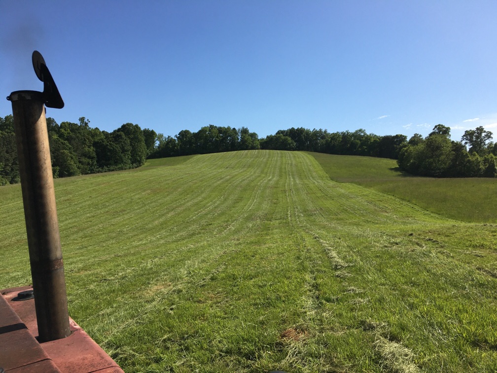

I've also been eyeballing a Schulte 15' however, before I knew too much about them, a dealer 3 hours away from me had a Schulte 20' get sold right as I was eyeballing it trying to figure out if I could stop it going down a hill. (my understanding is the highest spot in the county where I live, happens to be the hill my house sits on..... and the farm owns the entire hill)
I don't want to get manhandled by a mower going downhill.
/ Curious about deck rings on flexwing mowers....
in fact, those pictures above are of that very hill being cut. The pictures sort of hide the length. It's not terribly steep per se'.

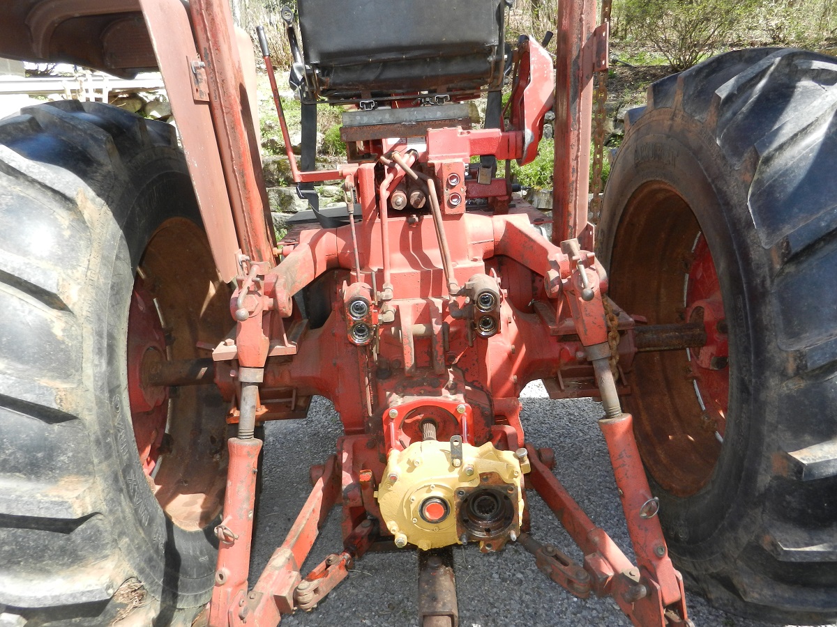

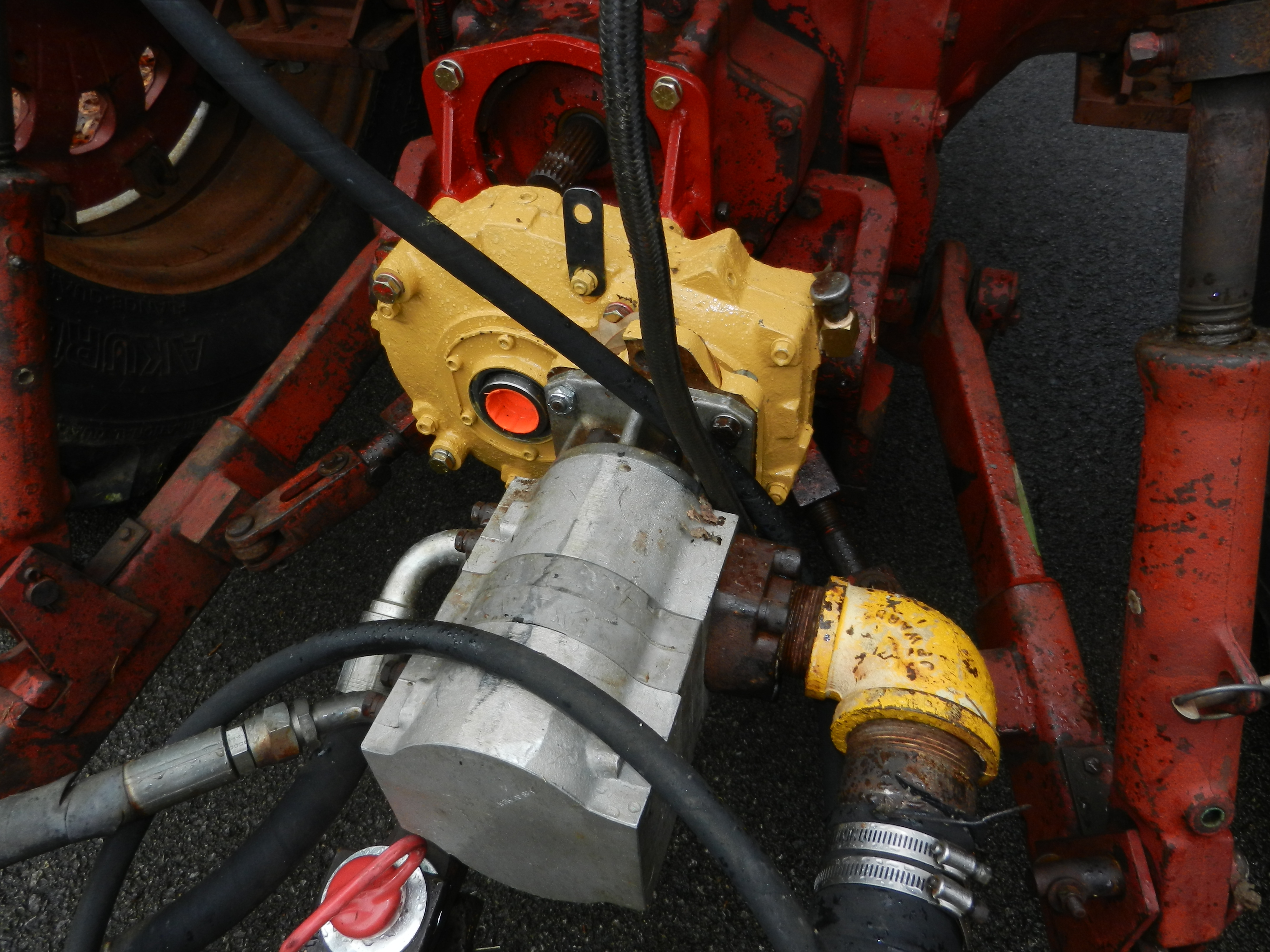

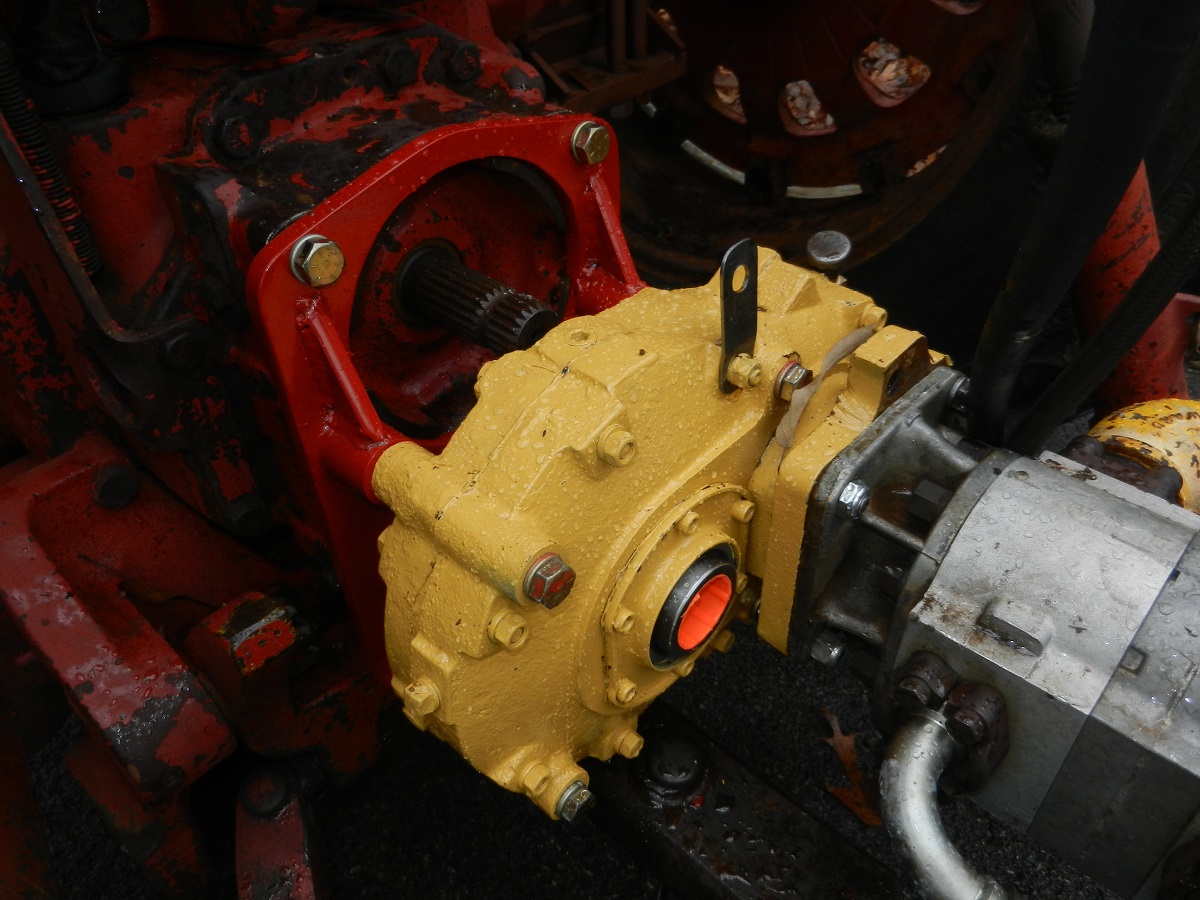

Must have really crunched things. Looking at how mine mounts, (adapter mounted to tractor, speed increaser attached to adapter, pump then attached to speed increaser)
I have a hard time seeing how someone could crunch that unless they really got folded in half. Ouch.
