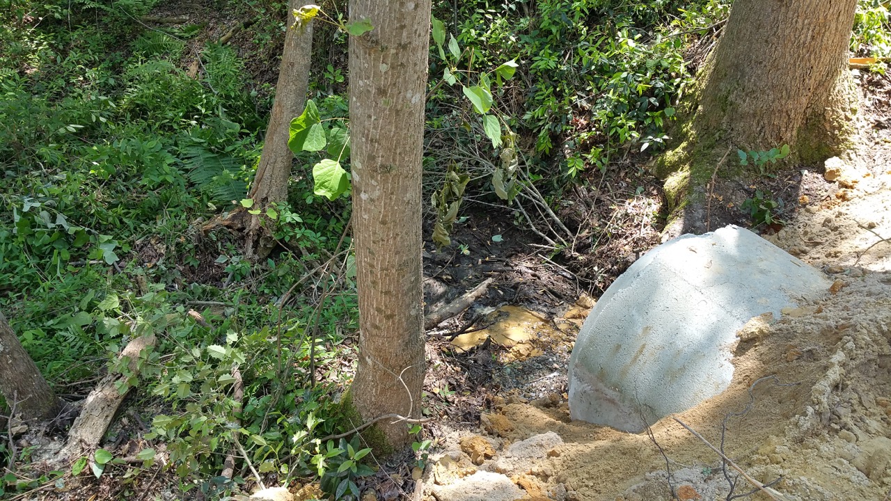

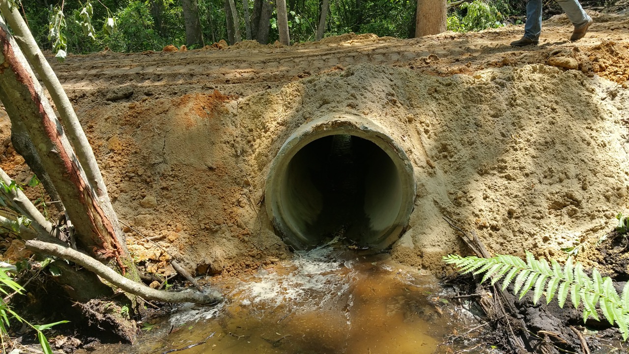

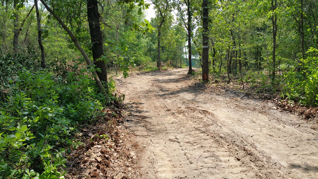

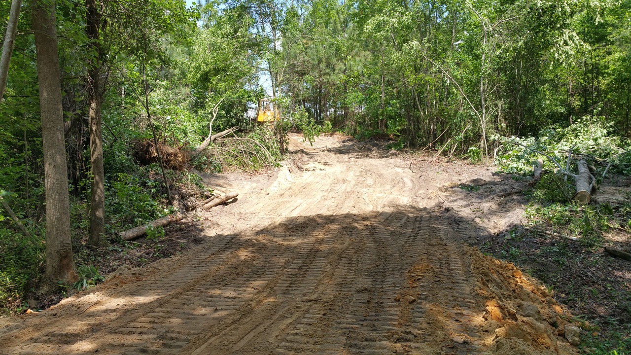

Hello everyone-
This thread has really come a long way. Just wanted to post some updated pictures. We went ahead with the three pieces of concrete culvert. Its a total of 24' wide x 36". Total cost for all three was $325 with transportation.
Im so glad to those who strongly recommended that I go with the 24' vs the original plan of 16'. There is no way that 16' would have been wide enough.
We still have work to do yet, but I can get the truck across pretty easily, which is a good start....
/ Culvert Question #69
Looks real good. You got a killer deal on them.

By the way, your state or county probably has a regulation as to what size pipe is needed there. It would have to accommodate the standard stream flow and a "historical" storm event (usually in the 10- or 100-year range, but everyone has different specs). Be sure to check and see what they require before making any decisions!

Install looks great, are you putting in header walls to stop the erosion around the inlet and outlet? A gift card would be a great IDEA!
/ Culvert Question #75
Know you need 2 flared end sections to prevent scouring and a a ton of rip rap . Looks good , nice job !

We talked to the state as well as the Army Corps of Engineers before we did anything . The ACoE sent out a representative to do a site visit. I can honestly say that both the state and federal representatives were very helpful. It did take about a month to get it all approved, but it was worth the extra wait. We don't want to have any issues down the road.
/ Culvert Question
#77
We are going to add rip rap to both sides once things settle a little.
/ Culvert Question #78
Yep. Let it settle so you know you aren't going to have to add more fill material before you rip rap the ends. Looking good. Anxious to see the rest of the roadway develop.
