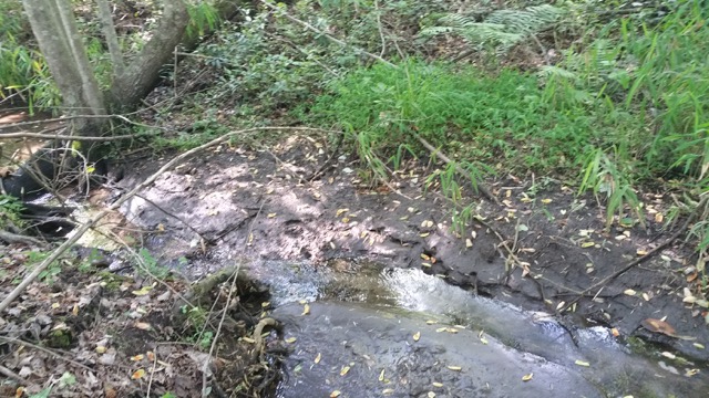

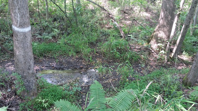

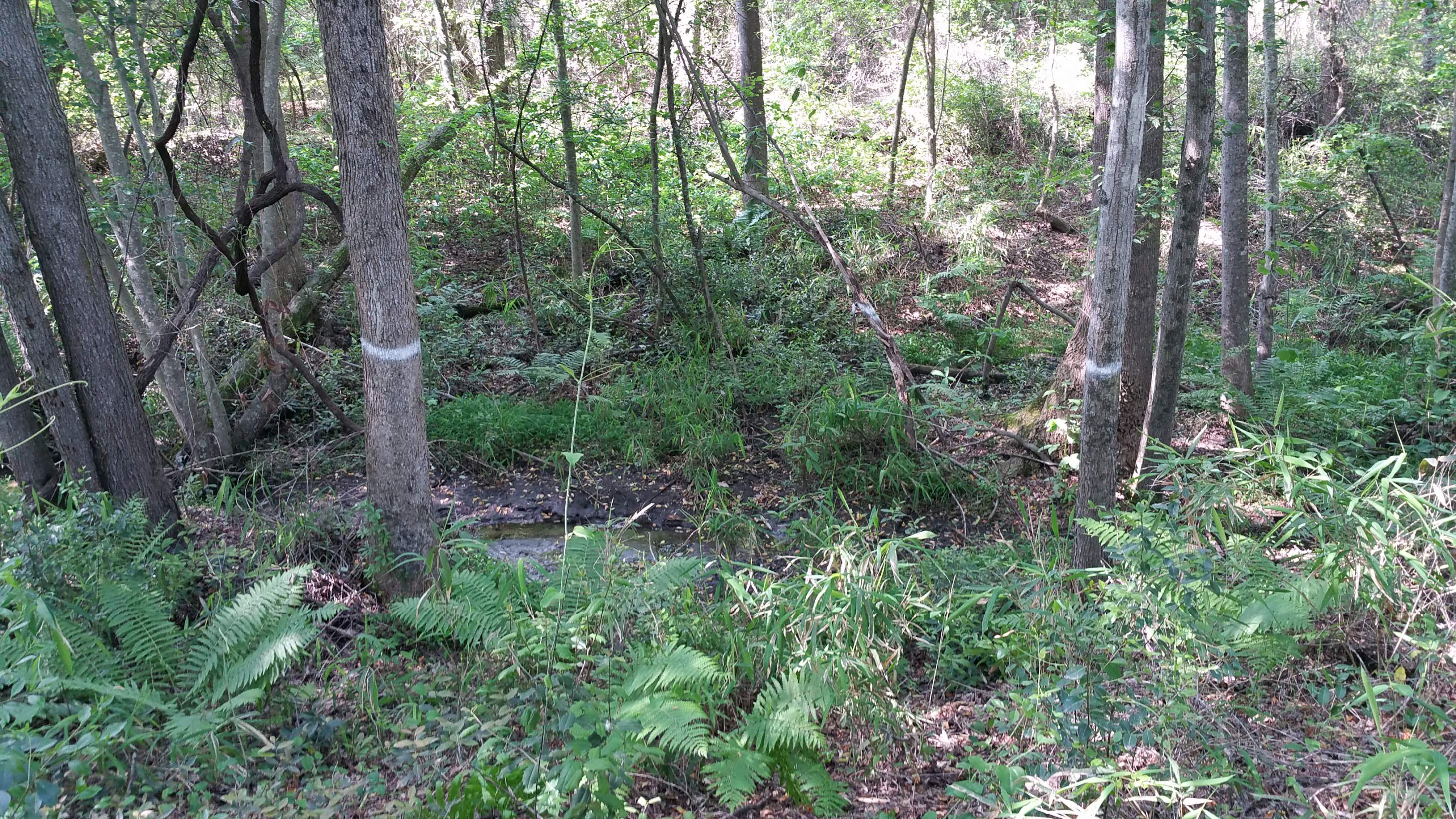

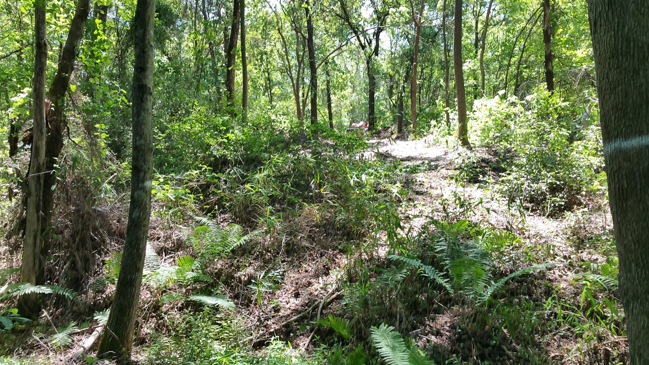

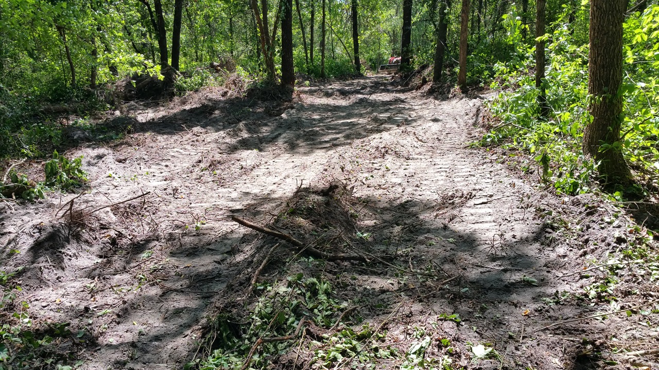

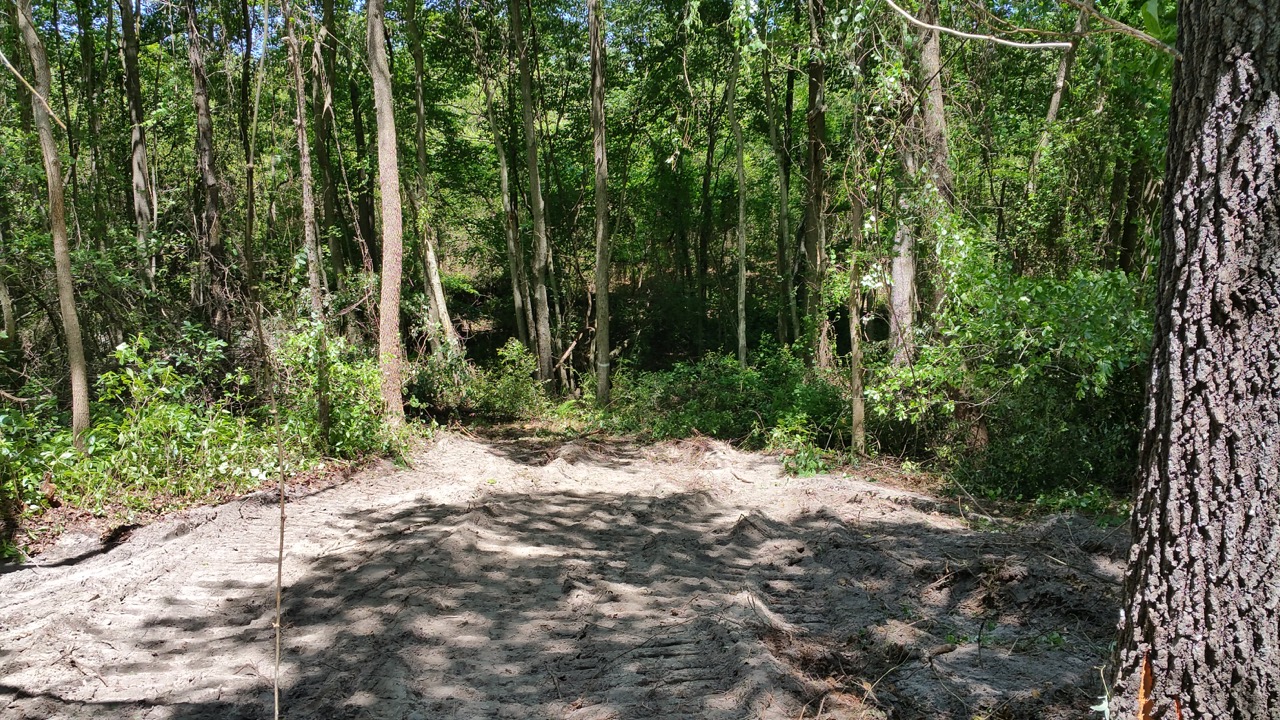

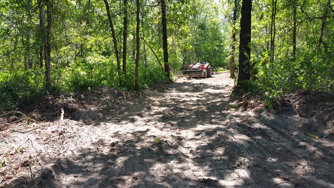

Well - they started to clear the road today. They made it down to the creek crossing. The road clearing is approx 12' wide, which actually seems a little narrow when driving my truck through. It looks like I was able to secure a third concrete culvert - so we will start with 24' width at the creek ]before fill. The angle of the road is a little steeper than I had originally thought it would be. I downloaded an app in my phone that is supposed to tell you the slope of a road. Mine varies from 12 - 20%, but increases to about 30% when you get to the creek crossing. My guess is that this will be slightly decreased once we bring some fill in for the culvert. The soil is pretty loose sand, which makes me think I'm going to get stuck pretty easily in the truck.
Once the area is reasonably level can I just start putting down crusher run? Would you recommend that we start with geo-tex fabric first?
Here are some pictures - please provide any feedback that might help us out....
Justin

Wow, that does look sandy! One section of my property is like that (great for the septic field) and is basically held together with pine straw and a thin layer of topsoil. Have to be very careful disturbing it, otherwise it will wash out easily.
If the area is all sandy like that, you will need something between the crusher run and the sand. If money was not an object, I'd want geotextile fabric, then a layer of #3 gravel, then crusher run. If budget is constrained, I'd have a hard time deciding whether the fabric or the layer of #3 was more important. I am thinking the #3, since it will give a base that bears weight, whereas the fabric will not. Really, if you can do fabric, #3, and then crusher run, that would be the best.
Good luck!

I don't think anyone on this website is equipped with enough information to give you solid advice. I think you need to be consulting with the guy making the roadway. If you don't think he is competent enough to guide you correctly, you've hired the wrong guy. The Prius is not going to like what I see so far, and neither is your wife. :(

Fair enough - I was just hoping for some thoughts from people who have "been there - done that". If the area is leveled, compacted, and stone/crush and run is added - will that not leave me with a viable access road? I understand that these things can be complex - but I imagine that if you follow the proper steps it should work....
It's not that I dont "trust" the guy building the road - but I don't want to have blind trust.

I don't care how much stone/crush run/fabric you pour on that roadway, it's still a trench. You need drainage. That is going to require more width to crown it or material hauled in.
Now you see what I mean?? I'm talking "Missouri" conditions. You aren't in Missouri. So unless you can find a member on here that lives down the road from you, our advice is worthless.

1. Let the area settle for about a week
2. Bring in dozer w/six way blade to shape road and cut ditches for water runoff
3. Lay geotextile fabric.
4. Lay base layer of larger stone.
5. Finish off top with crush and run.

What do y'all think about bringing in dirt to help out with the really sandy areas? I think that compacting and shaping sand like that won't really be possible.

Harf to judge just how sandy it is without seeing in person. Adding dirt or clay to sand may help, or it may make a big mess.
