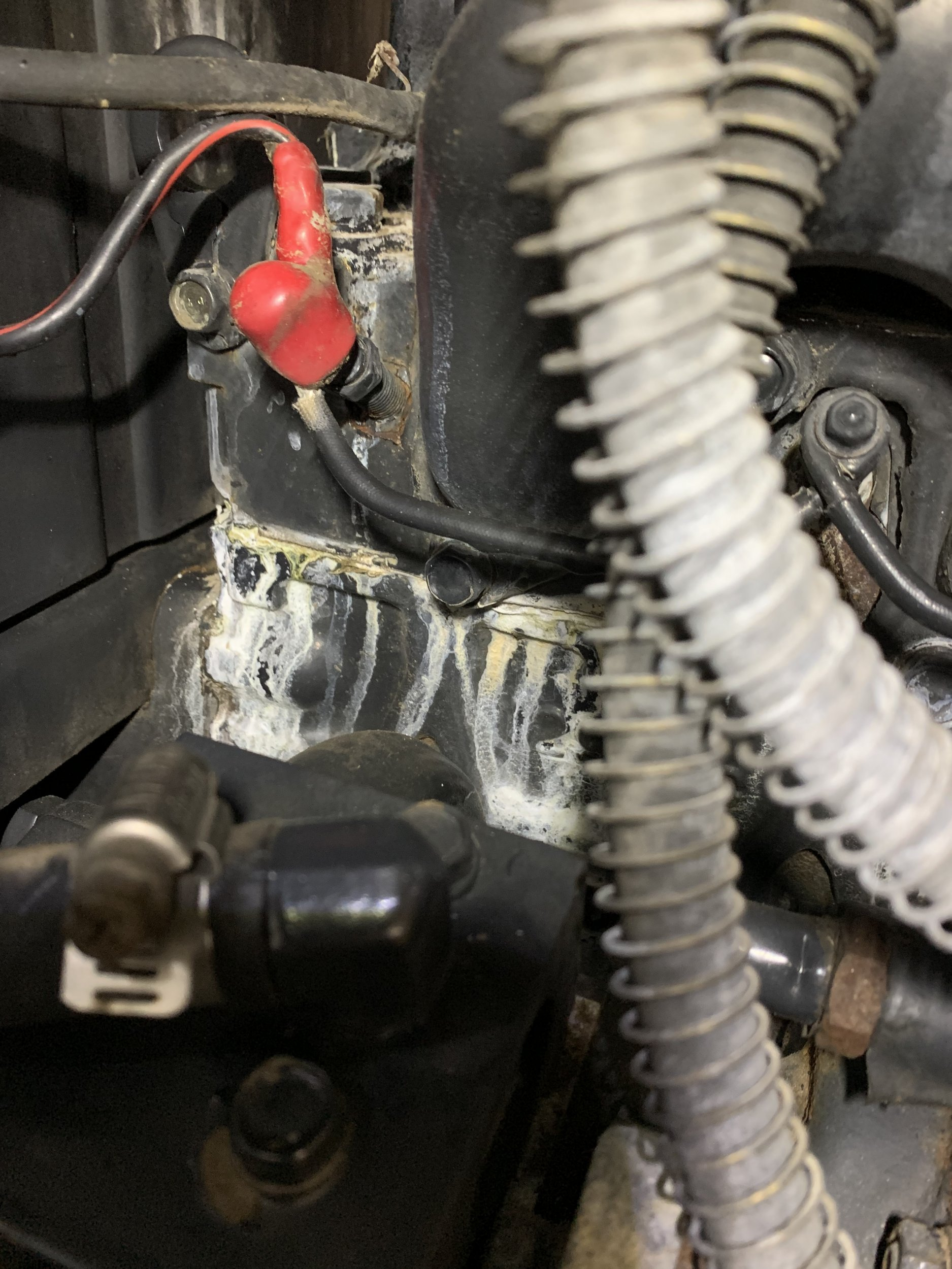

Looking on the right side, rear of the engine block where it meets the head, I see all kind of seepage marks. Im hoping this is spilled diesel. Can anyone comment?

No doubt something is going on. Seeing the appearance of leakage on top of the head is mysterious. Is that possibly from the busted hose? Have you replaced the busted hose and run again? You need to verify where the leakage is at.

What looks like crystalized coolant on the back of the head (pictured) was there before the hose blew.

I don’t think that’s diesel fuel. I’m not sure what you have going on but somethings definitely up. I have had my overflow leak out when I’m on uneven ground but never had a hose blow out. I’m guessing you have something blocked in there some where. Keep us updated with what you find.

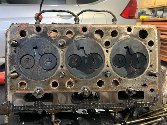

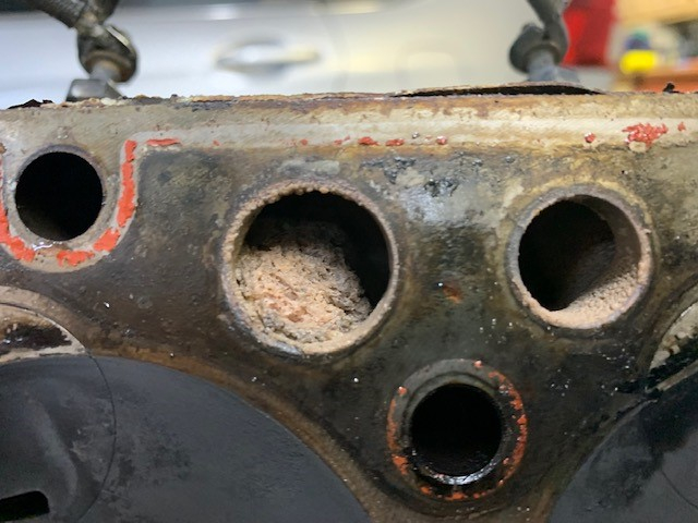

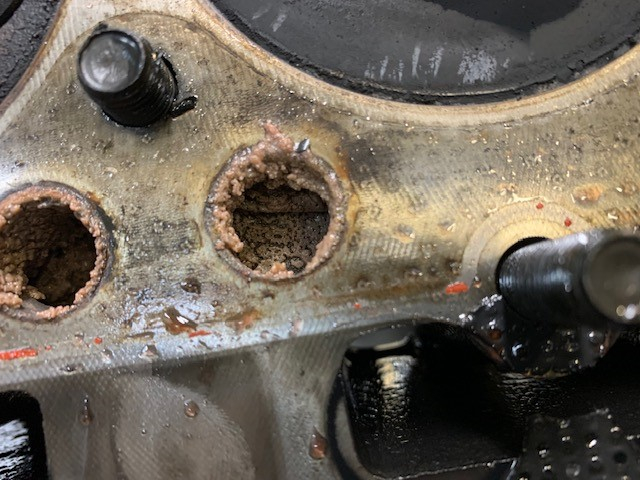

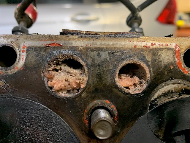

Hello all, just wanted to follow up. I put the tractor up for a little to deal with other projects, I bought this only because I assumed it would not be another one.....
I pulled the head off last Friday and boy, I was not happy to see the water passages blocked by the headgasket in a can. See images below.
My plan:
  1. Pull the radiator and see if the local radiator shop thinks they can clean it up for me
  2. Take the old head gasket and bolts to the Kioti dealer near by and verify the gasket and bolts they held form me match
  3. Pick up any additional gaskets I need like the water pump, intake and exhaust gaskets
  4. Pickup a set of long bottle brushes to clean out as much of this BS miracle head gasket elixir out of the engine
  5. Clean, Clean, Clean everything. At this point the fuel system, oiling system, cooling system in one way is open and I need to used compressed air and mechanical means to clean the passages as best as I can
  6. Bring cleaned head to work and check if for warping on a surface plate (I work at a machine shop)
My fear is the little bits of this grit I can't remove will "re-activate" and form new blockages in the system. I don't know if the stuff left behind is already "activated" or if it can react the way it did originally time and time again.
I can't imagine I am the first person to encounter this much head gasket in a can sludge, someone out there has been through this before!
