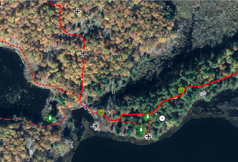

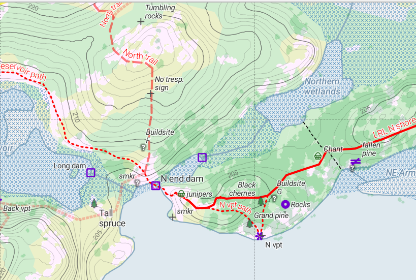

If it's worth the time and effort to do it well, use the free and open source GIS package QGIS (Welcome to the QGIS project!)
It has a learning curve, but it is very powerful; equally powerful to expensive commercial mapping software by ESRI.
Grab aerials and property lines off your county/state/whatever GIS mapping site, loading them in as layers. Or from World Imagery Wayback. Or use QGIS's own QuickMapServices plugin to pull them off Google, Bing, etc.
Then create and style vector layers with features you want to mark, like trails, fences, location of hunting blinds, prized trees, whatever you want.
You can then create thematic maps at whatever size you want, even create custom electronic tiled maps you load into your smartphone to use on your property.
I've done this with our 700 acres, and used it to keep a tiled map on the smartphone I update every month or so; 11x17" maps I print out for visitors on a work printer; and a really nice comprehensive 24x26 poster map I uploaded as a PDF to the local printshop and had them laminate. Plus I've printed out a much less detailed map in support of a county severance application.
Don't get me wrong, this takes some time and energy to do well (and is probably best if you're the kind of person who's comfortable doing stuff on computers, aka geek, of course). But it is the most flexible way.
Attached is an example of our self-made map of part of our property: features layered on top of the government's latest orthophoto as well as a linemap with contours (derived from the government's elevation model), waterbodies/wetlands, and landuse.
