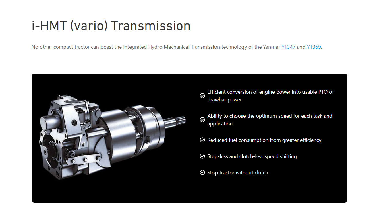

Just like the Vario....
There is a reason why Yanmar also includes the word "Vario":

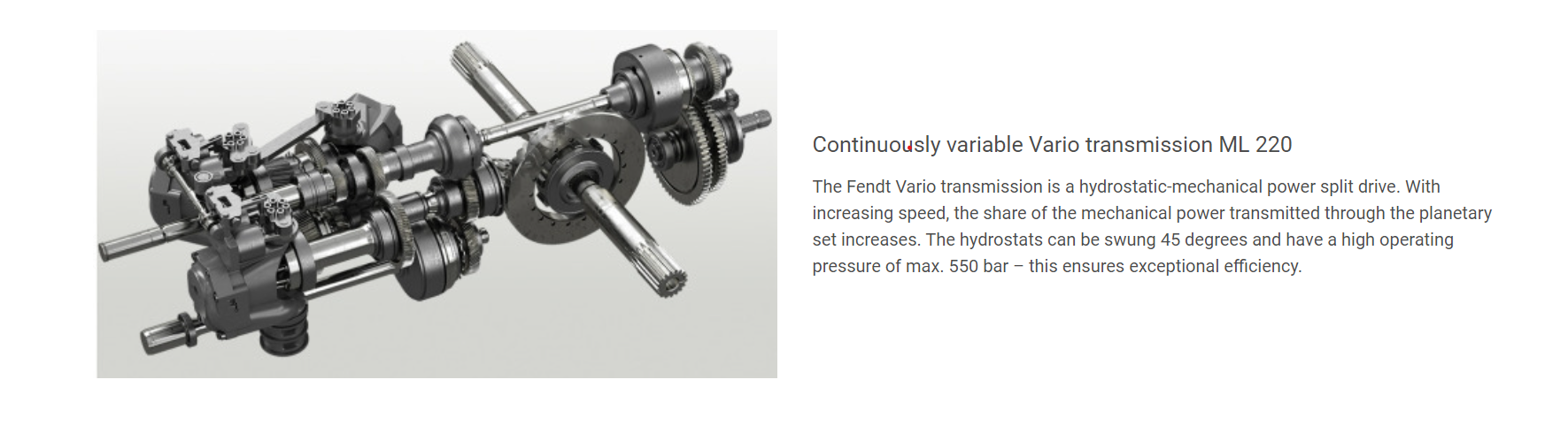

Not the same. Continuously variable Vario Transmission (CVT). Does not work the same.
Wow. Did you even bother to look to the video and link I shared? It's literally the same thing.
You seem to believe that Yanmar came up with this crazy innovative idea. Guess what? They didn't. Fendt did it and has been using these transmissions for years. Kanzaki then, managed to create a scaled down version of the Fendt Vario and called it HMT.
I really can't understand what other differences you see in both transmissions other than different naming, if you bothered to actually learn how the Vario works that is.
