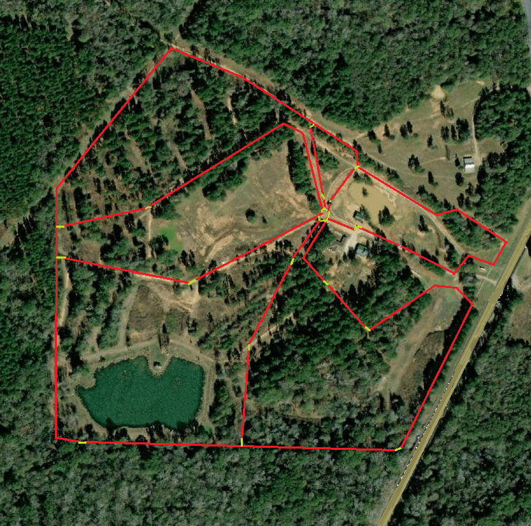

Eddiewalker, can we get a goggle earth pic of the property? You can crop it so we can't see the co-ordinates or any other location references.

This shows what I'm doing with my fencing. There will be 4 pastures that will be around 12 to 14 acres each. Then there is the barn/feeding area, which is about 5 acres.
The barn is in there, but it's too small, so my plan is to make it a little over 3 times bigger. From the barn, the animals will walk to a roundabout with gates going to each pasture. I'll have the one open that they will be using. When I want to move them to another pasture, I close that gate and open the other gate. Then in Winter, I'll just leave all the gates open. There will be gates between each pasture so I can mow easily, or just get around my place.
Currently I'm working on the first two pastures, so I'll have 24 acres for them. As I clear the land and create more grass areas, I'll put in the fence to divide it into two pastures. But that's down the road. Once the 24 acres is fenced, my next goal will be to get a fence all the way around my place. Then I can work at a more leisurely pace at clearing and planting coastal Bermuda grass. Right now, I feel under pressure to get the fencing done, get the barn built, and get the cattle here.

Is this a mistake, or is it not part of the property?

That's my front entrance. It leads to my houses. The pasture above is the 5 acre feed area. It has a small half acre pond, and my little barn. The red lines are going to be where my fences go. The green in the red lines are going to be gates. Where they all come together, is where the roundabout is. There is a small triangle pasture in the top center of the picture that is where I'm planning on keeping a couple of intact billy goats. I might not do that and just get rid of all the boys until I want to breed. It's easy enough to buy one for breeding and then sell him.
