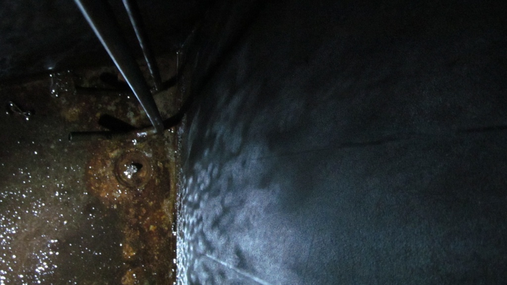

Ok just flushed 2nd vinegar soaking. Also was able to fish out a piece of black PVC pipe. No idea how that got in their along with a broken spark plug. Anyway the gunk in their looks like brown greasy mud which is why I think the vinegar is not working. How do I remove the greasy stuff without taking off fuel tank? IMG_2219.JPG

WOW! The fitting you hold in your hand in the pic sorta' tells all. YOU GOT RUST! And rust can easily destroy anything like your injection pump if it gets past your filter(s).
If it were me I'd pull the tank and burn it out, possibly by using gasoline, CAREFULLY! or diesel fuel or a combo of both until there is no evidence of anything but clean bare metal in your tank.
If you can't get it damnn near perfectly clean yourself, including trying the sharp rocks trick, it maybe time to hire a pro who has the tools/experience to do it right. Think about it - without correct clean fuel you have no tractor to use. What is it worth to you to have a reliable tractor?

I agree but am determined now to not pull the tank. I know probably stupid but I have 3-4K in the paint job and figure something will get damaged in the tear down. On a positive note I looked the tank over again today and I'm seeing improvement. Then I bought a bottle of clean diesel to try. It says us 32oz per 50 gallons but I went stronger. More like 32oz to 10 gallons. Lol. It almost instantly starting attacking the gunk and I could see some bare metal. Put a small grill brush in the tank and started moving around and scrubbing what I could and diesel fluid turned instantly dark brown. May eat a hole in tank but guess we will see. Lol. Definitely starting doing more than anything else I tried to date.

Well it got about 1/2 more of what was left in dissolved it out. Changed fuel filters and ran it all day with no issues. I have dual filters so will just keep using it for a bit then change out the filters again to see what I have going. Definitely way better than it was and hope it keeps improving.
