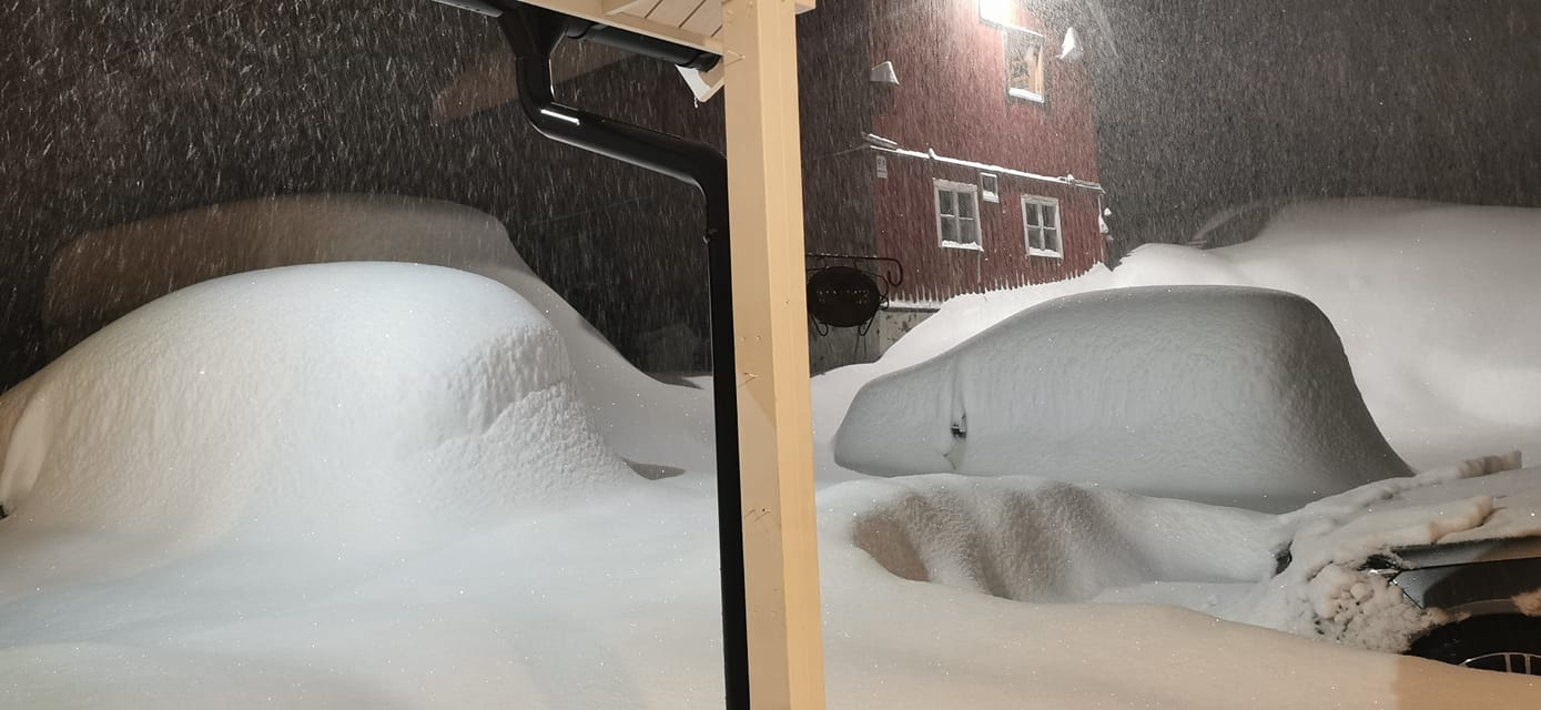

I live in the woods of MT, if I lived out on the prairie dealing with drifts I'd have a front mounted or deal with a rear facing. My old man told me this weekend, it snowed 40cm (15.7inches) while he took a nap in 1.5h 😲
This is at 69 Deg North in Norway FYI.
I just got back from a couple of weeks bicycling the far Northern coast of Norway and far north Finland- I saw tons of 3 point blowers, TONS, not sure i saw a single push blower. What i also found interesting was the percentage of v- pull blowers which i had thought were going out of style but still seemed to be in the majority there and saw quite a few that looked new.
