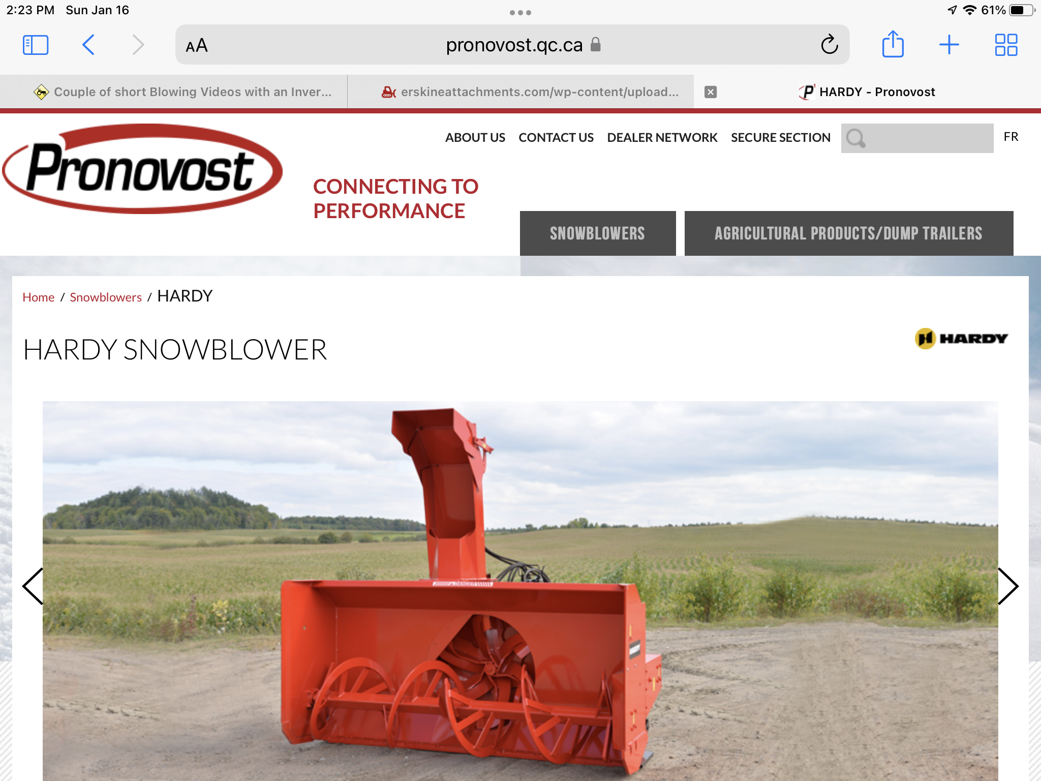

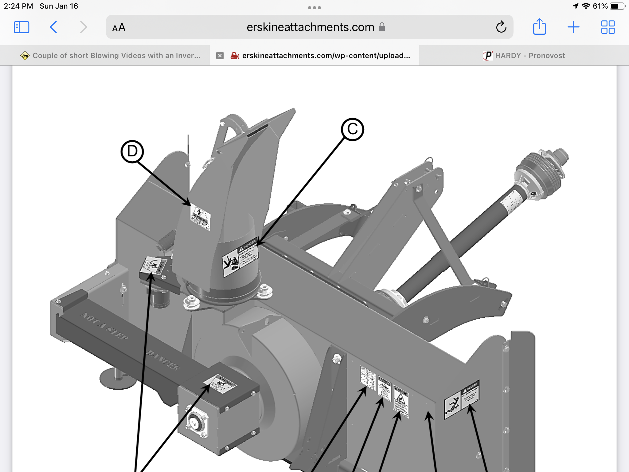

Looks to me as if despite the Erskine's convoluted drive the fan still turns clockwise when viewed from behind the tractor looking forward and the discharge is to the left of the fan. Snow enters the fan from the front rather than the rear.

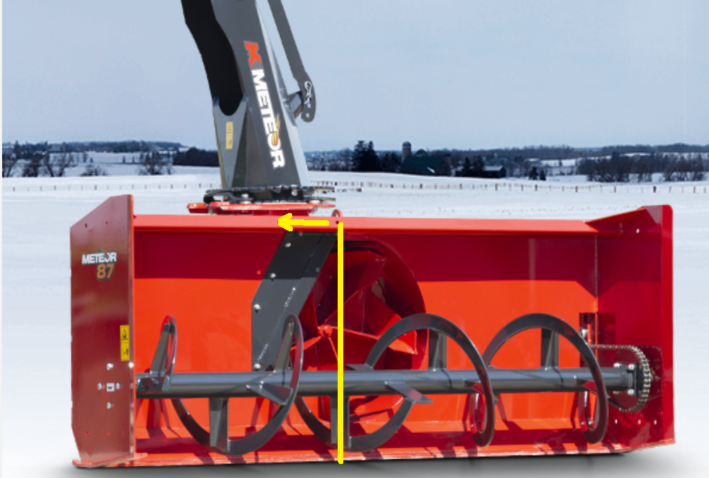

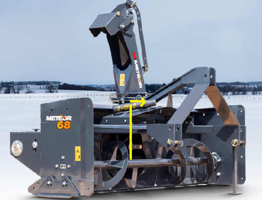

On the Meteor, the fan discharges to the left of center line on push type and to the right of center line on pull type. Different, but not a huge design challenge.
   / Couple of short Blowing Videos with an Inverted Blower #18
Left and right are determined by standing behind the tractor and looking forward. Anyone who has ever sold parts for tractors and equipment has to explain that quite often.
All 4 machines pictured in the two previous posts discharge to the left of the fan.
   / Couple of short Blowing Videos with an Inverted Blower #19
I edited my response to show I was referencing orientation in relation to the center line as you are looking at the business side of the snowblower.
If you tried to convert a push snowblower to a pull snowblower simply by rotating it 180 degrees and somehow connecting the PTO to the blower fan, it would run in the wrong direction, and the discharge chute would now be on the right side of the blower as determined by standing behind the tractor and looking forward. Again, this is not a design challenge for the manufacturer.
