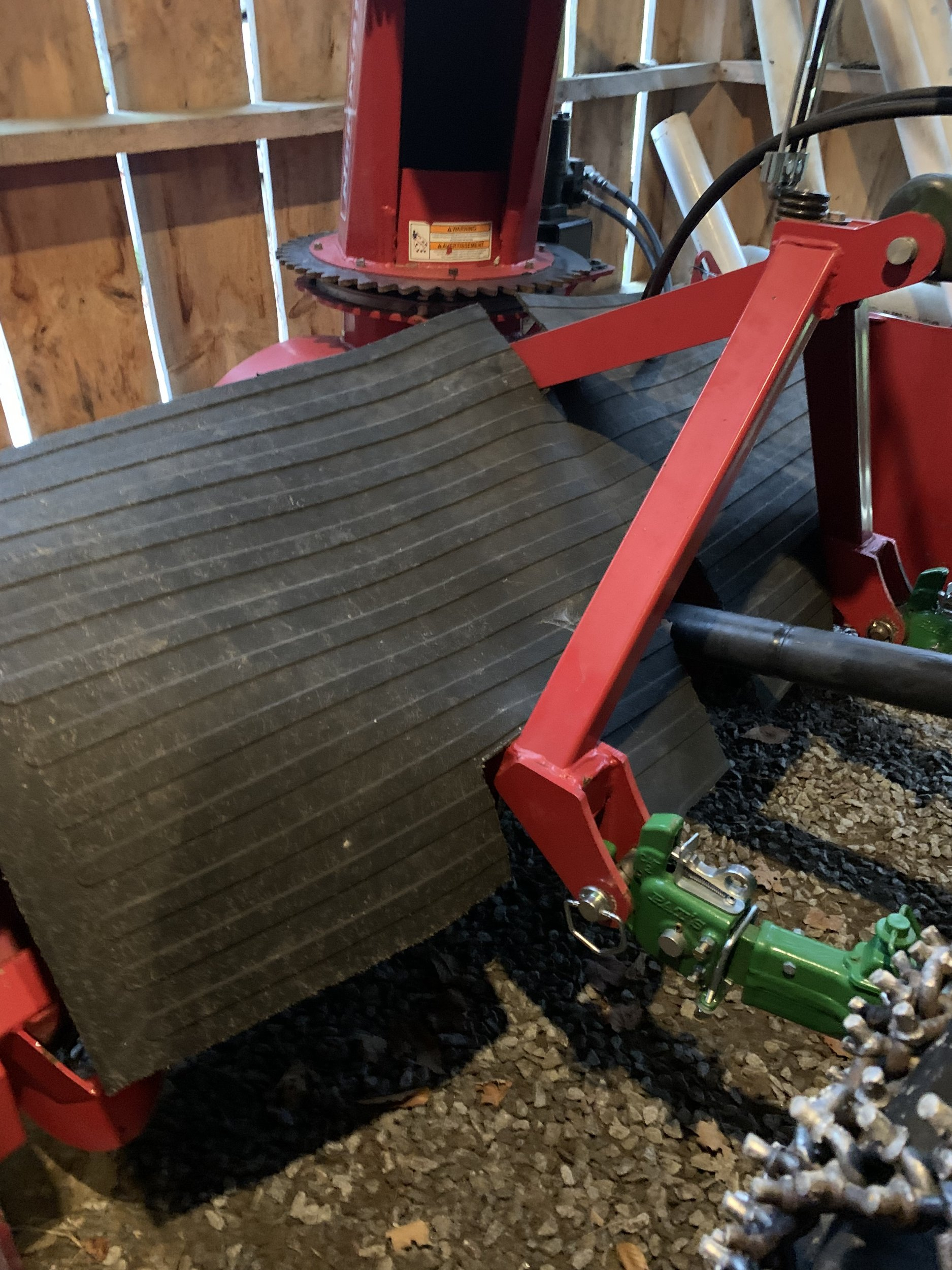

I think there may be a way to quiet down the auger drive.
Before I ordered the WIFO did a bit of research on how the mechanicals are set up and the Erskine is very simple and a strong design, but requires a good greasing session every year.
If the factory was skimping on grease during assembly, it could be making the gear drive quite a bit louder than it needs to be.
Maybe you have already done this but there is a cover over the 90 degree gear box and Just need to remove it to flood the gears with grease.
page 13 shows it.
The WIFO uses a T 27D 55hp 90 degree box, but looks like it is a sealed unit that uses gear lube like a brush hog.
snow blower gearbox 40mm T27D
6 one 1/2 dozen the other.
I did grease the crap out of it. No change. I thought of plugging the holes in the bottom of the box the gears are in and putting cornhead grease in it.
I have a friend who is pretty sharp with gearing and said he thinks the lash is to tight. This fall, we will see if it could be adjusted before he heads south for the winter.

That sounds like a plan on adjusting the gear clearances. Maybe try a little looser and if that doesn't do it a a bit tighter.
I have a posi unit in a Car right now that is noisy but it is definitely to loose.
Have had starters on cars when replaced that were Really noisy until the clearance was increased. The tight ones made an ear splitting high pitched very irritating sound for sure. If that does not work, calling Erskine might have some info/ideas.? I hope the Wifo isn't to loud. My Brushbull Woods bush hog has a pretty noisy 90 degree box in it , so no guaranty it will be quiet on this Wifo.

The dealer did call Erskine with a video I took from the cab with the window open while the blower was in operation. He said they weren't concerned. Smh....This is the first Erskine rear pull the dealer had sold so his experience was 0.
