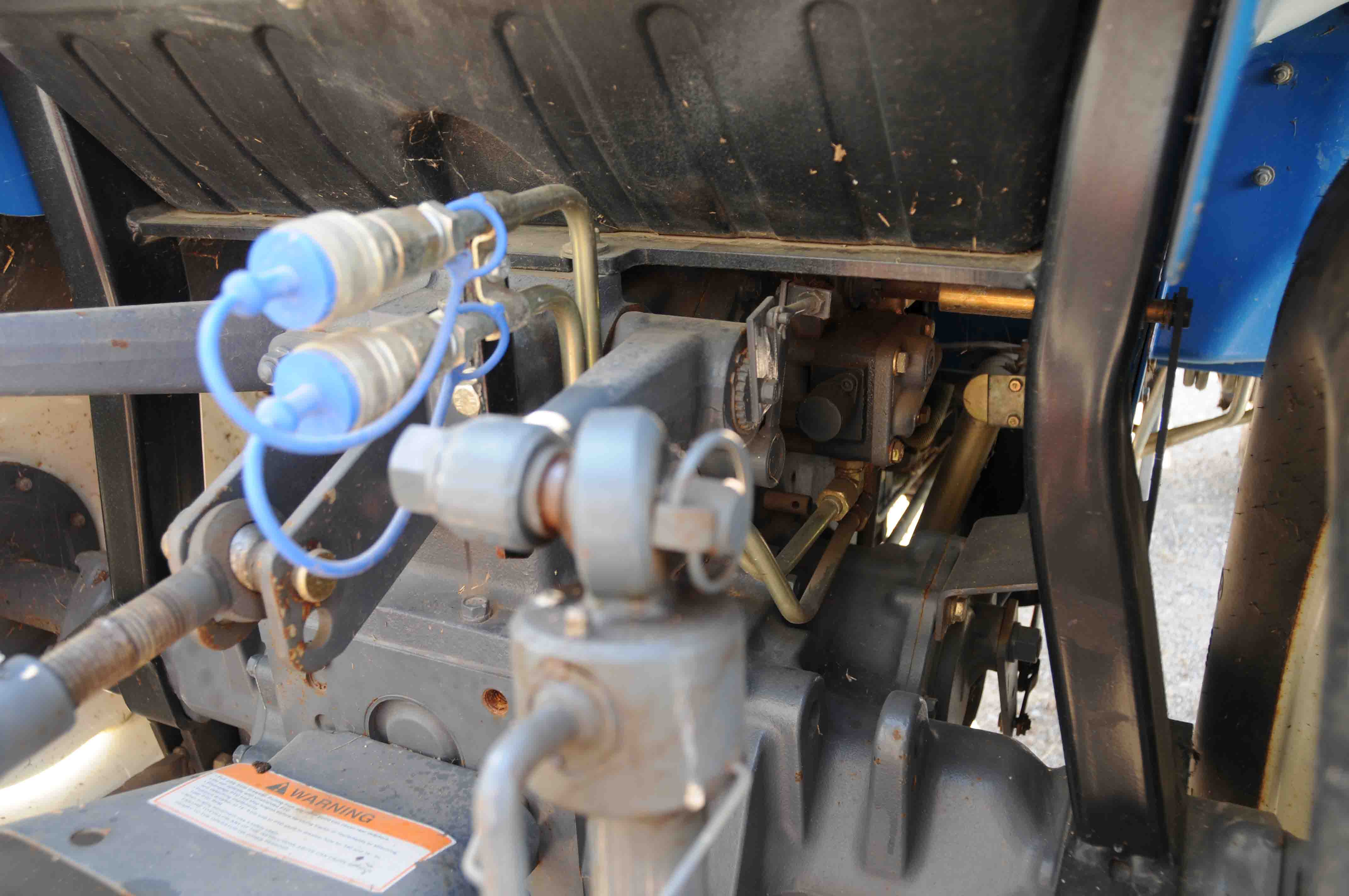

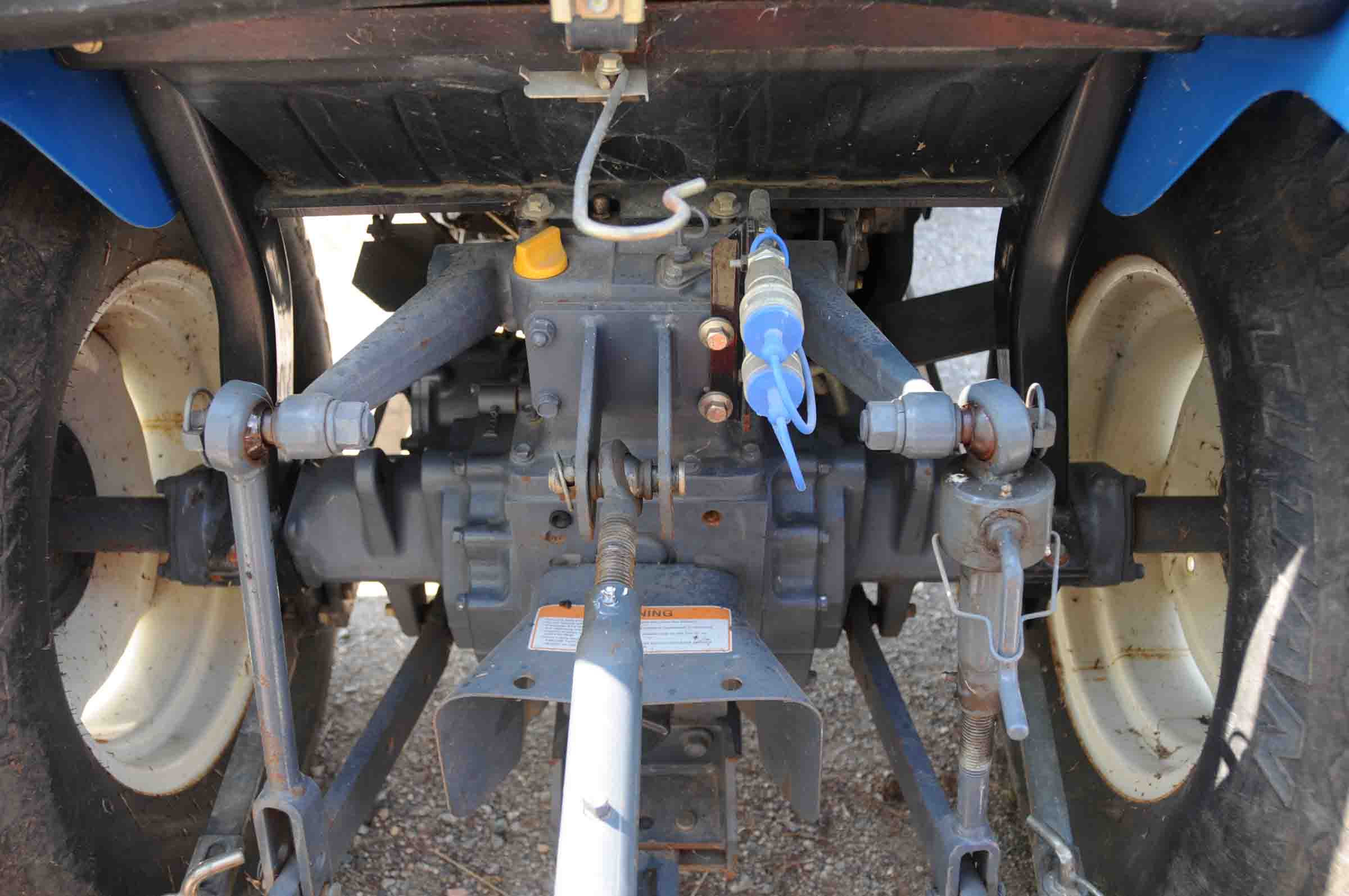

Hi all,
When I purchased my Tractor, I had Dealership install a pair of remotes. The remotes are plumbed to some sort of valve that is controlled by a lever that was added.
From all the threads I have reviewed on this topic, it would seem all I have to do is replace the mechanical top link with a hydraulic cylinder from CCM & then just connect the ports via two hoses to the pair of remotes & I'm done. Is it really that simple since I already have the remotes ?? :eek:

/ Converting Top Link To Hydraulic #2
Vic, yes it is that simple. Measure your existing top link to get your shortest and longest lengths. As long as you are happy with those lengths, then get the closest top link that will match. If you need it to be shorter or longer for some of your implements, then you may need to take that into consideration when purchasing your top link.
Good luck
/ Converting Top Link To Hydraulic #3
Yep, like Brian said, it's really that simple.

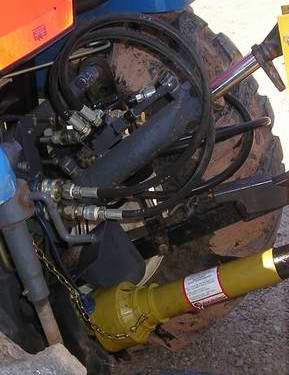

Vic, you will not only need to know the proper length of the toplink, but also the size of hoses and length. Mark at CCM will make hoses for you and include the proper sized adapters to go to your 1/2" QDs (if you order the hose kit--recommended). I would suggest 1/4" hoses at 36" long. That way you can make a stress relief loop and attach the hoses to your HTL. Be sure and run the 3PH up and down to make sure everything clears. Your tractor has a hanger for the toplink when it is not in use. Make sure this hanger will not snag your HTL hoses. I just push mine out of the way to the left. When I disconnect the HTL and don't want it hanging down, I pull the hanger back out and hook the hoses to hold it up out of the way.
Here is a picture of my connections.
Oh yes. . .the other thing you have to decide is which way to attach the hydraulic hoses. Do you want the HTL to extend when you move the remote lever toward the rear of the tractor and retract when you push it forward? Swap your hoses in the remote QDs until you get it working the way you are most comfortable with.

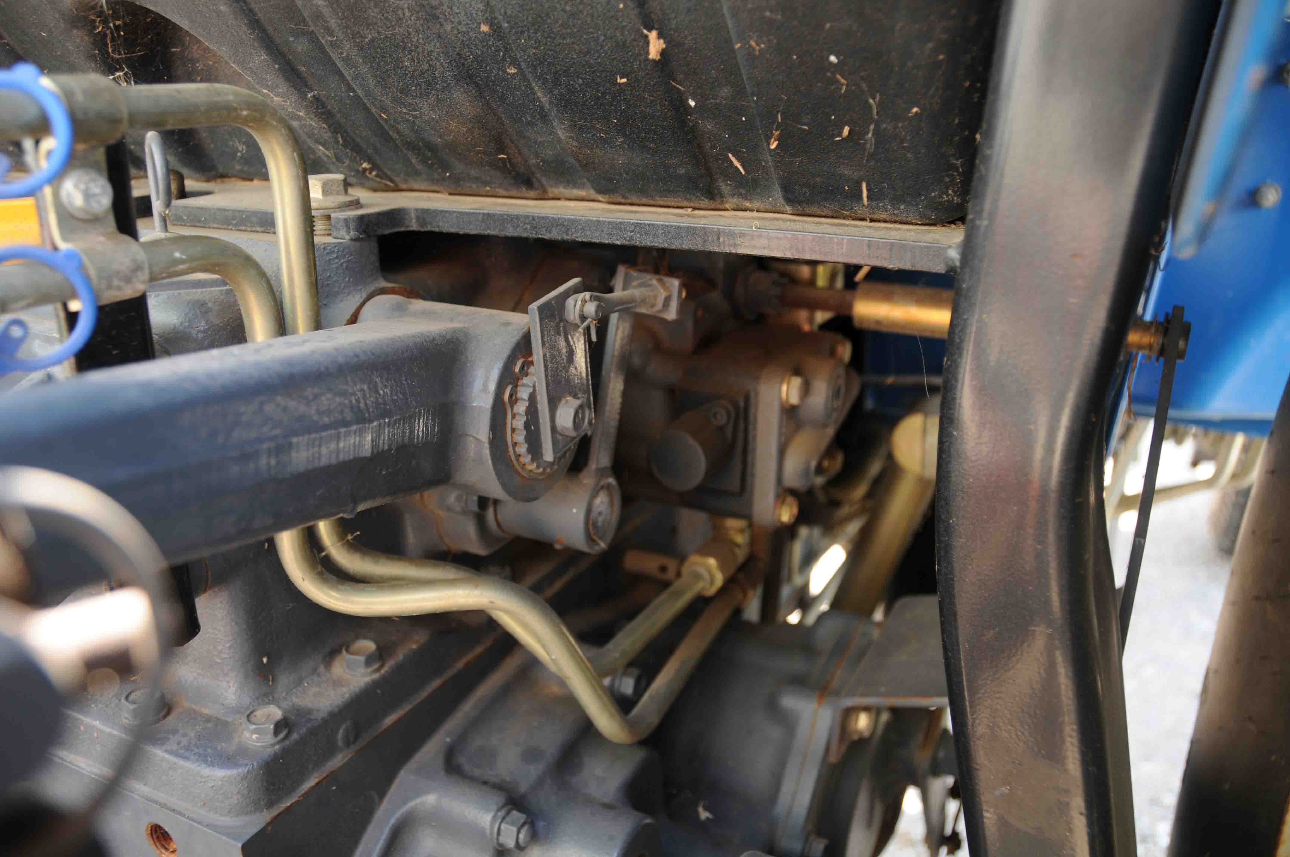

MOST Excellent.....thanks for the great info. I was always wondering what that hanger was for :eek:
Jinman, do you really think I need 36" hoses given the proximity of my remotes to the top link ??
Vic

Vic, if you can find a 1/2" diameter rope, take a 36" piece and make a loop. You need the loop for the hoses minimum bend radius. Place the looped hose in the approximate position of the new toplink and see what you think. I think 36" is the perfect size for the least stress on the hose. Also, I think you will find that you have plenty of room for your hoses to come out the top of the DPOCV. If you put it to the side, it may interfere with additional QDs you could add later. Up is best in my opinion. I'll try to find picture that demonstrates this tomorrow.

I found the photo I was looking for. It shows a much better view of the area around the remotes. Our remotes are located very close to the toplink adapter on the tractor and a side-mounted DPOCV would stick out in the way of the hose attachments on the right side. I suppose you could rotate it to the left side, but I think the arrangement in the photo is fine and assures the hoses are up and away from most obstructions. The rigid hydraulic tubing also makes a good place to loop the HTL hanger to hold it up when not needed.

Instead of using 1/2 hose, why not use 1/4 hose and that will slow down the GPM to the cyl, and if that is not slow enough, there are fittings that have an R in the part number that means restricted. The 1/4 hose and QD's will cost less, and do the same job.
/ Converting Top Link To Hydraulic #19
Jinman, the photo you attached, looks like you have adapters that get connected into the quick attach remotes. How do I determine what size my QA remote connections are. I think you indicated 1/2" in an earlier post. I checked the ID of the outlet port of the remotes & it looks like 7/8". Is that what size the port should be for a 1/2" QA connection ??
Vic, 1/2" is the inside diameter of the connection or the ID inside a hose. When you measured the 1/2" QD, you measured the opening of the female adapter which equals the OD of the male adapter that will be attached to the hose.
JJ: The QD adapters (female) that come on New Hollands remote kit are 1/2" adapters. Therefore, you have to use a 1/2" to 1/4" adapter to get the 1/4" hose connected to the 1/2" QD. We have been suggesting 1/4" hose as you have. It's just that the tractor QD connectors will be 1/2".
Mytc45da: I got my restrictors from my NH dealer. He had them in a self-service parts bins with other hydraulic hose and plumbing components. It was not obvious what they were without knowing what you are looking for. I'd ask my tractor dealer or go to a hydraulic shop in your area. Mine were less than $5 each and have a 0.030" opening. They are especially useful for the HTL, tilt cylinder, and FEL grapple circuit.
