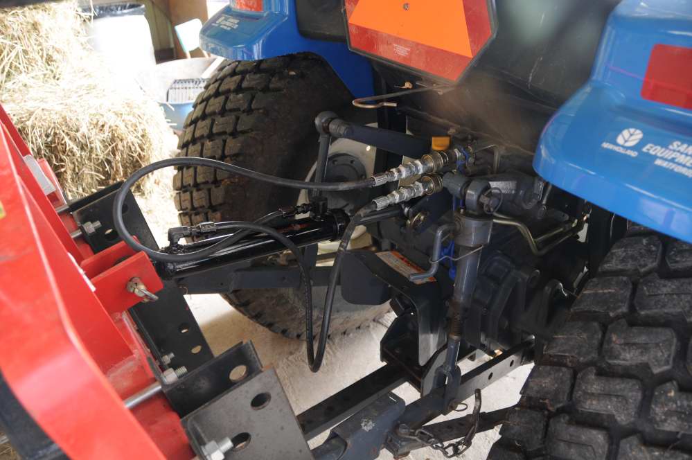

Hi guys, I am considering installing a hydraulic top link on my new JD 2320, and have followed this thread with great interest. I am puzzled ,however, by the fact that two distinct styles of cylinder seem to be used. The cylinders pictured in post #35 by 8404 and post #29 by kozak show the hydraulic lines going directly into the cylinders. On the other hand the cylinder used by jinman in post#12 and the cylinders referred to in post #22 by kennyd show cylinders with DPOCV's.
Are there adfvantages to one or the other system?
Cheers Bob
PS first post....but this is an amazing forum....lots of great advice and helpful suggestions.
Welcome to TBN:D
Cylinder's with the DPOCV's will NOT drift at all whereas the ones without can and due. That is the real difference. A search of the term "dpocv" should turn up more reading...

Bob, as Vic (Kozak) found out, CCM will not ship to Canada. To get a HTL with the DPOCVs, you need to order from Surplus Center. They won't be as helpful as CCM is with getting all your fittings and hoses, but I have been completely satisfied with all my purchases from them and they show international shipping as one of the things they do on their website.
I have had both HTLs without the DPOCV and with it. I will not go back to the one without. To me, it makes that much difference. I don't think it's as critical on the tilt cylinder because the 3PH arms float up and down anyhow and a correctional adjustment once per hour is not much. However, having the HTL stay exactly where you put it just like it was a screw adjustment is a big advantage with grading, plowing, or tilling.
I'm baffled by folks who balk at the added price of the HTL with DPOCVs.:confused: They pay $500 to $1200 for hydraulic remotes and thousands of dollars for quality implements (cutters, blades, tillers) and then have a problem paying $75 more for the cylinder with an DPOCV. To me, it's worth every penny of the extra expense. So are good hoses and quality fittings. I don't think you would ever regret it.
