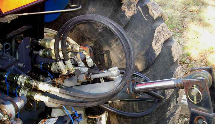

Well, it was a little disconcerting at first but all's well that ends well. Ended up getting the cylinder from Ben Berg Equipment in Wainfleet Ontario. Actually, my hat's off to this Dealership. They came through when things did'nt quite work out the first time. For anybody in Eastern or Central Canada, contact Dave in Service at Ben Berg & he will take good care of you. (1-905-899-3405)
Have worked the cylinder with the forks on the back (approx 400 Lbs) & cylinder moves smoothly. No leaks. Had restrictors put in. (This is a must, otherwise speed is far too quick) Now for the REAL test once it stops raining up here. Still have some heavy landscaping rock to move.
Here's a pic of the final installation. Does not look as good as others I have seen but then most of those had the lock-up valve which then provided connections vertically up & close together in the same orientation which gave a neater appearance. With my set-up, probably would have been better to have slightly smaller hose lengths. But I'm not complaining, better too long than too short & the thing works marvelous.....:D:D:);)

A couple zip ties to hold the hoses together would make it look very clean...
/ Converting Top Link To Hydraulic #31
Vic, you had things stacked against you, but you got 'er done. Good job! Like KennyV says, I would take the outer hose loose at the quick connect and make a complete loop in it and then tie it to the other hose with a zip tie or one of those small bungees. I'm sure you will find something that will make the hoses a little neater. The length of hoses and the small size will make your toplink more rigid.
