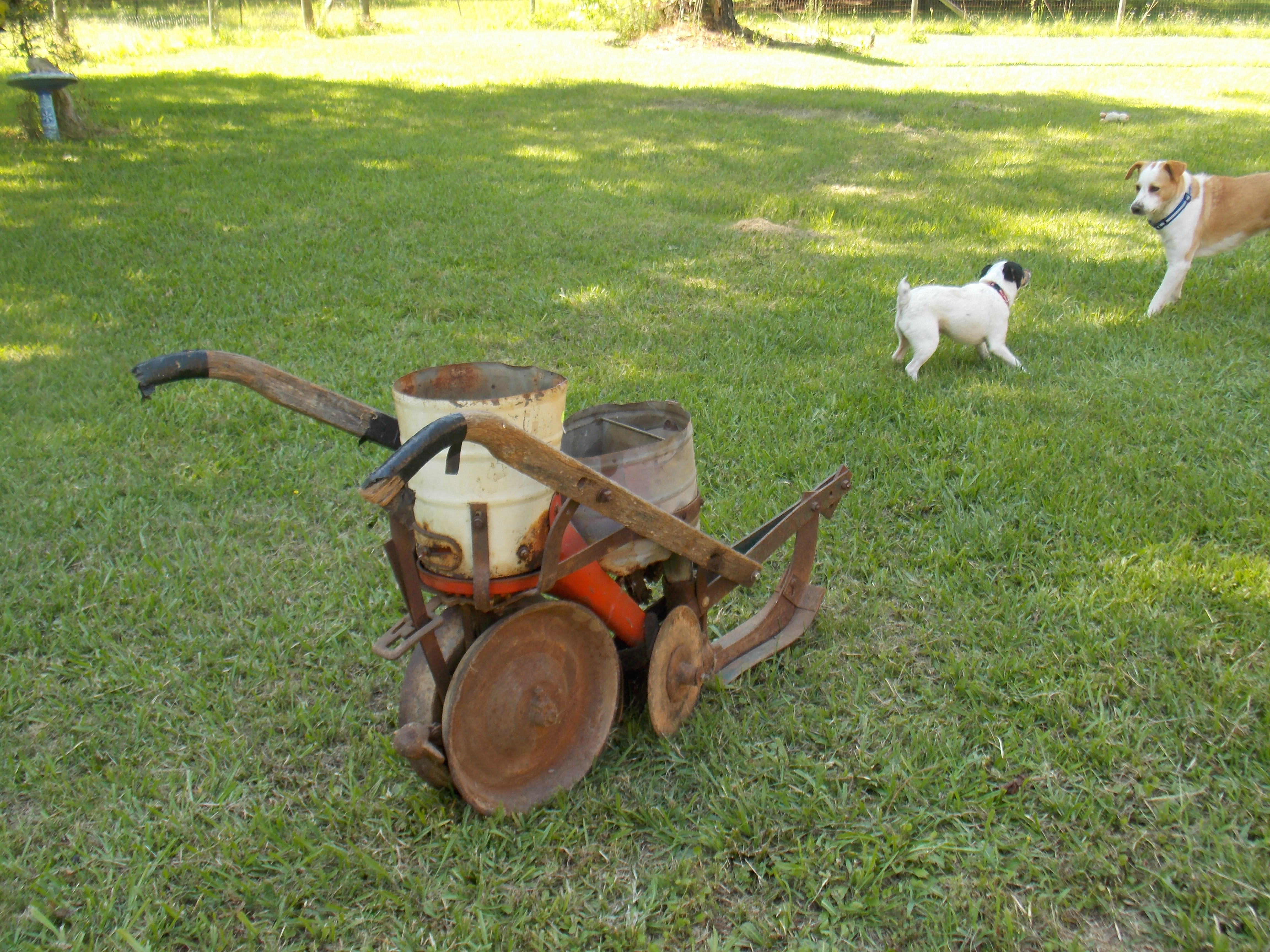

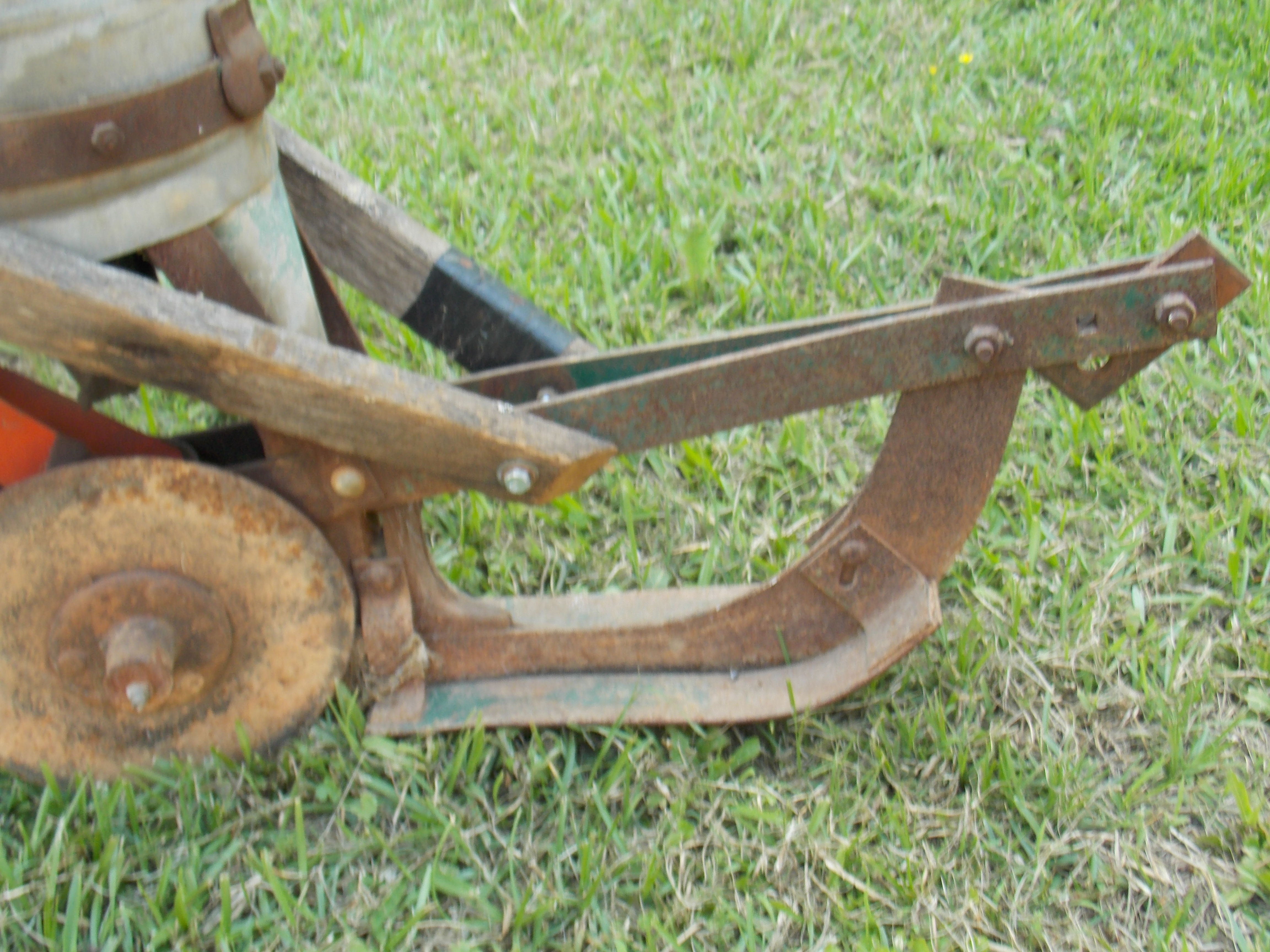

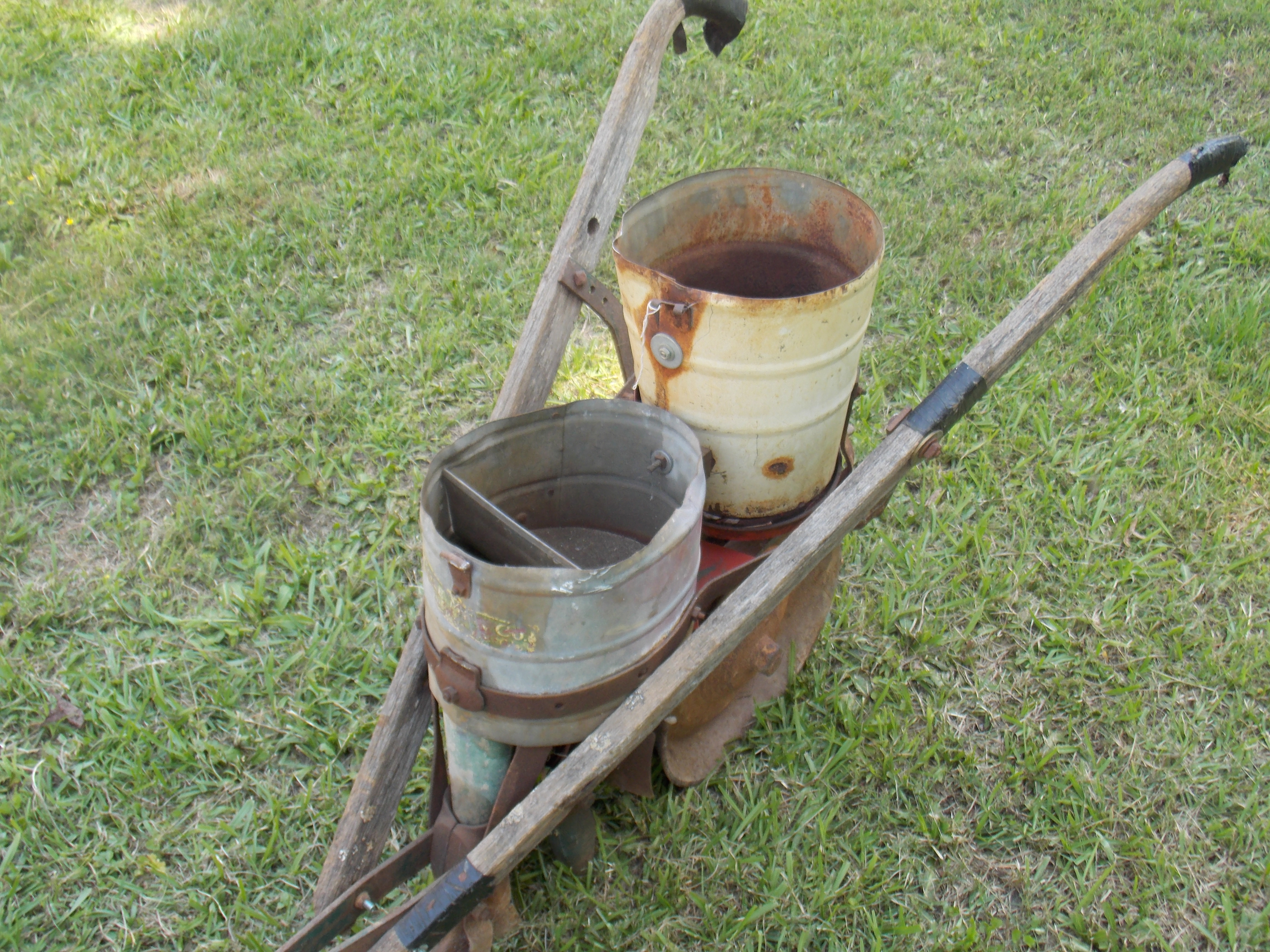

Hello all. I have a mule drawn Cole planter, one row, that I would like to convert to three point hitch. The old planter is in very good condition and has a separate fertilizer hopper as well. I have found a few pictures of such a conversion, but could not actually tell how they were mated up to a cultivator frame. Have any of you ever attempted this? Thanks.....

Okay, I am at a lost. Took some pic's, and she helped me down load them from the camera, but I'm having trouble trying to forward the pictures of the planter to TBN..... Any suggestions? Thanx.... Jb

/ Convert mule drawn to 3 point? #13
I wouldn't change anything on the planter. Don't change history. :)

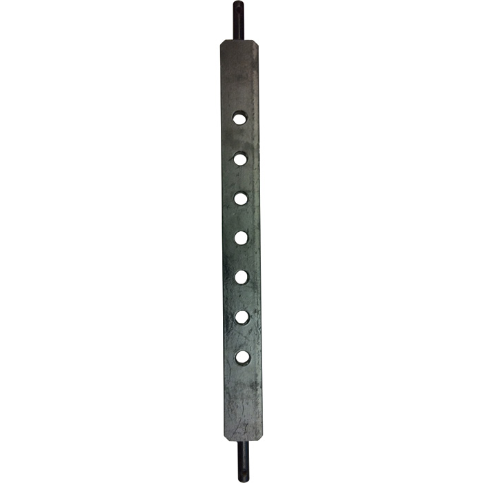

For use on a 3 point, here is what I would do first. If it didn't work, I would make a light 3-point frame that would bolt to the planter.
Bolt one of these under the planter frame about where the front of the handles attach.
Attach the front tow point of the planter to your fixed drawbar with a connection that allows vertical swinging pivot motion so it can lift and pull. Don't use the top link at all.
