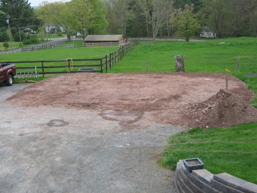

So I had to bring in fill for my 20' x 32' pole building. The fill is approximately 6" in front and 30" along the rear of the building. Do I wait until next spring to pour a floor or do it now? Settling ya know?

I'd wait until next year and sprinkle it really good a number of times to help settle it.
/ Concrete floor now or wait? #4
I too would probabally wait. That doesnt look like good high quality clay like we have here. That looks more like top-soil, light and fluffy if ya know what I mean. I'd let it settle real good. When I did my fill, It was all good clay, and driving over it several times while continuing to add, it was pleanty compacted to concrete right away. But with what you have, play it safe and wait. concrete is expensive
/ Concrete floor now or wait? #6
Last year I had to build up one corner of my garage about that much. I compacted it well and used crusher run with the fines. For the last 4 inches I went with washed stone so any water under the slab could drain out easily. I had no problems. If you don't think your fill is compacted as much as it should be I would wait. I would also try and get grass growing on the sides so it doesn't wash away.
/ Concrete floor now or wait? #7
Definitely wait. My neighbor widened part of his driveway near a ditch prior to paving, without compacting it. That part of the driveway is now cracked and crumbling due to settling.

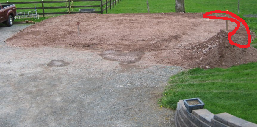

i would say "wait"

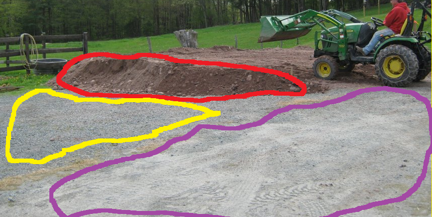

when looking at tractor, to me, it looks like a smaller size SCUT or CUT. and to me without a full heaping bucket of dirt in the FEL. and using front tires. i am going to guess you did not do much compaction. exception maybe first couple inches of dirt on top. and even with full bucket of dirt and using front tires to compact. you may of only compacted just a little bit more.
also when looking at pictures ((see edited pictures)) you only compacted from one direction. looks like loose gravel in one picture, while rest of the gravel were you been driving has been compacted pretty good.
also you have loose un compacted dirt sides. and you only compacted in one direction. vs running tractor clear across and down each side. and then coming back over and going in a perpendicular direction. which leads me to believe, you do not have a lot of compaction going on beyond first couple inches.
it is fairly easy to create a "hard pan" first couple inches of dirt. and all the dirt below it to be not very well compacted at all. which can lead to good amount of settling and possibly a good amount of frost heave till things settle a fair amount.
with your original question wait till next spring to put in a concrete floor.

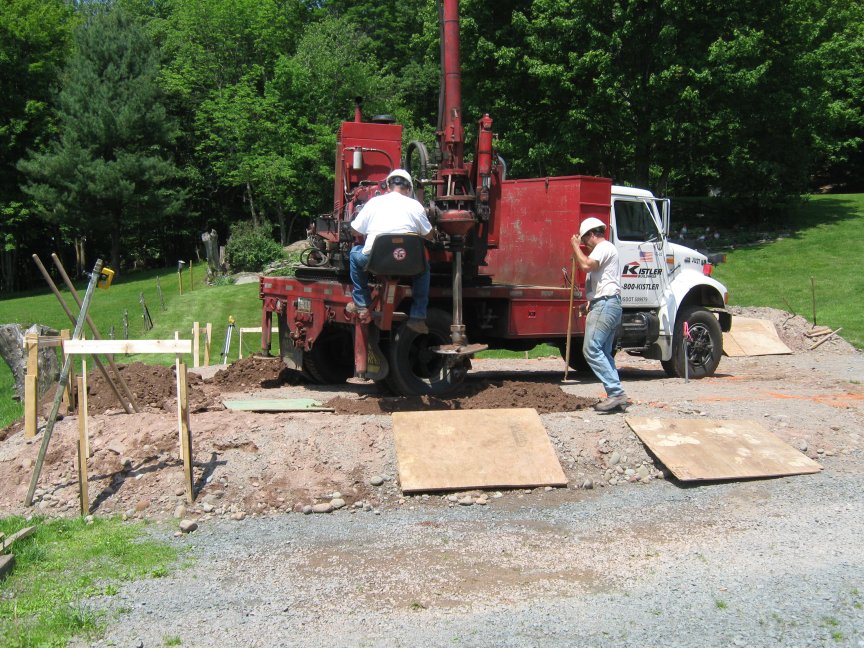

Neither one of these trucks hardly left any marks so I don't really believe all that is necessary. The outriggers on the drill truck were just fine also. The fill was packed fairly well when putting it down. The 12 Yard dump truck was on the pad a lot also, with a load on as planned. The sides of the pad not so much but the pad was made considerably bigger for that reason. However the plan was/is to use a plate compactor, the guy who delivered the fill has one I can use any time I want, and I have before.
I'm still going to wait until spring. So many people on this forum, they can't all be wrong. Thanks again to all.
