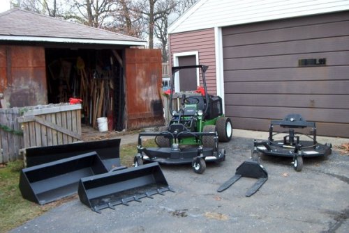

Mossroad - I figured you would like it. It is very similar to a PowerTrac just a little larger framed! I can't wait to get a few more toys for her to play with!

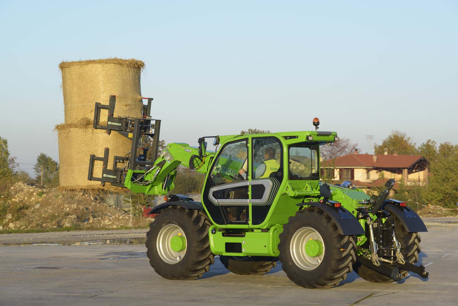

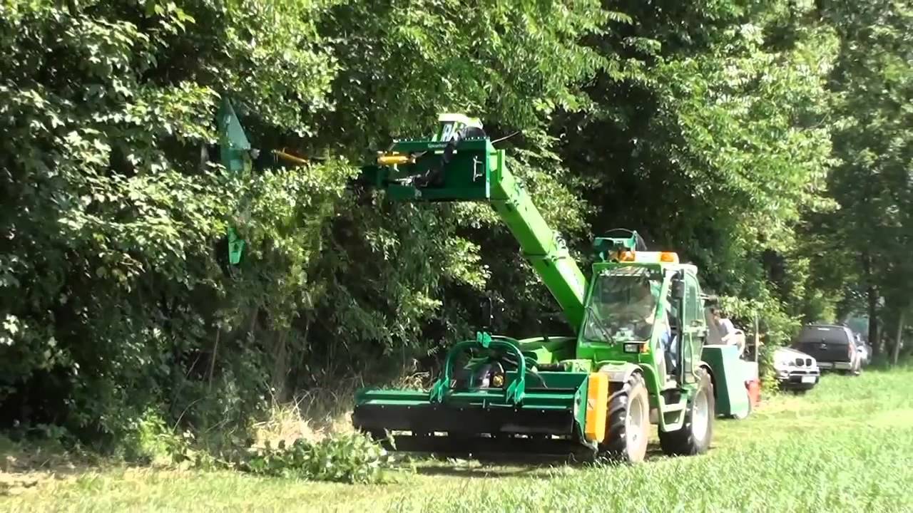

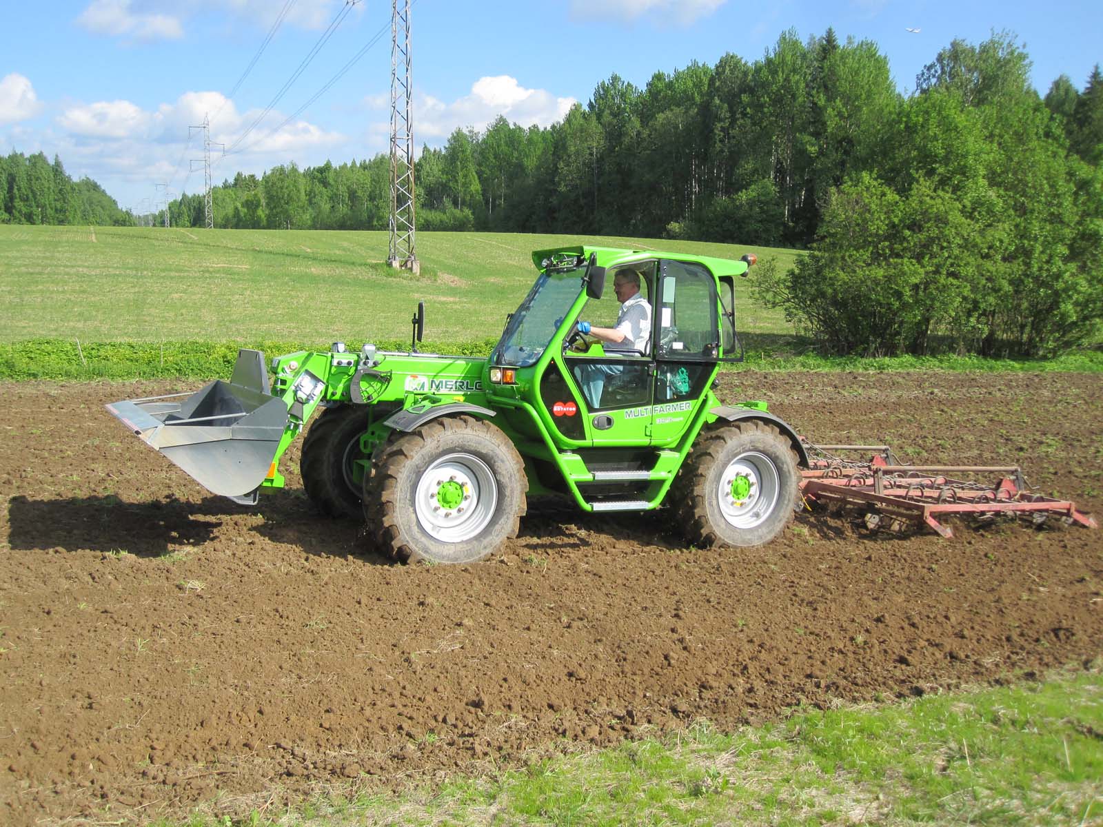

Interesting read. Have you ever looked at the Merlo Multifarmer? Addresses a lot of the problems while still offering the option of pulling with a 3 point & PTO if you want to.

As you guessed, I have no need for a 3pt hitch. Been there, done that, not going back in the foreseeable future. :laughing:
Now if I had to plow a field often, or had large acreage to mow, I might consider 3pt. But for the most part, I can accomplish all my tasks with implements mounted up front.

Kind of reminds me of the Unisystem - you always have to reconfigure it for what you want to do. Plus these are big - not a compact or lightweight, i.e. on your lawn type of machine.
True, even the lower end is 110hp - solidly into utility tractor range. Interestingly, they make a 74 hp machine about 6 ft wide, but it isn't available with a 3pt hitch. I think that size machine would be very useful.
Very very cool concept! I love the idea of something like a telehandler, but none of them that I knew of are available with a 3 point hitch and PTO.
Although the 3 point hitch is outdated technology and a pain in the rear at times, many of us have numerous 3 point implements already and it would be too costly to switch to all hydraulic.

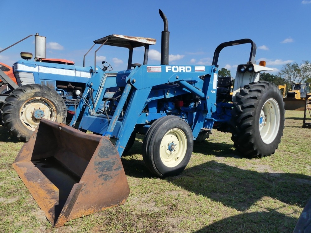

I haven’t read the whole thread and only the first post. The 3 point hitch doesn’t suck that bad. Especially the more operator friendly versions. I don’t see it going away any time soon due to the amount of already existing implements. Hydraulics drive attachment are expensive. Forward facing mowers are better unless it’s a big one. 15 foot bat wings aren’t a very good candidate to be pushed. Tractor loaders are definitely on the wrong end. And if you haven’t figured it out Americans like doing a lot of things like grandpa. Even if it’s wrong or not the most efficient way. Foreign equipment is much more intuitive than ours.
/ Compact Tractors are Designed All Wrong #139
Tractor loaders are definitely on the wrong end? What is your reasoning for that? I can not imagine wanting it on the back even if I had a swivel seat.
