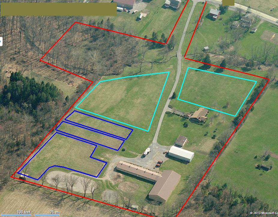

Hello everyone, my first post here.
I'm shopping for a tractor / equipment to handle a 15 acre horse property. I have attached an aerial of the plot with the areas currently pasture fenced (blue) and future pastures (light blue). I expect to do these chores with the following order of time spent:
1) Mowing perimeters and yards (weekly), 5 acres total.
2) Mowing pastures (monthly), 5 acres total.
3) Dragging indoor and outdoor riding areas.
4) Moving manure.
5) Moving hay bales and other consumables from storage building to barn.
6) Plowing driveway in winter. We get some winter weather here in PA but most years the largest snowstorm leaves less than a foot. Snow is wet and heavy as often as it is powdery.
7) Spraying the pastures, aerating, and fertilizing activities maybe.
(Fence posts will be driven professionally, excavations will be subbed, and I have no intent to harvest wood in the wooded section)
This is where you come in. I have no experience with this stuff except for a couple of times dragging a riding arena using someone else's rig. I'm a mechanical engineer so while I pick up this stuff quickly, I don't know things I've never been exposed to. If things go well I'll need a tractor by mid-May so I'm using the meantime to do my homework. My current lawn equipment boils down to a small push mower and a light duty weed-eater, ha. I foresee buying at least a 20hp 4WD compact tractor with quick attach loader.
Major questions:
1) Would you try and mow this property using a tractor implement, or a commercial (zero-turn style) mower? Two clarifications here: the existing turf is not very bumpy and I'm willing to aerate and roll it annually to maintain that, and I believe in keeping pasture grass no higher than 6-7" and mowing down to 4-5". So the question is whether I should consider a separate mower.
2) What kind of tires make the most sense if the ground is generally smooth, no rocks, and areas of the turf can be wet at times?
3) If we wanted to buy and handle large square hay bales, how would I decide if a tractor that is safe to move and stack them? Large squares run 800lb on average, and for horse feeding I really don't expect to buy oversized and heavy bales.
4) Following question 3, if I get a bale spear for the FEL, is the 500mm/full height lift capacity (say, 1100# for a Boomer 30) something that won't tip over the tractor?
Looking forward to your thoughts.

I would look at a Deere 3032E for your list of jobs and other brands with a similar size. I would suggest you look at a rear finish mower about 6' wide, a similar sized arena rake and a rearblade.

I don't own a zero-turn, so take this with a grain of salt, but I have read many other similar threads here on TBN, and my impression is that, if you're going to do 5 acres of mowing a week, and another 5 acres once a month, you should consider a zero-turn. A zero turn is capable of delivering a quality cut at a much faster ground speed than a mower on a tractor. If you do the math, I think you'll find that you need a pretty big finish mower on a tractor to make up the difference in mowing speed with a zero-turn. Also, if you have perimeters to mow, a zero turn's additional maneuverability is going to make a big difference. If you had un-cleared pasture that might require a bush-hog, or if you said the ground was pretty rough and had lots of rocks and ditches or whatever, then I might say the tractor is the right choice, but for what you've got, I think you should be looking at a dedicated mower.
However, if you're willing to put in the seat-time, you can come out ahead money-wise by using a rear finish mower on your tractor. An RFM will come in around $1-2k, and will rely on your tractor's engine to run it. You'll have a hard time finding a zero-turn that will be as reliable and long-lived as your tractor, for $1-2k. But do the math! At 3 mph, you can do about 1.6 acres per hour with a 5' mower. So that's about 3-4 hours of mowing you're going to be doing--a week! Even a 6' mower only gets you down to 2.5-3 hours. On the other hand, according to the Internet, a zero-turn will do closer to 3-5 acres an hour, depending on field conditions. That's a big difference.
/ Compact Tractor shopping - some questions #8
A zero turn will be $4k minimum more than a finish mower. Now you will have 2 machines to maintain instead of one. You are going to have to have some smooth ground to make the time the zero manufacturers claim.
/ Compact Tractor shopping - some questions #9
As for tire type, if I was mowing as much as you, I would lean towards a turf tire. I have R4's, and when the ground is wet, they will tear it up very easily. Not as bad as an ag tire, which will leave track marks everywhere, but still bad enough that I wouldn't want to be committed to running them all over my place all summer when it needs to be mowed. R4's are going to be better than turf for loader use, but it sounds like your mowing is more your primary application than loader use.

5 acres of yard, 5 acres of pasture. Pastures are not rough and we plan to build some sacrifice areas so they don't destroy the turf when it's fragile.
If I were to do the mowing with the tractor I'd expect to have a quick attach loader and mow without it.
Before we get into the question of what tractor will handle an 800lb square bale, are you saying that the lift rating at full height is not the limiting factor? If that's the case, what is the limiting factor?
As for the 40+ hp tractor and ZTR option, that's not a financial possibility. My budget is 20k, 25k tops, and I was not really expecting to buy new.

Good advice given so far. If it were me I would be looking at loader lift capacity to meet your hay needs as I was comparing tractors. Given how far out an 800 lbs bail will sit a loader in the 1200 lbs lift range might work. If you ever think you might go to round bales you would need more. You are out of the 20 hp tractor range though. The other thing I would consider is how much mower I wanted to run. The general rule for a rough cut mowers is 5 PTO hp per foot of mower. A finish mower generally requires a bit less. A 20hp tractor will generally have around 16 PTO hp and is going to work best with a 4' mower. Five acres is a lot of mowing time with a 4' mower.
I would be looking in the 35 to 40 gross hp range.

I think you will be much happier if you get a compact tractor to handle the large jobs and get a good commercial zero turn mower to do the mowing. You can do it all with the compact tractor if you have alot of extra time, but if you want to spend that time on things other than mowing and if the budget allows, get the ZT mower. Look at tractor dealers in your area to find one that fits your needs and for a zero turn, Grasshopper, Gravely, Country Clipper are all very good mowers.Let us know what you end up with.

I have no reservations about maintaining two machines, especially if it's the best solution. I don't automatically buy the idea that a 2-ton tractor is the ideal machine for spending most of my time mowing.
I mentioned the ZTR to manage the trees, fence edges, and buildings with less clumsiness than the tractor. Plus I get to skip rearranging the attachments for mowing. It's not about achieving the manufacturer's maximum ground speed. So that's my uneducated comparison of tractor mower vs. ZTR.
I wasn't entirely clear in my first post - I would like to handle large square bales but it won't make sense if it adds $10k to the equipment investment. $10k buys a lot of small bales, or at least buys me a year to consider adding a skidsteer instead. This is why I was trying to understand the requirements for lifting.

Dave, first of all, that's a beautiful place you have. It looks like someone has already put a lot of time and effort into it. It's laid out nicely from what shows on the aerial view. Seems to me you have two major functions to handle: a) upkeep of the property and b) your horse operation.
The upkeep tasks, mowing, driveways, general chores, can be done by any good quality compact tractor. The bigger your equipment, the faster that work can be done, so it's a money vs. time judgement only you can make. And, there's a good case for having a separate mowing unit, particularly since you have so much fenceline, driveways, buildings and landscape that will require trim mowing.
The horse operation is another matter. That horse barn has how many stalls? It looks huge, and if you're eventually going to have the herd to keep it full (what, maybe 20-25 horses?), you'll be dealing with some serious input/output issues (i.e. hay and grain in; manure out). I could easily see a respectable ag utility tractor for bales and a skid steer for manure looking right at home on a place like that. So if all goes well, that may be where you could someday end up, equipment-wise.
But, presuming you're in the "start-up" phase at the moment, it seems you'd at least need one good multi-tasking tractor to get the ball rolling. My vote would be for something big enough to do some serious work, probably something in the 35-40 hp range, or more. The Kubota Grand L's are top-notch, the Deere 4000 series likewise and there are other excellent models from Kioti, Massey Ferguson and others, so you have quite a selection.
I think if you go smaller than that, you would be OK for a while, but you'd be back in the market again for bigger equipment as your horse operation grows and matures.
