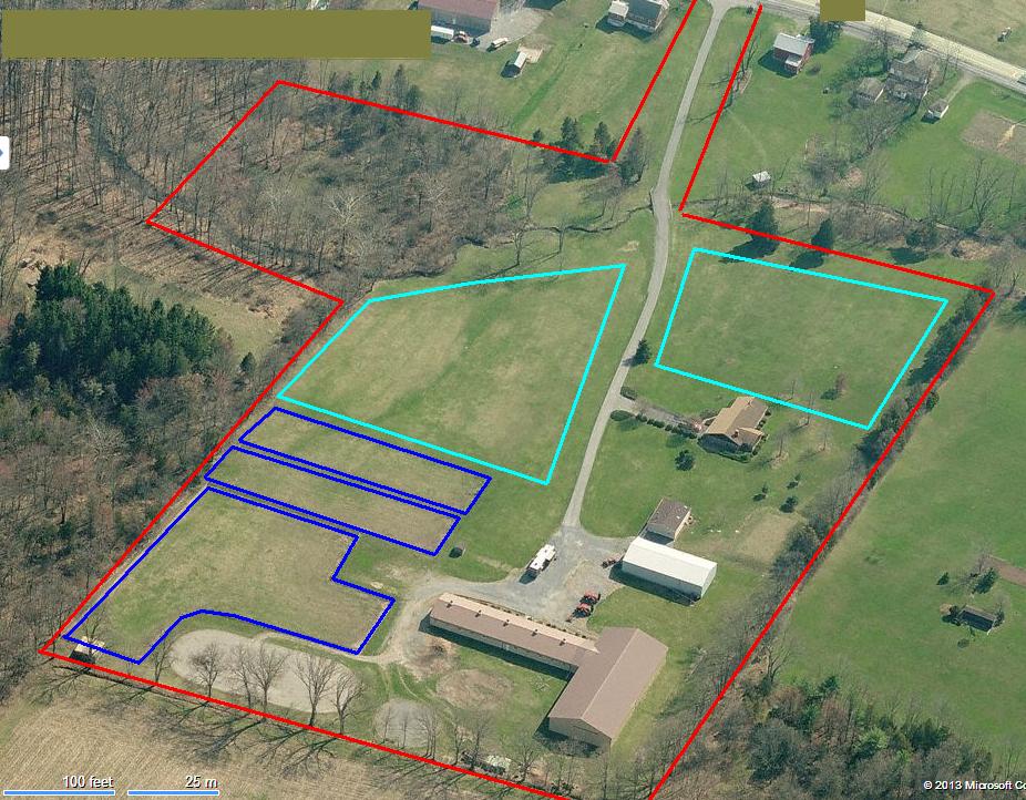

5 acres of yard, 5 acres of pasture. Pastures are not rough and we plan to build some sacrifice areas so they don't destroy the turf when it's fragile.
If I were to do the mowing with the tractor I'd expect to have a quick attach loader and mow without it.
Before we get into the question of what tractor will handle an 800lb square bale, are you saying that the lift rating at full height is not the limiting factor? If that's the case, what is the limiting factor?
As for the 40+ hp tractor and ZTR option, that's not a financial possibility. My budget is 20k, 25k tops, and I was not really expecting to buy new.

Good advice given so far. If it were me I would be looking at loader lift capacity to meet your hay needs as I was comparing tractors. Given how far out an 800 lbs bail will sit a loader in the 1200 lbs lift range might work. If you ever think you might go to round bales you would need more. You are out of the 20 hp tractor range though. The other thing I would consider is how much mower I wanted to run. The general rule for a rough cut mowers is 5 PTO hp per foot of mower. A finish mower generally requires a bit less. A 20hp tractor will generally have around 16 PTO hp and is going to work best with a 4' mower. Five acres is a lot of mowing time with a 4' mower.
I would be looking in the 35 to 40 gross hp range.

It is very hard to have one machine to:mow five acres of finish ground,mow another five of rough ground,lift 800lbs and do some snow removal.It can be done but you will have to compromise somewhere.It doesn't look like you have a lot of trees to mow around.My suggestion;L4240 Kubota with FEL,4WD,turf tires ,rear finish mower and bush-hog.Rear scraper blade should handle your snow removal duties.And yes I do own a L4240(600 hrs) and it has been a very good machine.DK40 Kioti,JD 4XXXmachines will have similar capabilities.

I have no reservations about maintaining two machines, especially if it's the best solution. I don't automatically buy the idea that a 2-ton tractor is the ideal machine for spending most of my time mowing.
I mentioned the ZTR to manage the trees, fence edges, and buildings with less clumsiness than the tractor. Plus I get to skip rearranging the attachments for mowing. It's not about achieving the manufacturer's maximum ground speed. So that's my uneducated comparison of tractor mower vs. ZTR.
I wasn't entirely clear in my first post - I would like to handle large square bales but it won't make sense if it adds $10k to the equipment investment. $10k buys a lot of small bales, or at least buys me a year to consider adding a skidsteer instead. This is why I was trying to understand the requirements for lifting.

Dave, first of all, that's a beautiful place you have. It looks like someone has already put a lot of time and effort into it. It's laid out nicely from what shows on the aerial view. Seems to me you have two major functions to handle: a) upkeep of the property and b) your horse operation.
The upkeep tasks, mowing, driveways, general chores, can be done by any good quality compact tractor. The bigger your equipment, the faster that work can be done, so it's a money vs. time judgement only you can make. And, there's a good case for having a separate mowing unit, particularly since you have so much fenceline, driveways, buildings and landscape that will require trim mowing.
The horse operation is another matter. That horse barn has how many stalls? It looks huge, and if you're eventually going to have the herd to keep it full (what, maybe 20-25 horses?), you'll be dealing with some serious input/output issues (i.e. hay and grain in; manure out). I could easily see a respectable ag utility tractor for bales and a skid steer for manure looking right at home on a place like that. So if all goes well, that may be where you could someday end up, equipment-wise.
But, presuming you're in the "start-up" phase at the moment, it seems you'd at least need one good multi-tasking tractor to get the ball rolling. My vote would be for something big enough to do some serious work, probably something in the 35-40 hp range, or more. The Kubota Grand L's are top-notch, the Deere 4000 series likewise and there are other excellent models from Kioti, Massey Ferguson and others, so you have quite a selection.
I think if you go smaller than that, you would be OK for a while, but you'd be back in the market again for bigger equipment as your horse operation grows and matures.
