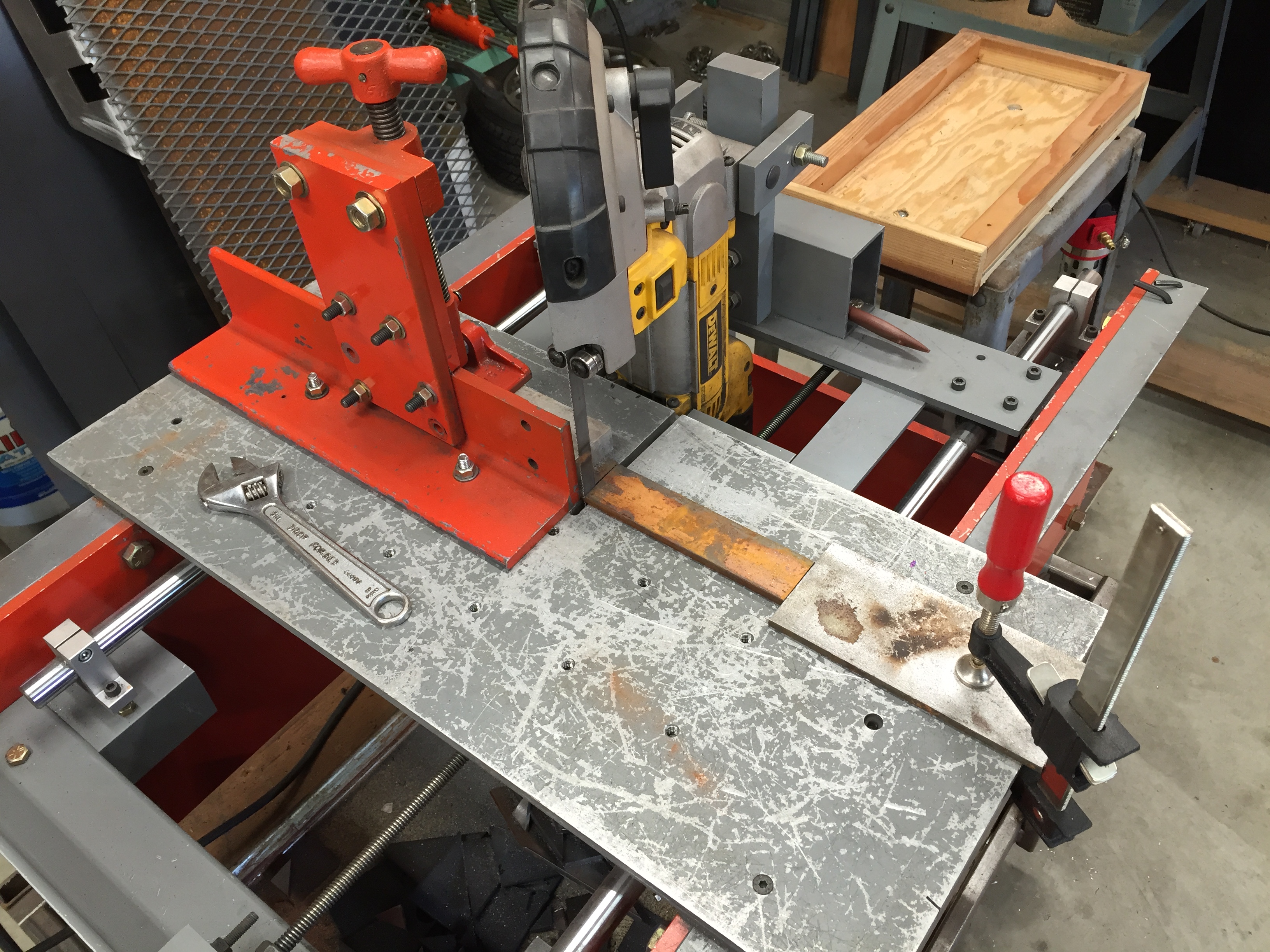

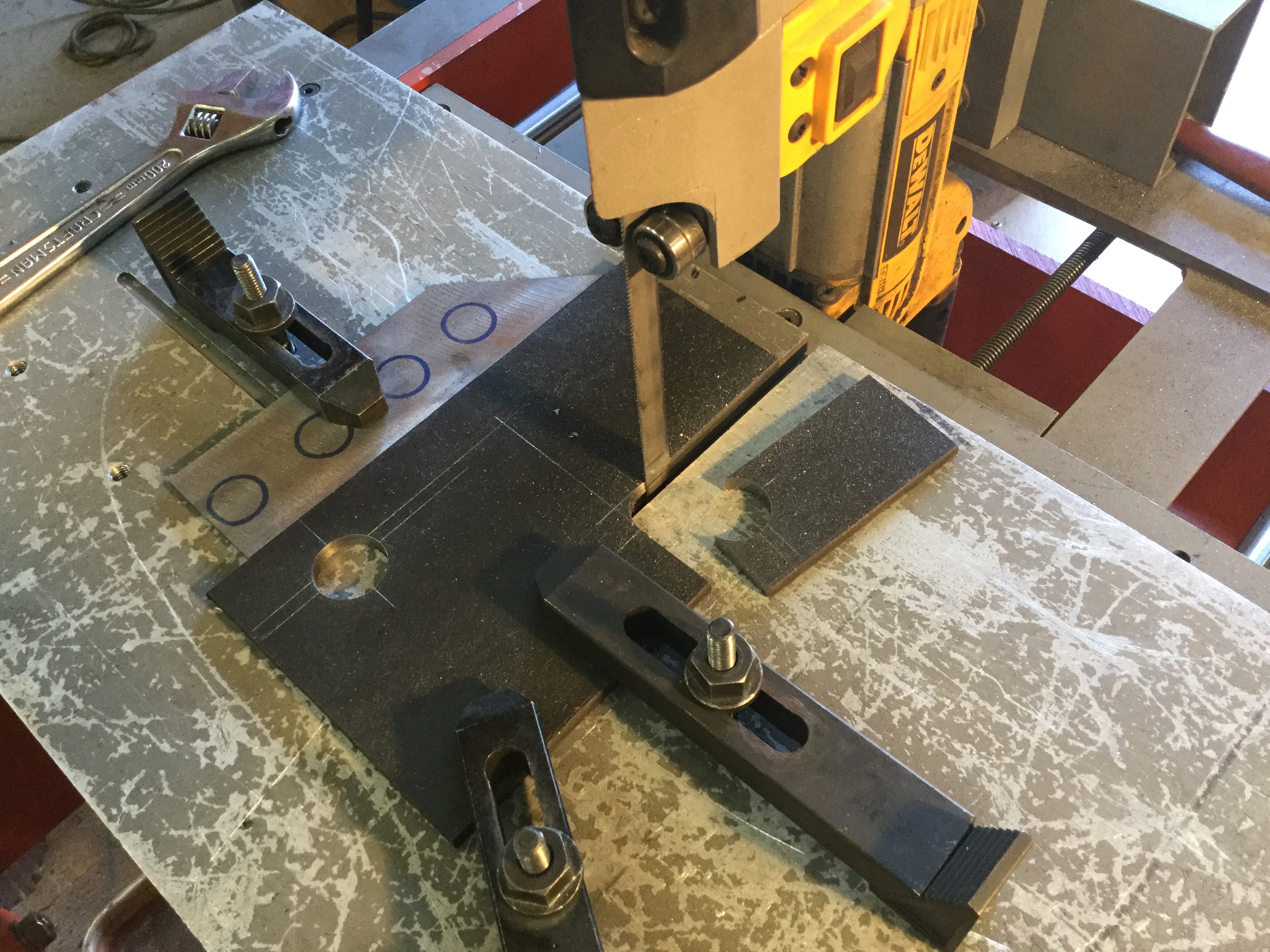

For handirifle, here are a couple hold down options to consider. I use both on my home made vertical bandsaw. The vertical clamp works best on repetitive cuts in long material. The milling machine style hold-downs work best on odd size and angled pieces. Both work fine.

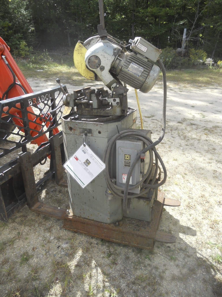

I dug my saw out of the snow and pulled the motor yesterday, the flash makes a pic of the nameplate a big white flash so I copied the info. There is also a worm gear & housing that looks very integral to this motor. Like I said, I don't know much about motors but I'm guessing that I won't be able to replace it with another motor, and rewinding might be the only way out. (575v motor).
Sorry for the slight hijack, but I've got a few folks helping me on my true "cold saw" thru PM's and I can't get a pic to work there.
You can see the highly advanced material clamping on this saw, the guy's I've talked to tell me that there is no comparison to either an abrasive saw or the "other" high speed dry saw (3000 ish rpm) This saw operates at 30 & 60 rpm and the blade is tool steel. They tell me it is very accurate on angles, as you can see, the motor (saw) turns for angles rather than the material.

I'd bet that the nose-piece with the worm gear comes off just ahead of the cooling fins, and the motor shaft is keyed into it like a direct drive pressure washer. You're correct on the accuracy of the table, when you get her running you will love it.
Yep, remove the worm gear, unbolt the 4 bolts under it, remove the bolts into the fins and see if it will come off.
Too bad it doesn't have the frame size on the tag.

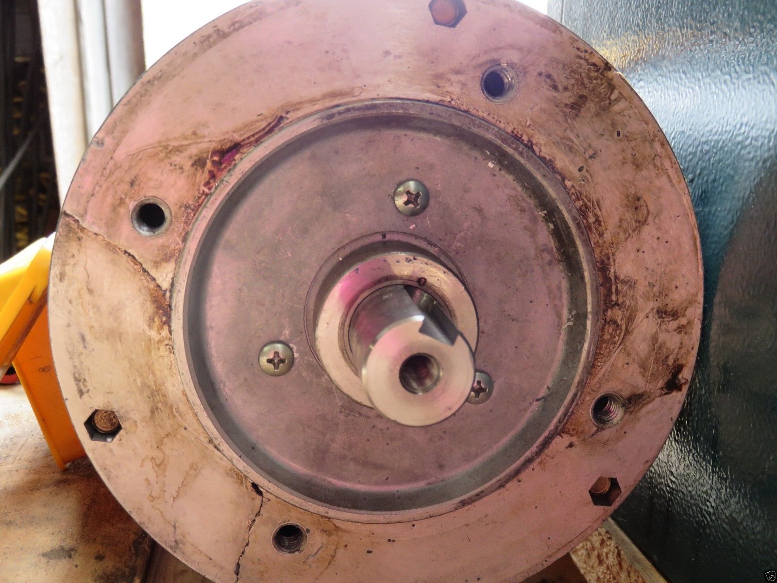

I was having a nose-about on ebay and ran across a damaged take-off motor from a Brobo cold saw, which is quite similar to yours. Here's the shaft end.
Brobo.jpg Listing

I seriously doubt there is a simple bolt on solution or everyone would be buying cheap J head mills and lathes and repowering them for residential use. What you might be able to do, assuming that the worm gear end is a keyed slip fit over a round shaft, is to find a 56C frame motor with a longer shaft of the proper diameter, make an adaptor plate that has holes to mount to the motor and studs to mount it to the saw. Cut the excess shaft off to allow for the extra adaptor plate thickness and mate them up. Normally that would require a lot of precision measuring and such, but I would cheat and make the plate blank, with a hole for the shaft and the holes to mount to the motor, those would be an easy layout. Then cut the shaft, and match up the two pieces and transfer punch where the studs need to go. That will assure that the motor lines up to the driven gear. Doing that will probably eliminate the dual speed option.
Just took a look at Surplus Center; see if you can find a frame type on the motor, they have a 182TC 3ph motor that looks quite similar to what you have, and they have the same frame in 220 1ph.

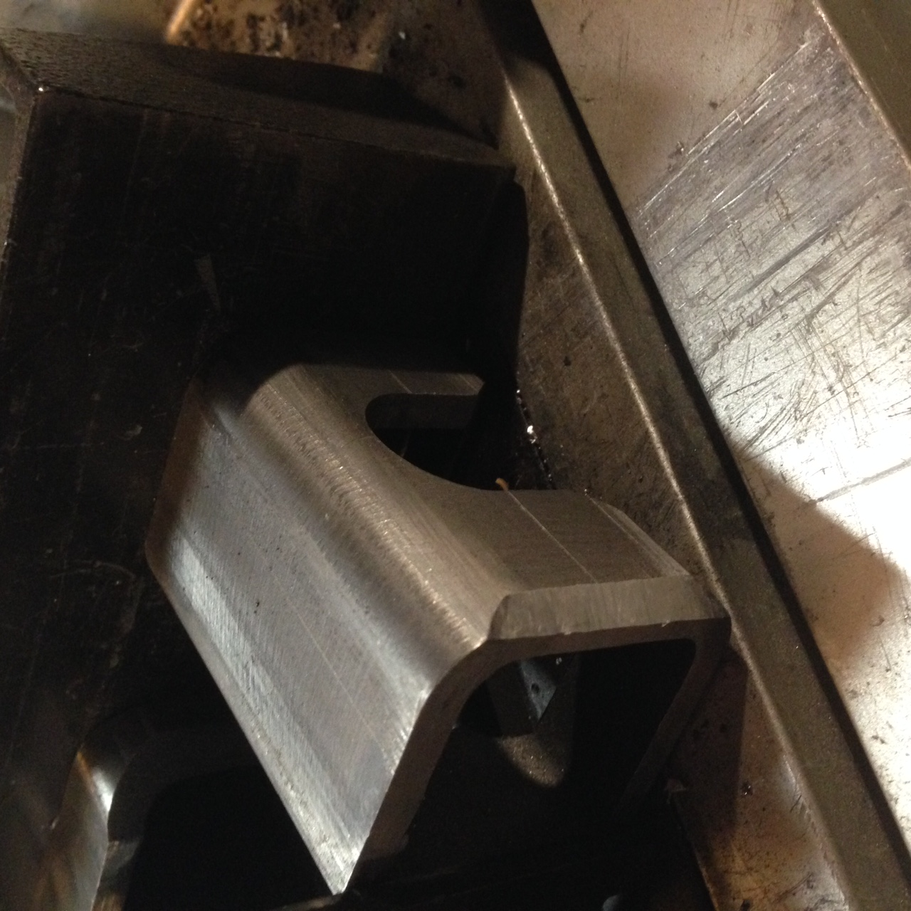

Here's cutting stacks of 1x1x1/8" angle iron with the Milwaukie cold cut saw.
Cuts fast.
I always cut angle iron face-down, it's the best way.

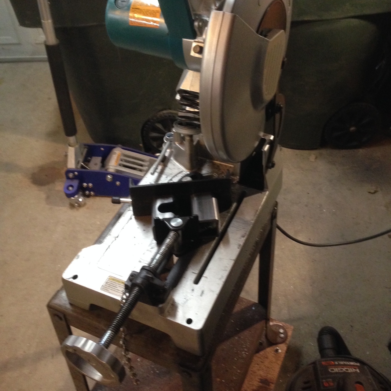

Here's some photo's. On the photo showing the top of the saw, you can see the adjustable index pointer and nice raised angle text. You also see the holder for the blade wrench
On the next photo, you can see the lever that tightens the fence to each position. You pull the lever out to gain more leverage and then can slide it in so it's out of the way for storage.
Here's the lever from the underside.
This last photo shows the quick engage/disengage for the all-thread clamp. You cam the knob left or right.
Let me know if you want any other photo's. I think you'd probably be happy with either the 14" Dewalt or the 12" Makita, I don't think the Makita's 2" diameter of the blade is much to worry about. It's amazing how fast these saws cut and how nice of an edge they leave. Just like any saw, you definitely want to use eye, ear and hand protection. I'll never use my abrasive saw again.
