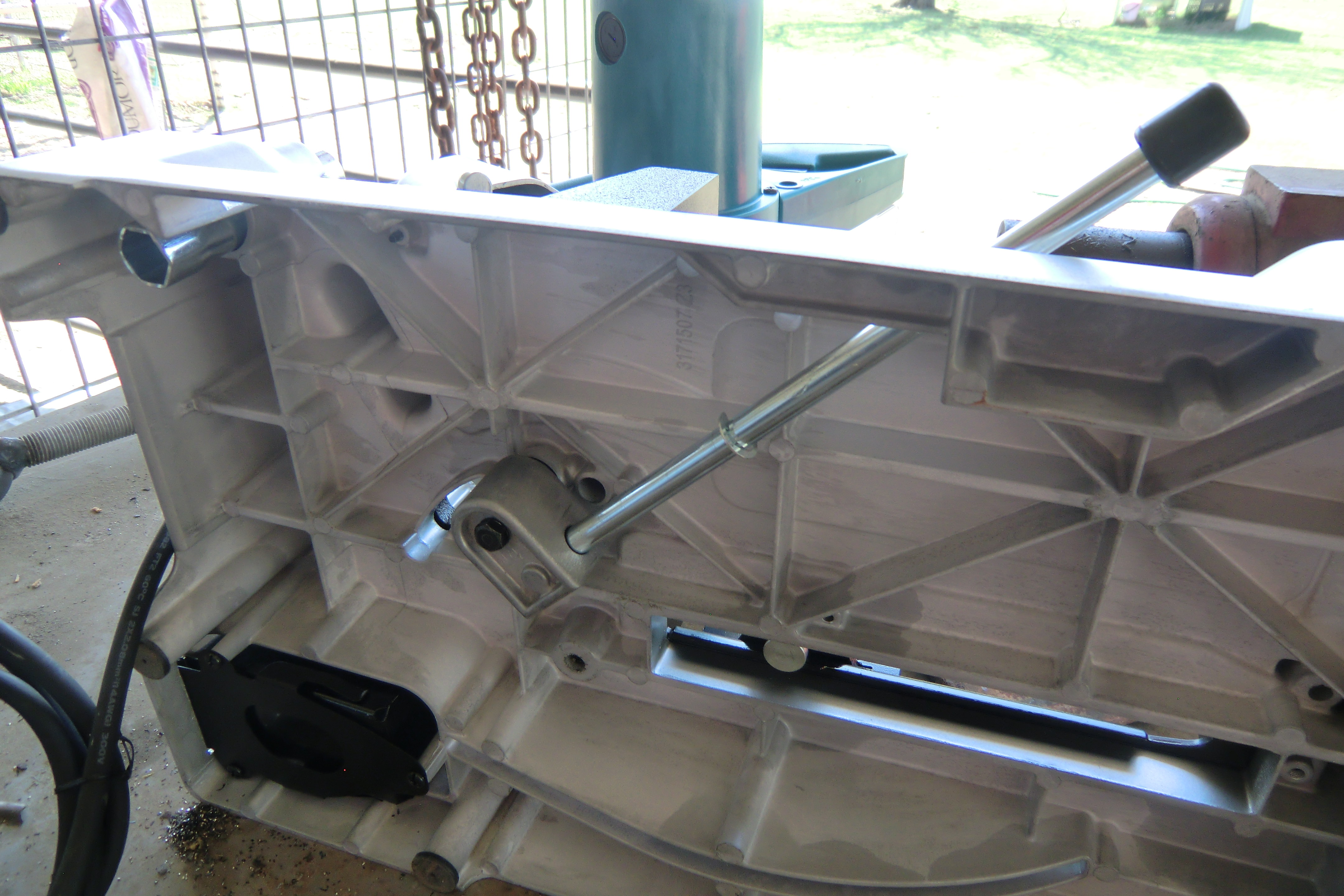

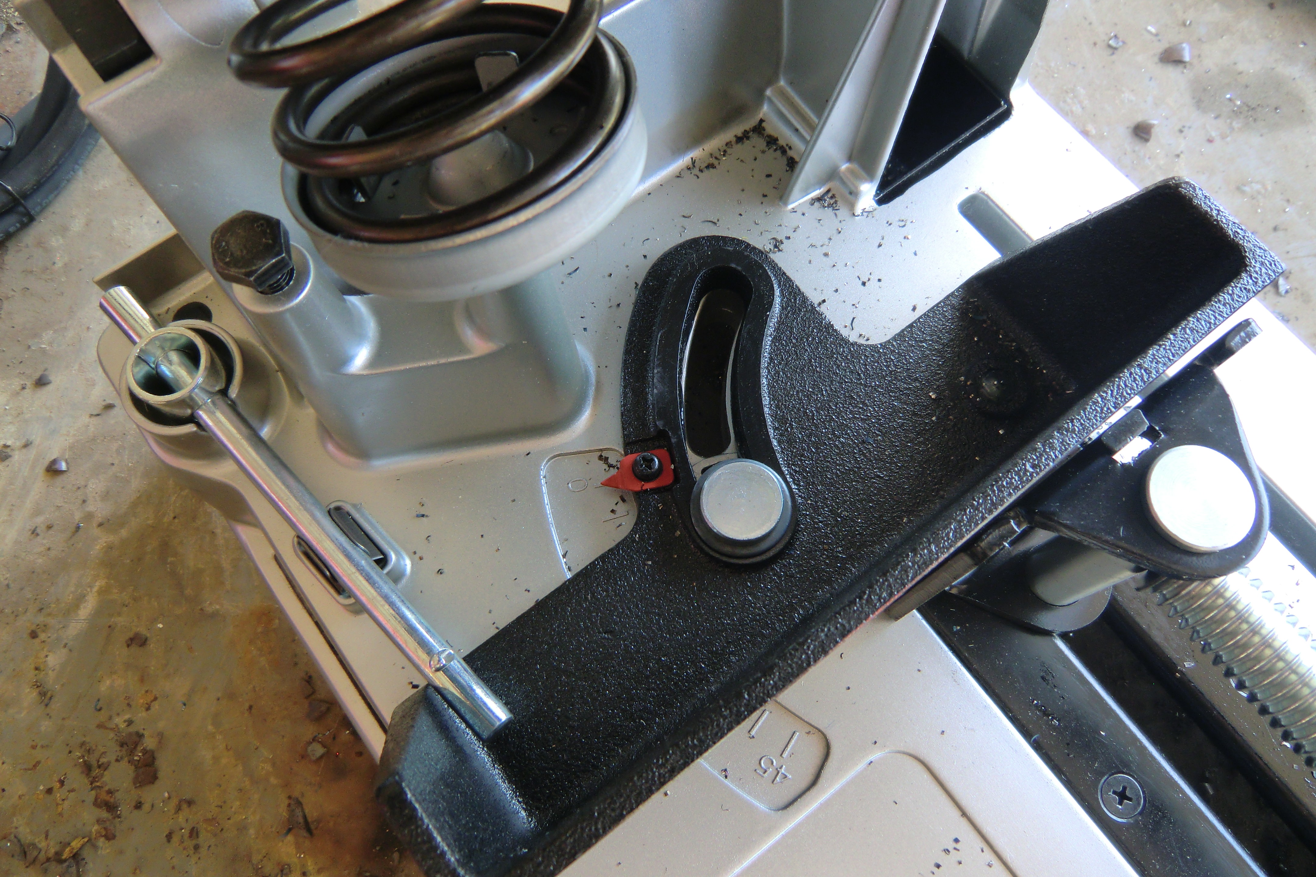

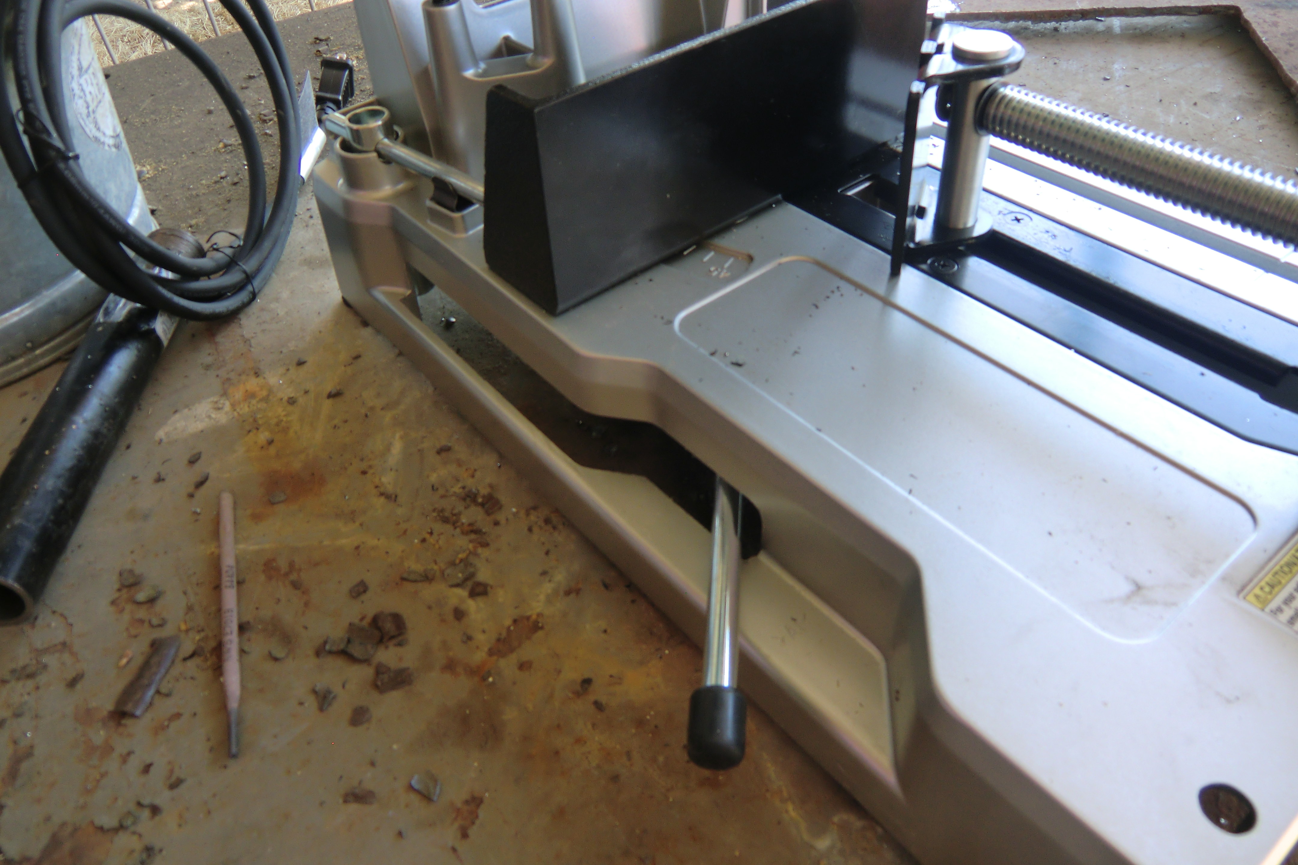

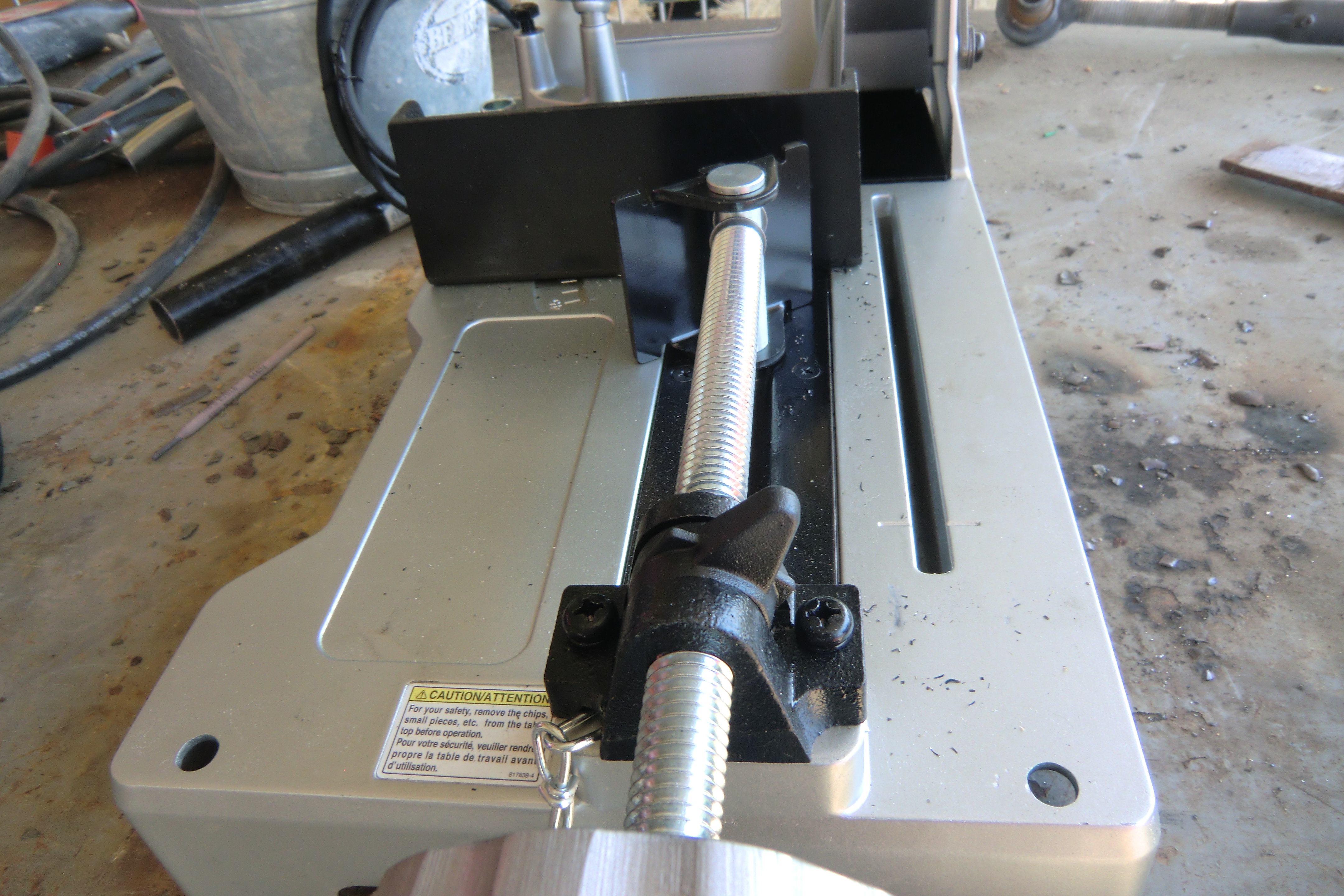

Here's some photo's. On the photo showing the top of the saw, you can see the adjustable index pointer and nice raised angle text. You also see the holder for the blade wrench
On the next photo, you can see the lever that tightens the fence to each position. You pull the lever out to gain more leverage and then can slide it in so it's out of the way for storage.
Here's the lever from the underside.
This last photo shows the quick engage/disengage for the all-thread clamp. You cam the knob left or right.
Let me know if you want any other photo's. I think you'd probably be happy with either the 14" Dewalt or the 12" Makita, I don't think the Makita's 2" diameter of the blade is much to worry about. It's amazing how fast these saws cut and how nice of an edge they leave. Just like any saw, you definitely want to use eye, ear and hand protection. I'll never use my abrasive saw again.
