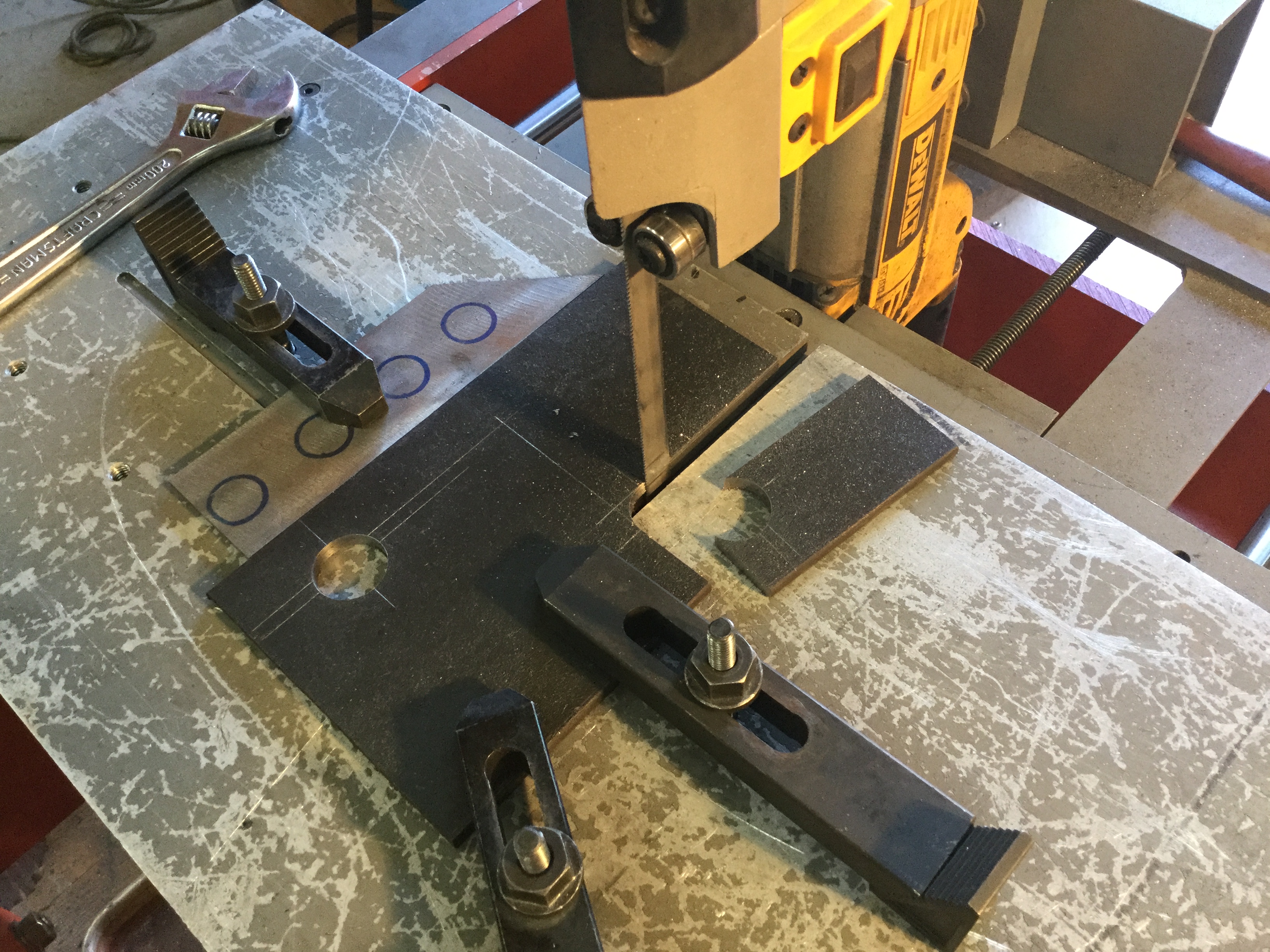

I was thinking the steel could be clamped to the table and the blade raised into it...
The saw top is about 3' x 4', so there's plenty of room to support the steel and clamp it.
SR
That's an interesting idea. 14" blade? Is the wheel to raise the blade in a convenient spot? If it's trunion-mounted direct drive you could probably rig a weighted pulley system.
Set the cut, release the weight for a smooth, consistent cut!

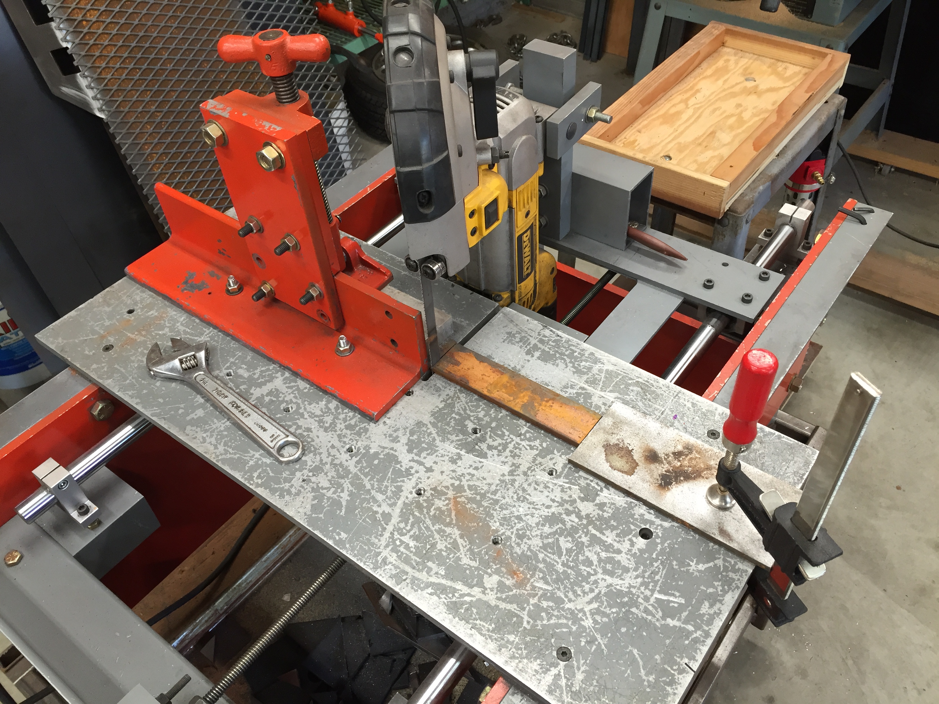

Here's a pict. of it when I brought it home,
I've stripped the table extensions and feeder off it, you can see the hand wheel to raise/lower the blade... It's made to accept a 14 or 16" blade...
It's one he!! of a saw, but I already have two Unisaws in my shop, so I could use this one for metal work if I wanted...
