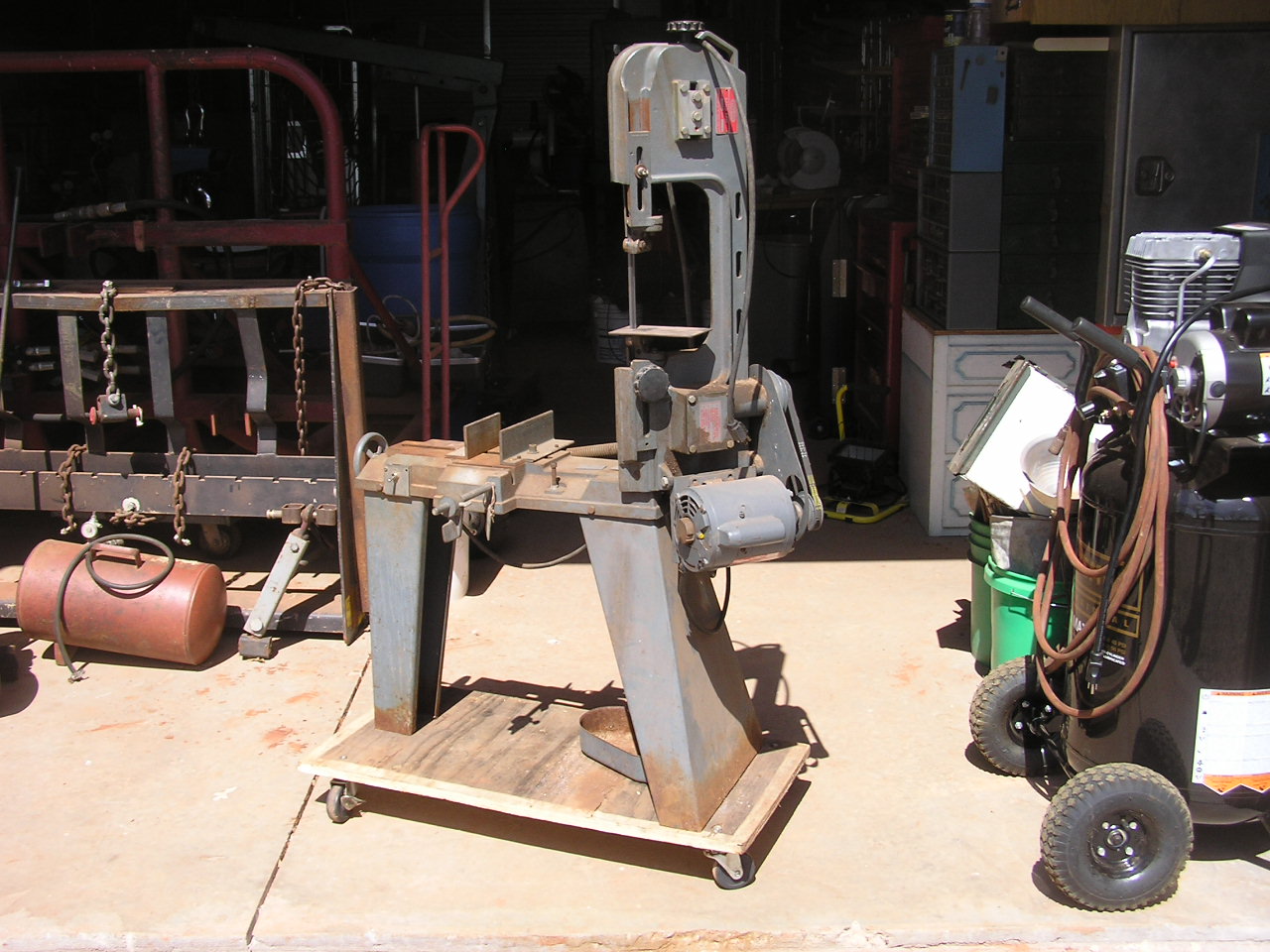

I like your table arrangement for your bench grinder and cold saw. Presumably this is to transport the tools outside so that you don't spray hot iron filings inside your shed when cutting and grinding steel. I am going to fabricate the same design as it looks so simple, effective and cheap (unless you have a patent on it. :)

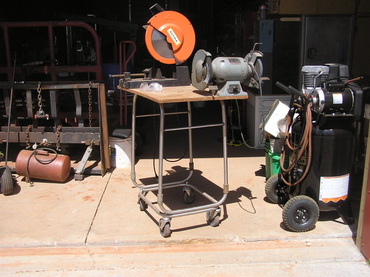

I bought a 14" from a local welding supply store.
Was amazed by the way it cuts metal. :thumbsup:
John
Thanks. It is on wheels for out of the way storage. There are no hot iron filings from the saw and they fall into a small container that pulls out to dump. You can touch the cut edge right after the cut.
No patent, so copy at will. The frame came from a store that was selling hospital surplus and I put a piece of plywood on top.

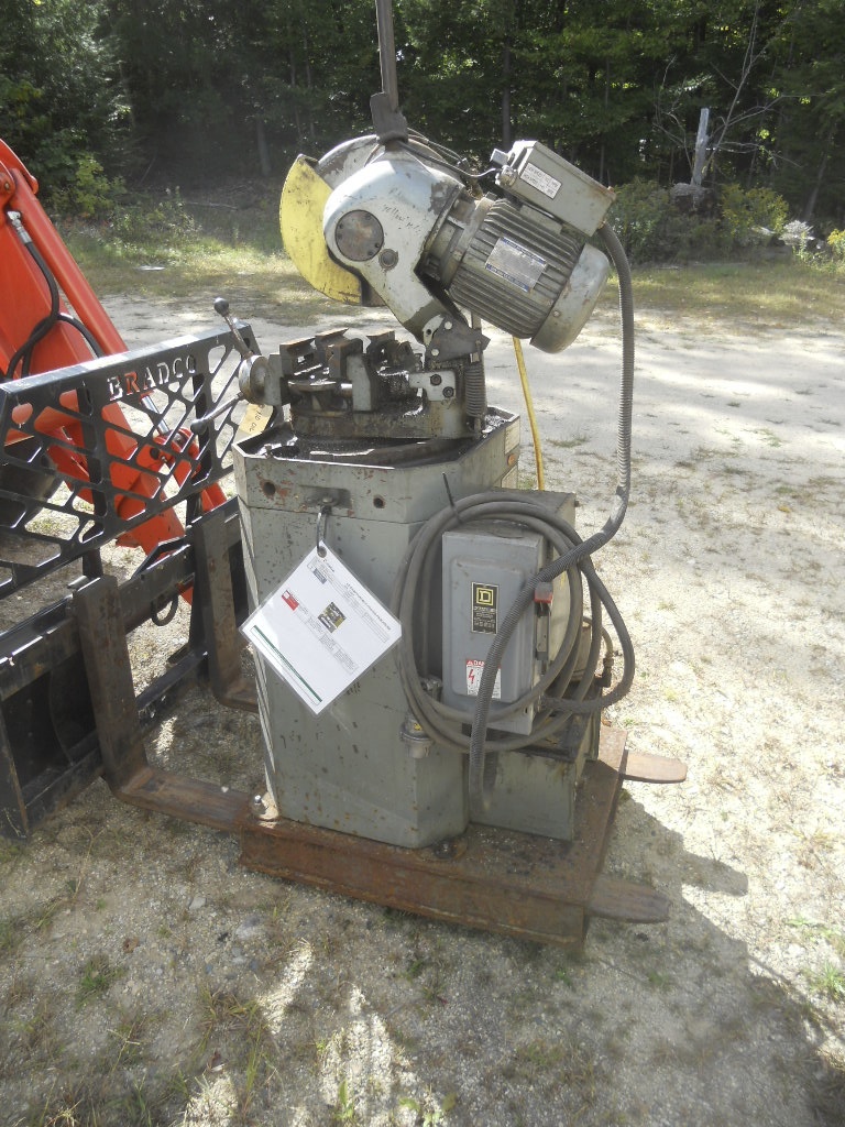

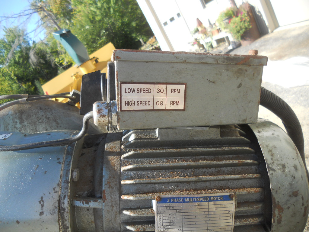

I bought a "real" cold saw for only $100! I need to re power it as it has a 3 phase that is usually no problem but it is from Canada and runs on a real high (575) voltage that we do not have here in the US.
Any motor guru's here? I wonder if the motor could be re wound or something.

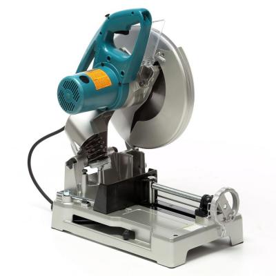

I bought a Makita cold saw the other day. Anxiously waiting for it to get delivered. I looked at the DeWalt, but it had the same crappy angle adjustment and clamp that my old Dewalt abrasive saw had. The Makita has a smaller blade (12" versus 14"), but the quality of the saw was so much better. I don't plan to be cutting anything too big with it anyway. I'll report back once I've used it a bit.

I'll contact them, but I think the 575v is the problem. That's more of a Canadian voltage from what I understand, and not available (used) here in the US. Thanks:thumbsup:

Post a picture of the data plate on the motor and someone here can probably point you to the correct replacement motor or the correct option for a phase converter/vfd.
Aaron Z
This pic is not the best, and the space on the info plat for "frame" is blank. Right now the saw is wrapped up outside in a snowbank.:laughing:

I really don't think you need to change the motor. We run irrigation pivot motors at 480 volts regularly without problems. They are a 440 volt motor.

I've been told that slightly over powering a motor (voltage wise) is negligible on the motor, but underpowering one is death. 575v running on 440 is a pretty big spread.

The Milwaukee was discontinued. Not sure why, everyone said it was a good saw. I looked at the 14" DeWalt and the 12" Makita. I ended up buying the Makita for the clamp issue that you describe. I have a Dewalt abrasive saw that's virtually identical to the Dewalt cold saw and I always felt the clamp was junk. Like you describe, it's fine for clamping at 90 degrees, but it wouldn't hold an angle worth a flip. The Makita has a really nice clamp and the 12" will still cut all the material sizes that I plan to cut.

Oh missed the high voltage. Yea that is a tough one.
