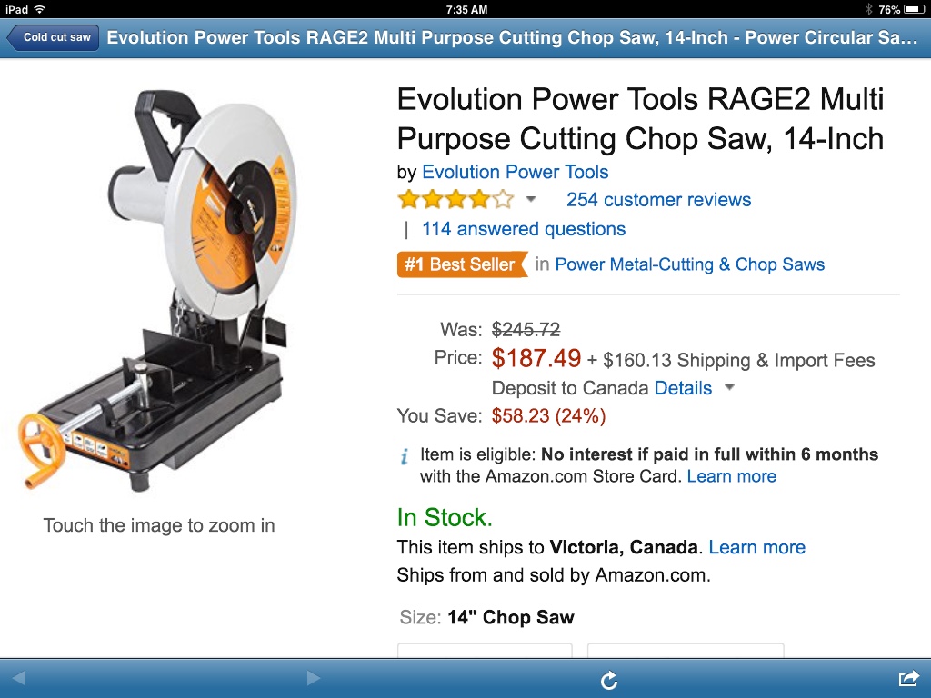

Yep, these are usually called "Metal Cutting" and get your favorite brand of this style:

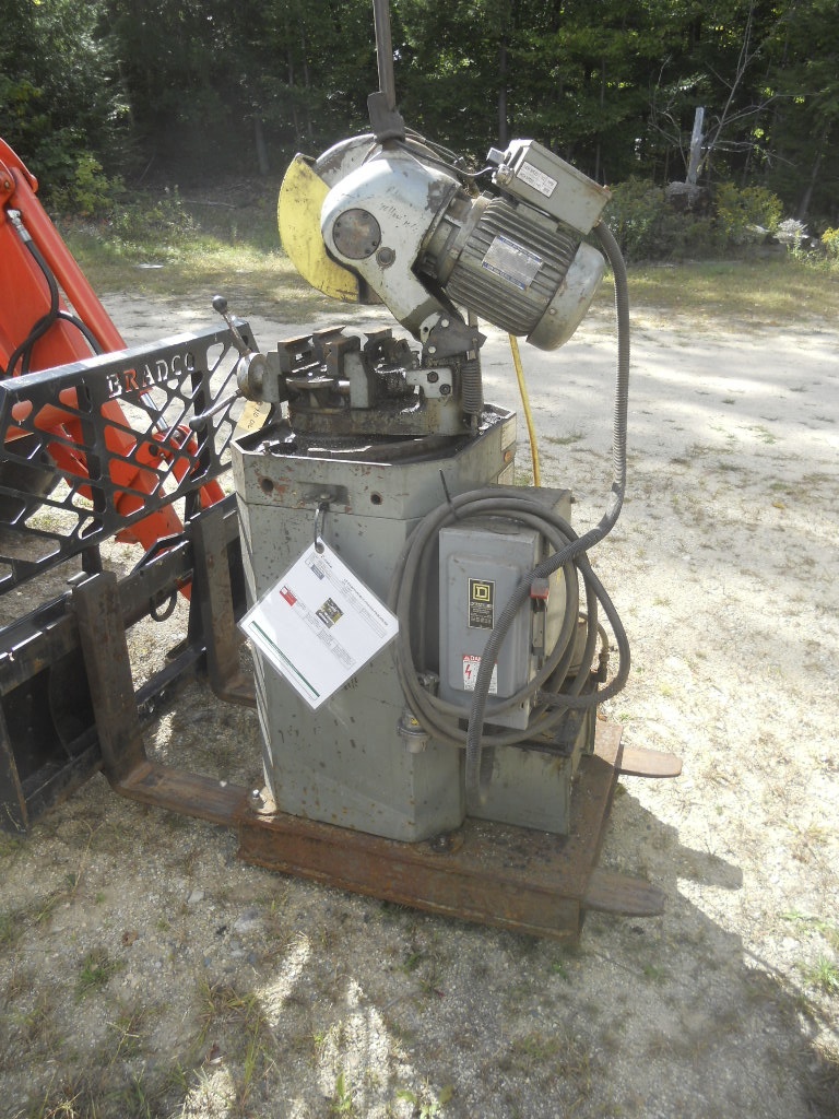

I bought a "real" cold saw for only $100! I need to re power it as it has a 3 phase that is usually no problem but it is from Canada and runs on a real high (575) voltage that we do not have here in the US.
Any motor guru's here? I wonder if the motor could be re wound or something.

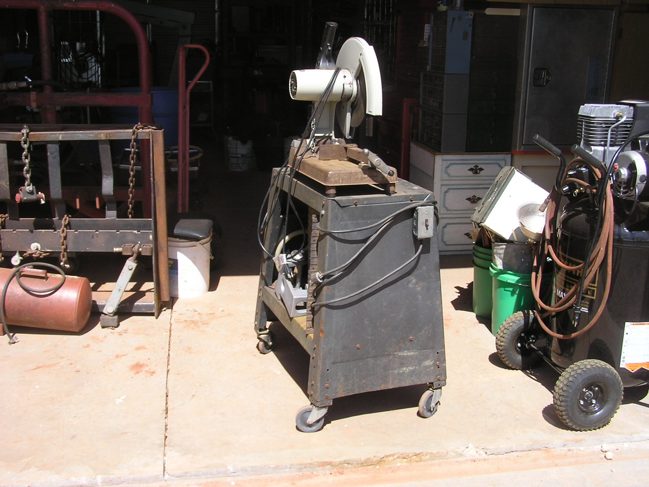

I use my horizontal bandsaw for most projects also. However I would NEVER part with my 30+ year old Makita abrasive chop saw.
I keep it (on wheels) out of the way under a bench. Pretty hard to beat for a "quick and dirty" (precision not required) cut. Plus it's great for slotting square and round tube.
Terry
Buy the looks of things, what you need is another drill press...........Tools on wheels is good if you got a place to wheel it, me I'm rounding out of floor space fast, but with 10&14' walls I still have fair amount of air space, my cut-off tool might have be on ropes and pulleys.
Why is that motor so big, maybe theres a smaller one that will fit on that, or you could run a extension cord across the border.
I wonder if you could find an equivalent 220v or 110v motor that will bolt on. Even if you spend a few hundred you will be way ahead for what that saw costs new. Maybe contact the mfg direct and see what they say.

I just need to do some research, I'd willingly spend $4-500 on a motor. It is direct face mount to the right angle drive unit. That would still be a very cheap date for a cold saw. The material clamp and angle adjustment are miles ahead of my chop saws.
I agree with your assessment. I'm certain you will find a good used single OR three phase motor for well under $500.
Even assuming the WORST case scenario (buying a NEW 5HP 3 ph Baldor with a list price of $1400) you'll still do well.
That's probably a 3 or 5 HP on it presently?

See what kind of frame the 3ph has, and what type of shaft that intersects with the saw. I have a feeling that it won't be easy to repower this, or everyone would be grabbing cheap 3ph stuff and doing that, other than using rotary converters and other methods. I could be wrong; it would be nice if it was that easy.

Pretty sure that old saw has a gear head to reduce motor speed. You should be able to find a American voltage, 120/240 motor, with the same mount. Most of those mounts are pretty standard in size, just have to find out to which mounting standard and rpm's your motor is. Should be on the tag.
found a link you might want to read thru. 575 Volt 3 Phase - Who Uses it?
