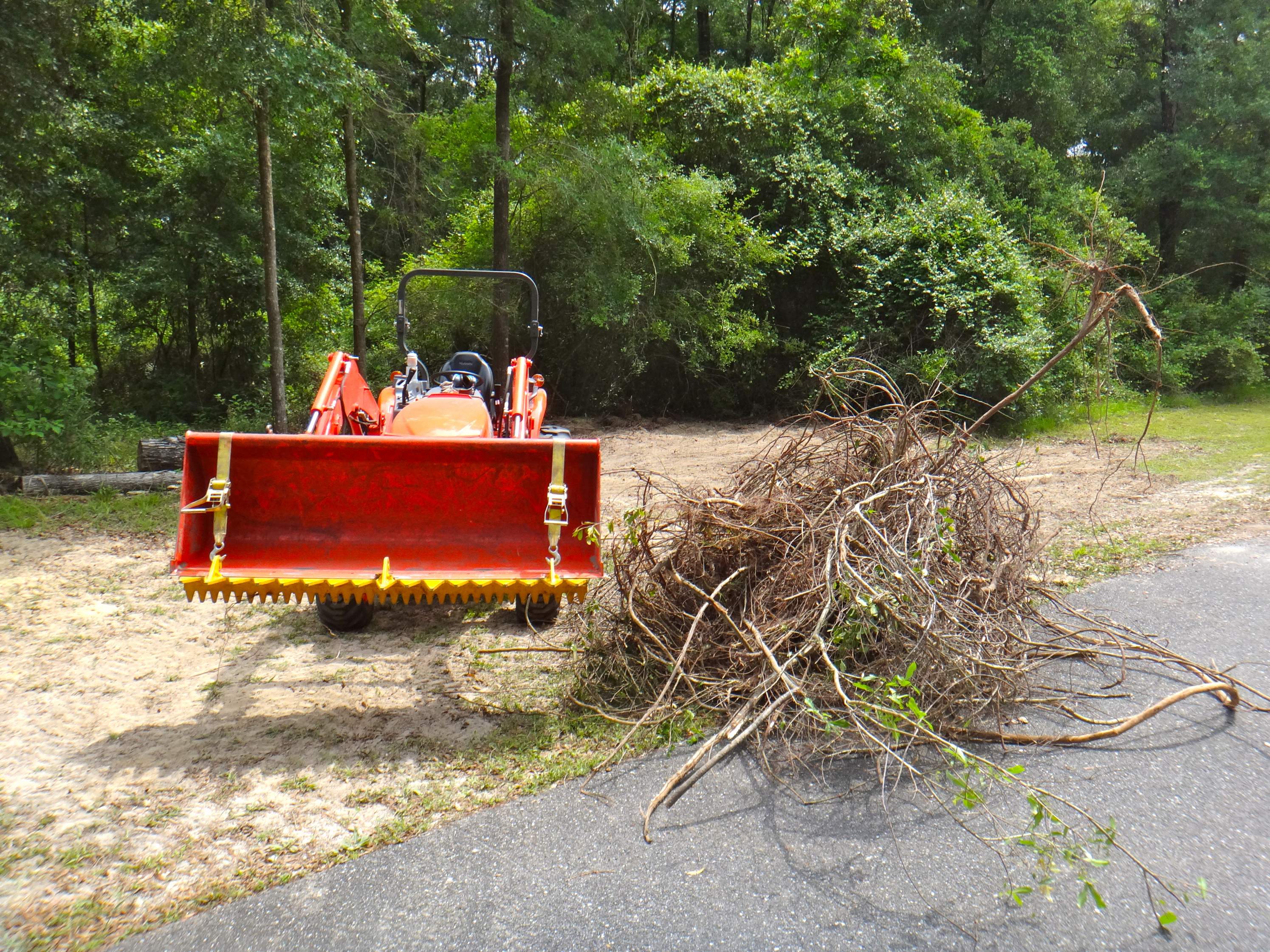

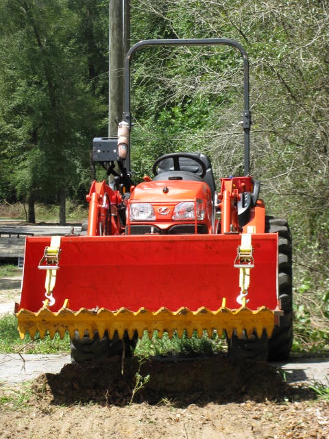

I cleared my brush with the FEL. Would have been quicker and easier if I had a tooth bar on the bucket but trees under 3 inch cleared easy with the FEL.
I would think a backhoe would be slow work.

Brush that we have around here, like russian olive, rose bushes, and other "bushy" stuff all push out really easy with a loader and tooth bar.
I have a backhoe. Given the choice, for brush, I choose the FEL.
Now if you have trees to clear that are 6" or larger, a backhoe is a better tool.

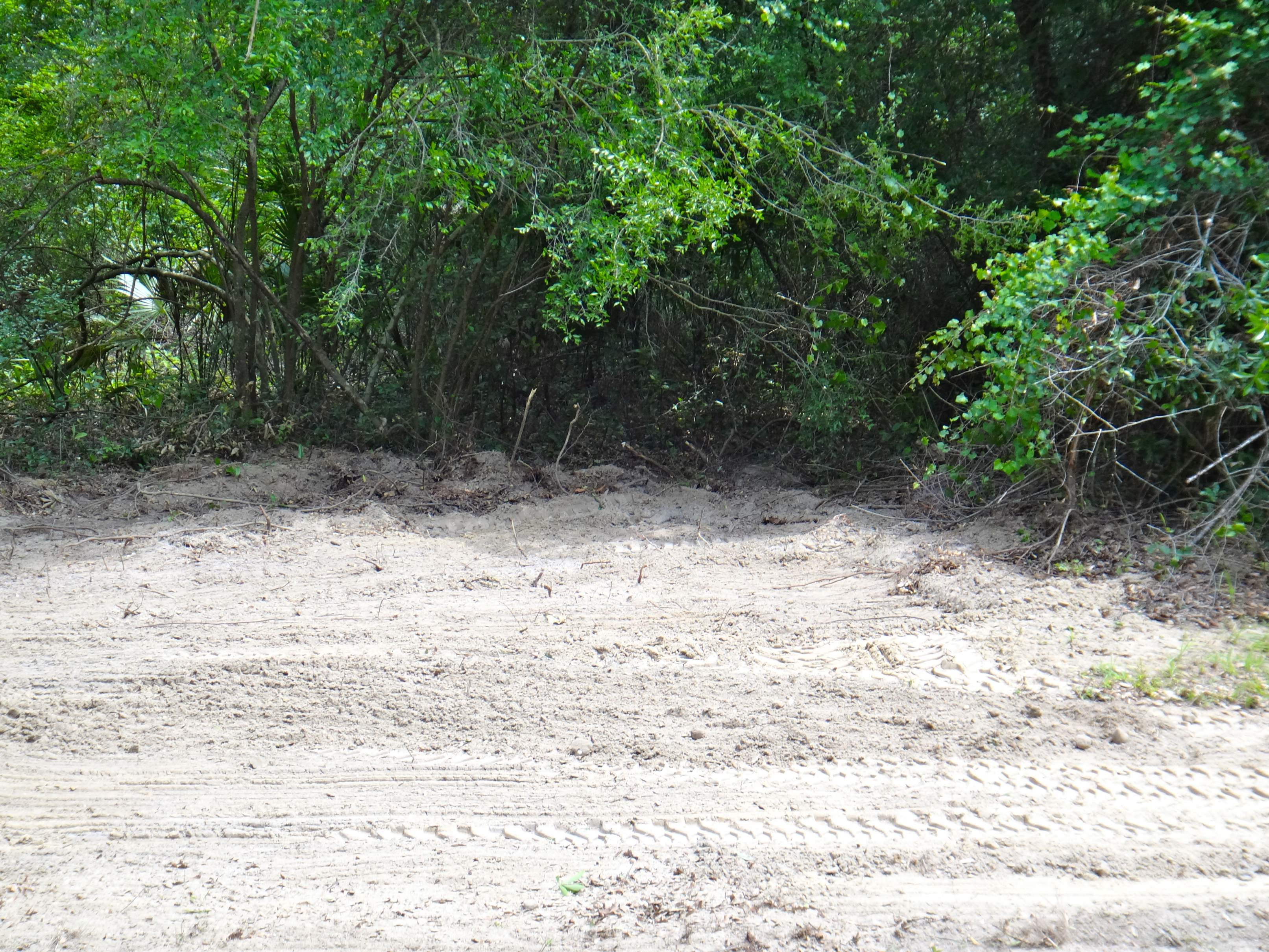

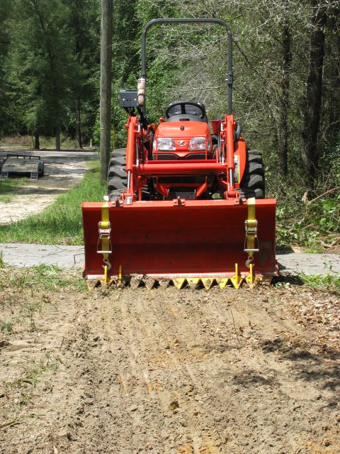

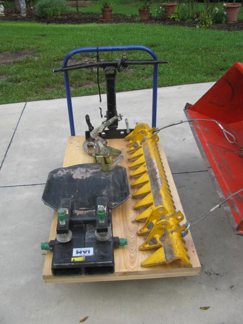

There are 20+ acres of 6-8' brush to clear on a recently purchased farm that has been neglected for over 15 years. Would also be using it to maintiain gas well roads throughout the property which have shale rock mixed in with primarily clay soil.

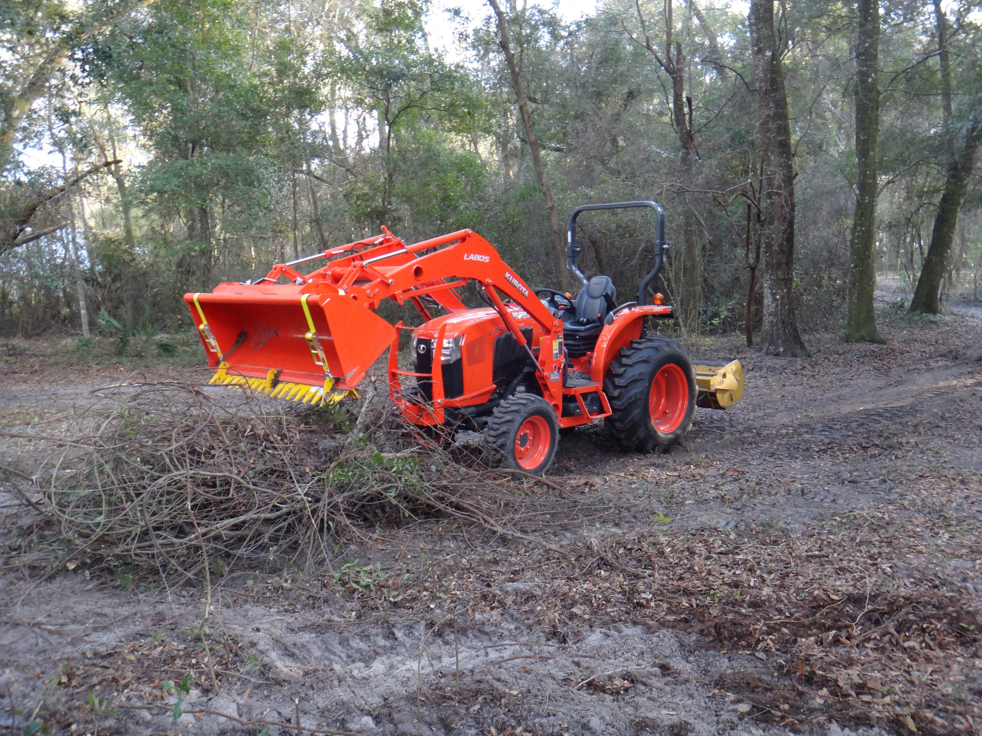

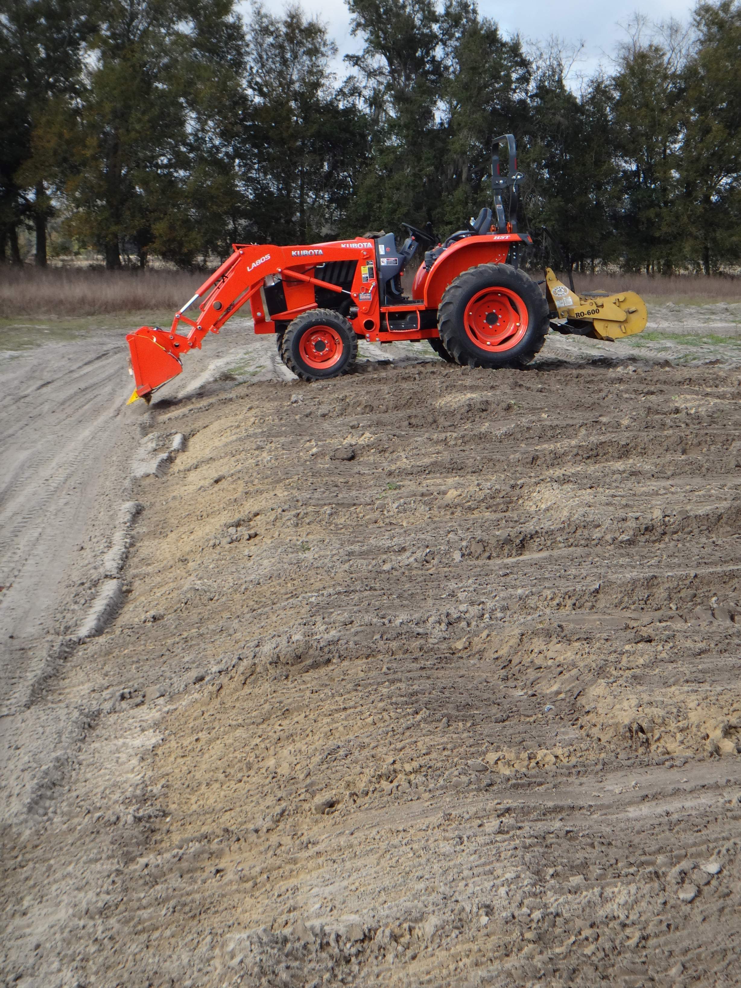

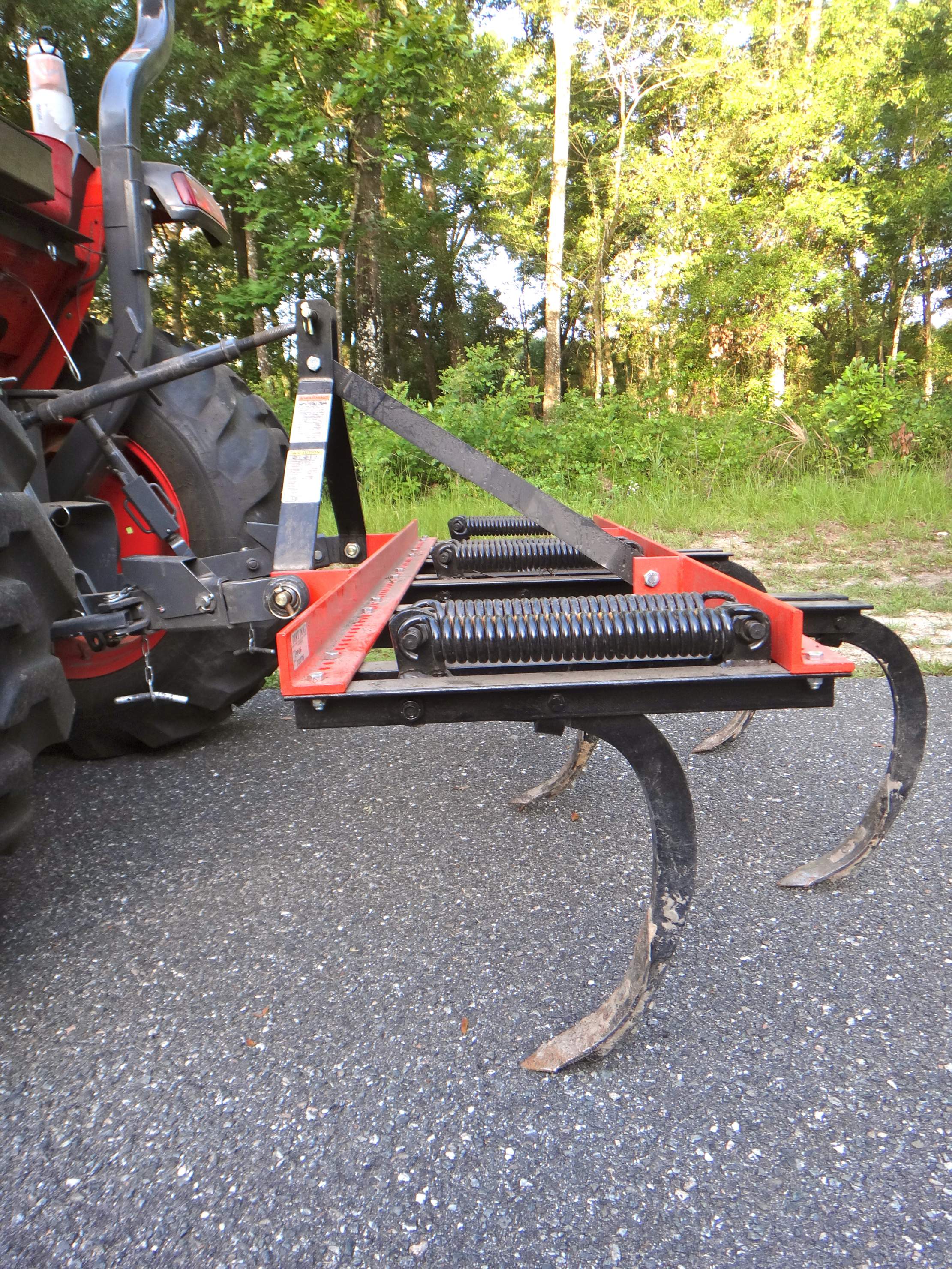

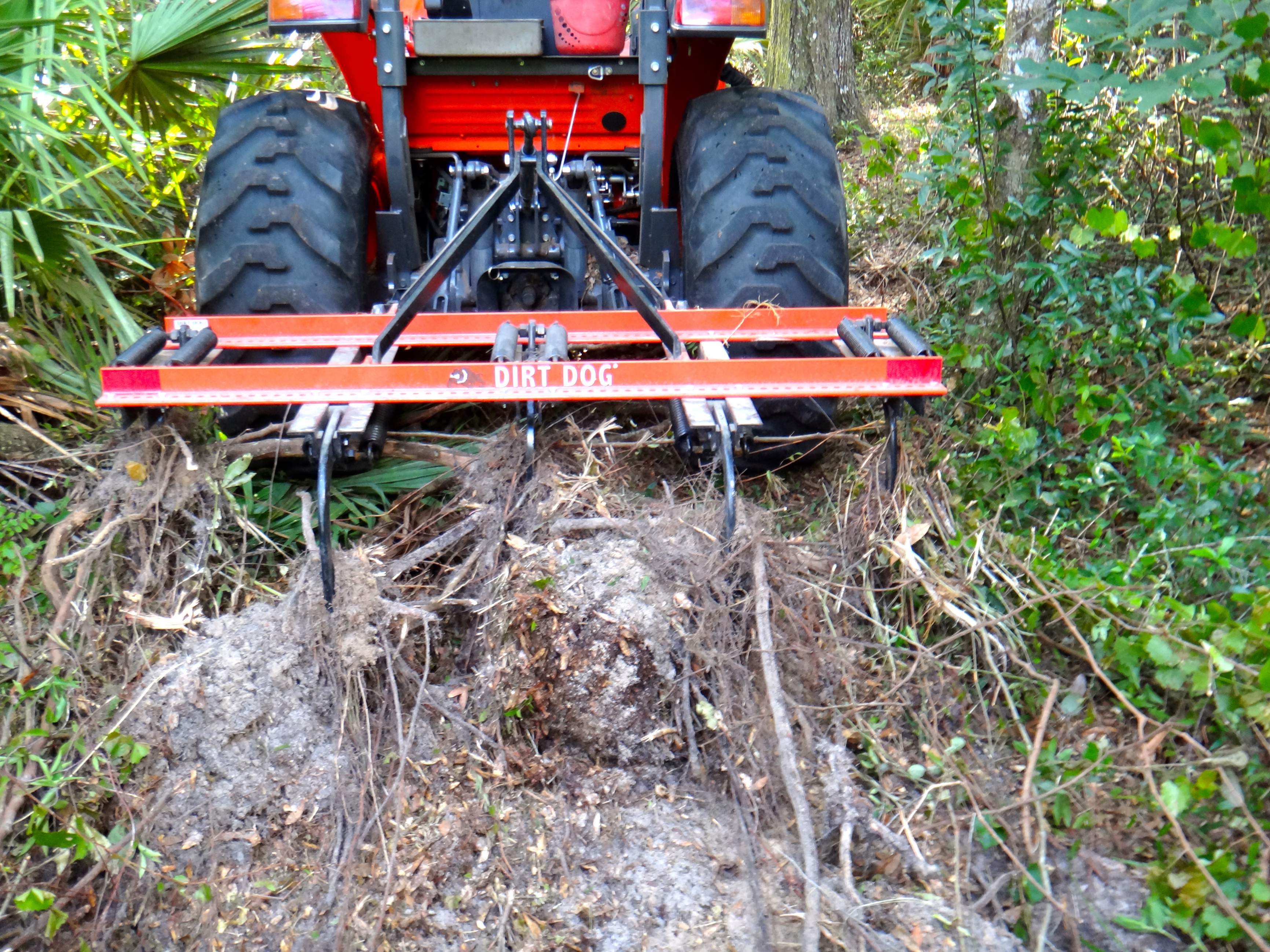

For clearing brush with secondary employment for grading, nothing will best a Ratchet Rake, sold by the T-B-N store with FedEx delivery.
VIDEOS: https://www.youtube.com/results?search_query=RATCHET+RAKE
Also consideer a Field Cultivator for exhuming root systems.
