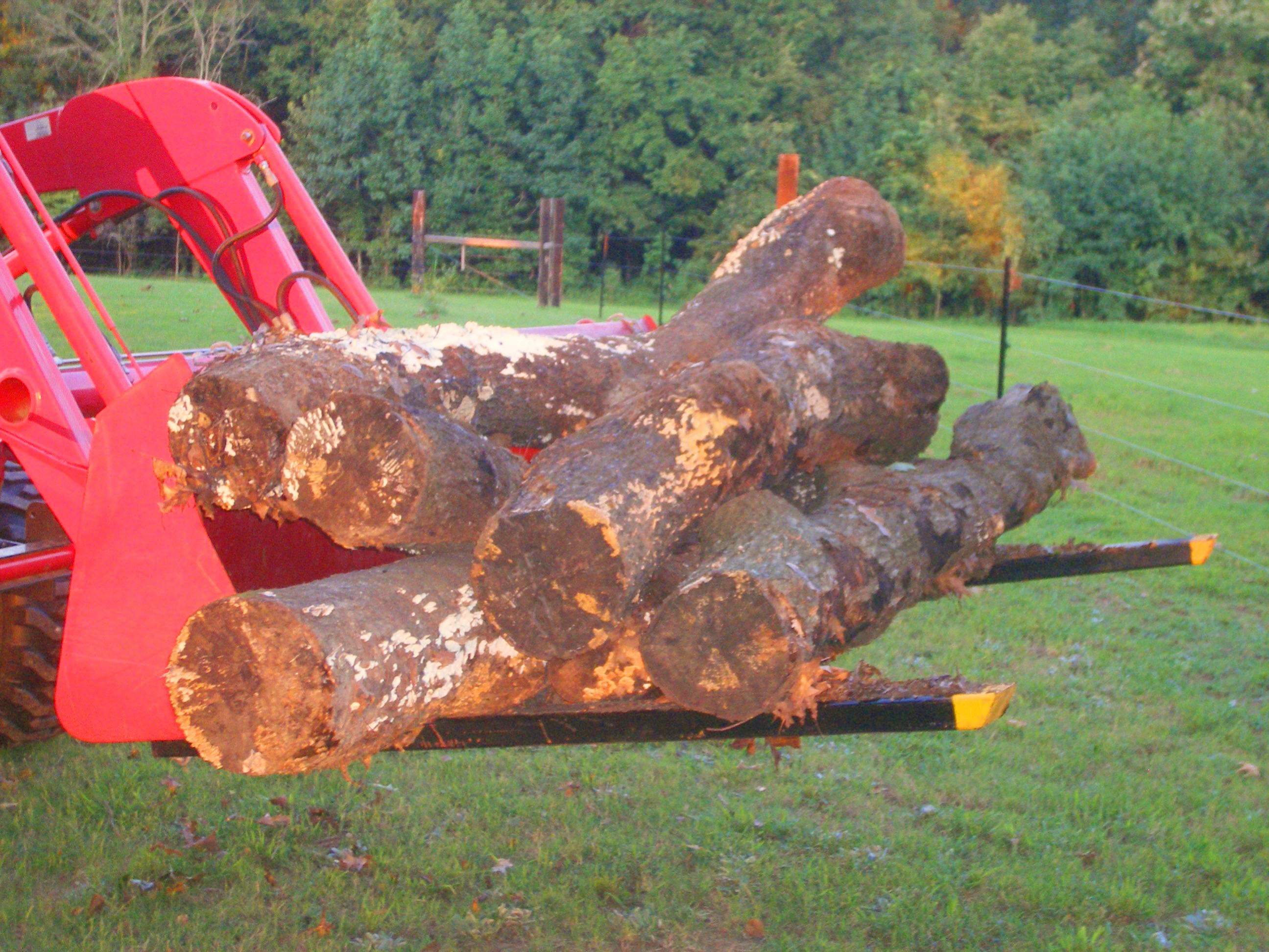

I bought an inexpensive set of pallet type forks for my 955. After a season I had the channel steel forks reinforced so they wouldn't just bend down with use. Probably my biggest disappointment with these is that any side pressure and they twist sideways/slip on the FEL bucket. Any more bolt pressure and the bucket deforms/dimples. Not being able to see the tips of the forks while in normal use because of the FEL bucket is annoying.
The best I could pick up was about 14-16" diameter logs 10-12 feet long before deforming both the forks before reinforcement or the 5 foot FEL bucket. I can't see picking up a 30 inch log..I would think that some part of the equation, either the forks, bucket or hydraulics would break.

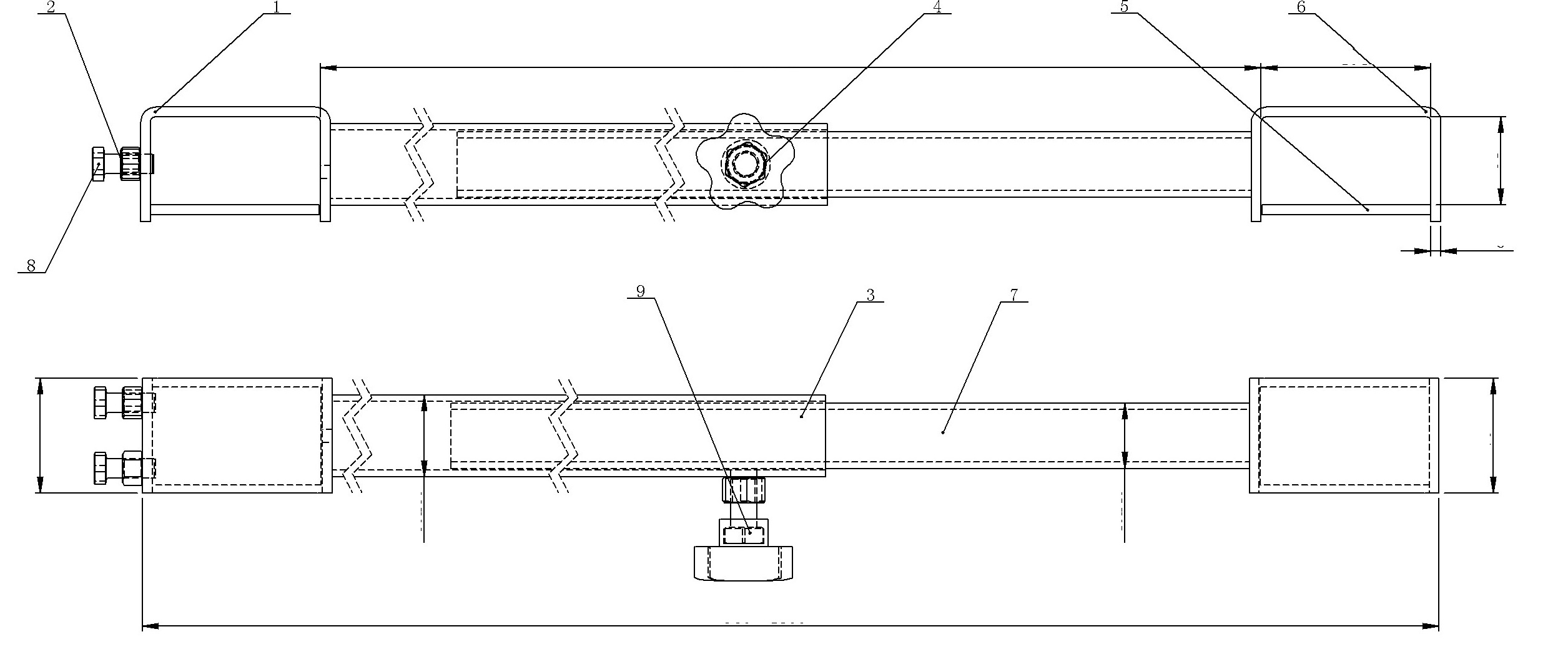

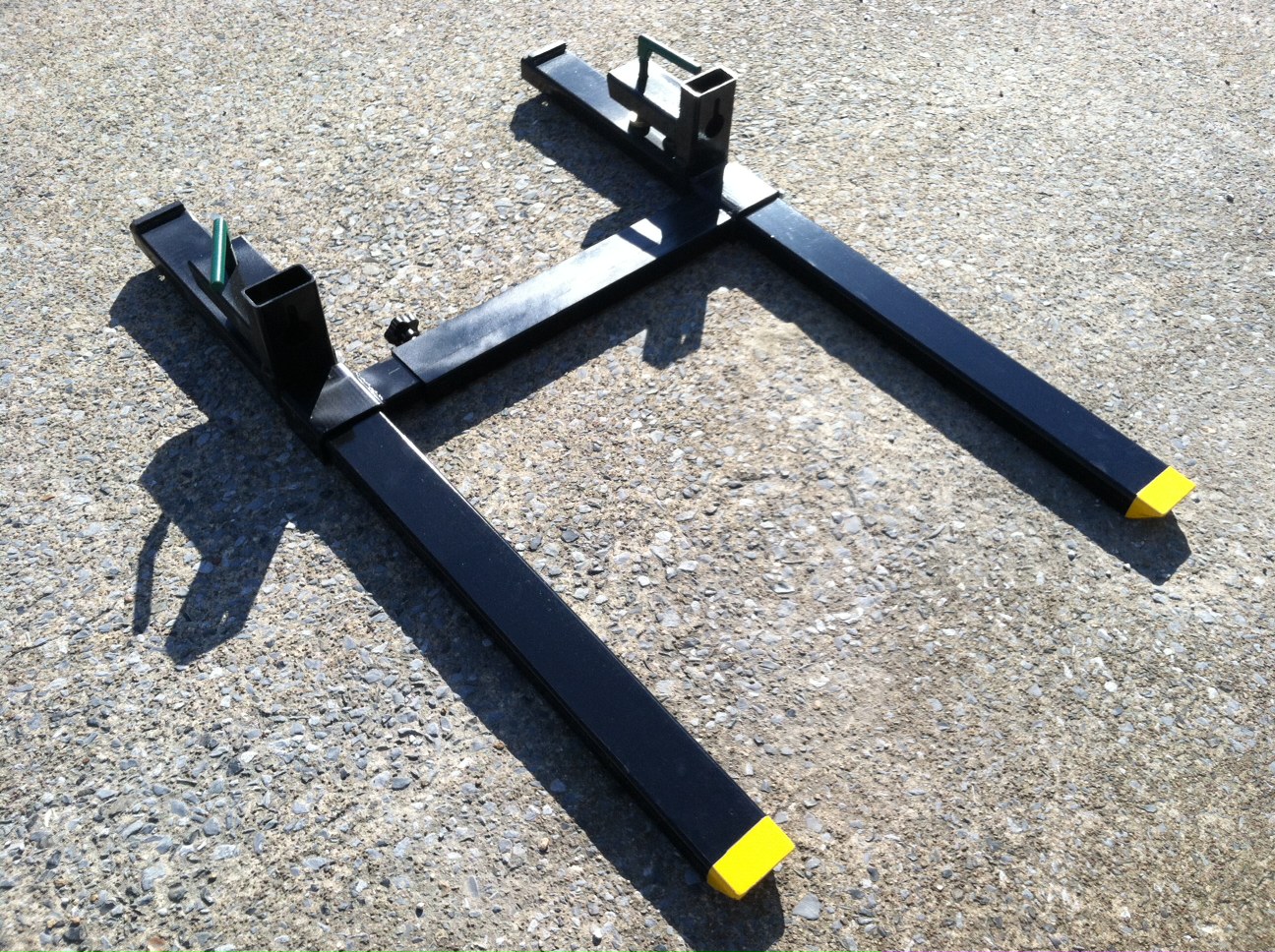

Hi there,
The outside dimensions of our forks are 2x4" and the openings on the spreader/stabilizer bar is slightly larger than 2"x4". The bar telescopes from 26" to 50" wide. The ends of the bar have set screws to keep it from sliding. Pallet Fork Attachments | Clamp on Pallet Forks | palletforks.com
If you are doing some serious lifting you can insert chain to the chain holes. Not only will this keep the forks from sliding around but it also spreads the weight to the top as well as the bottom of the bucket.
