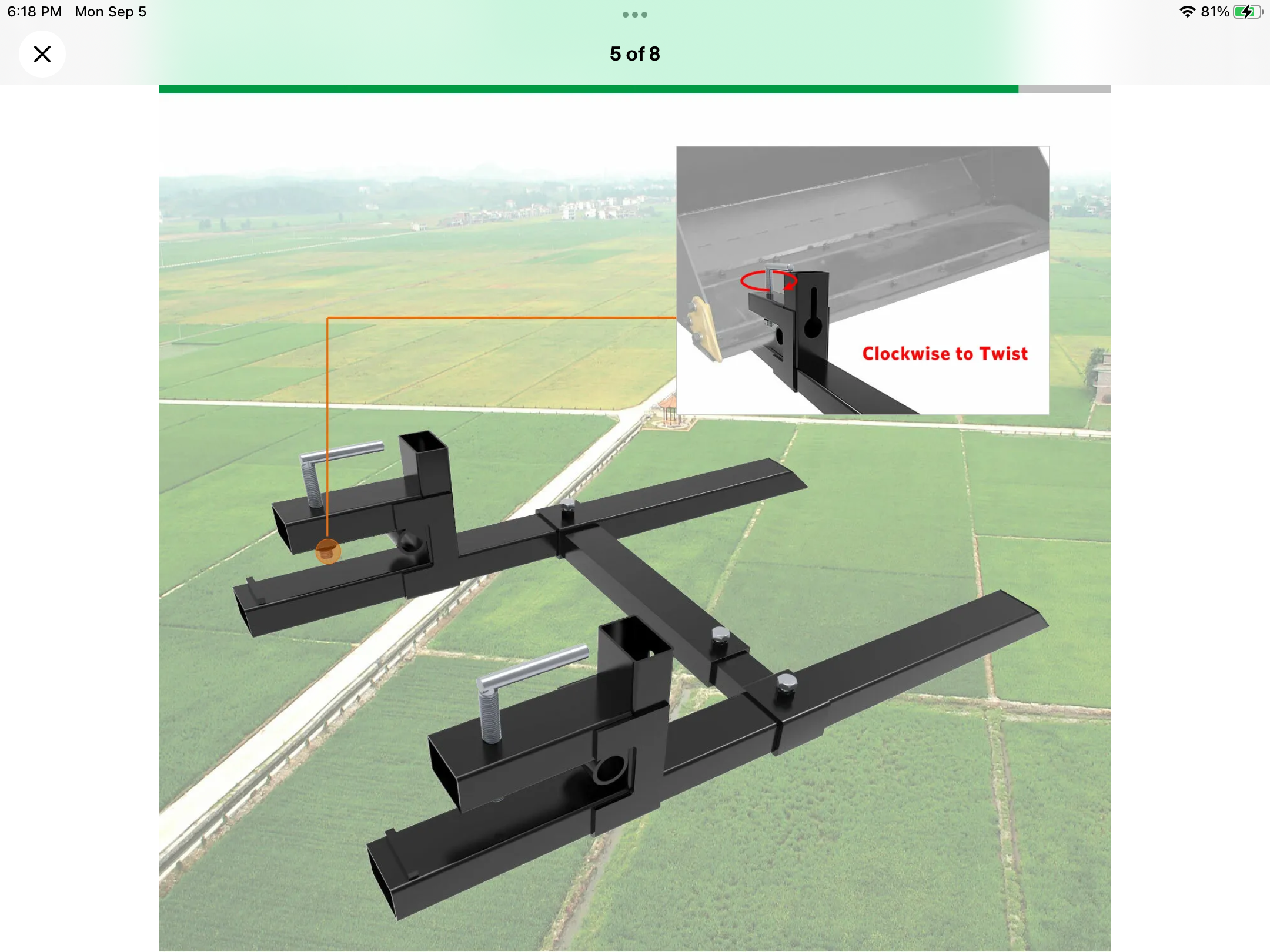

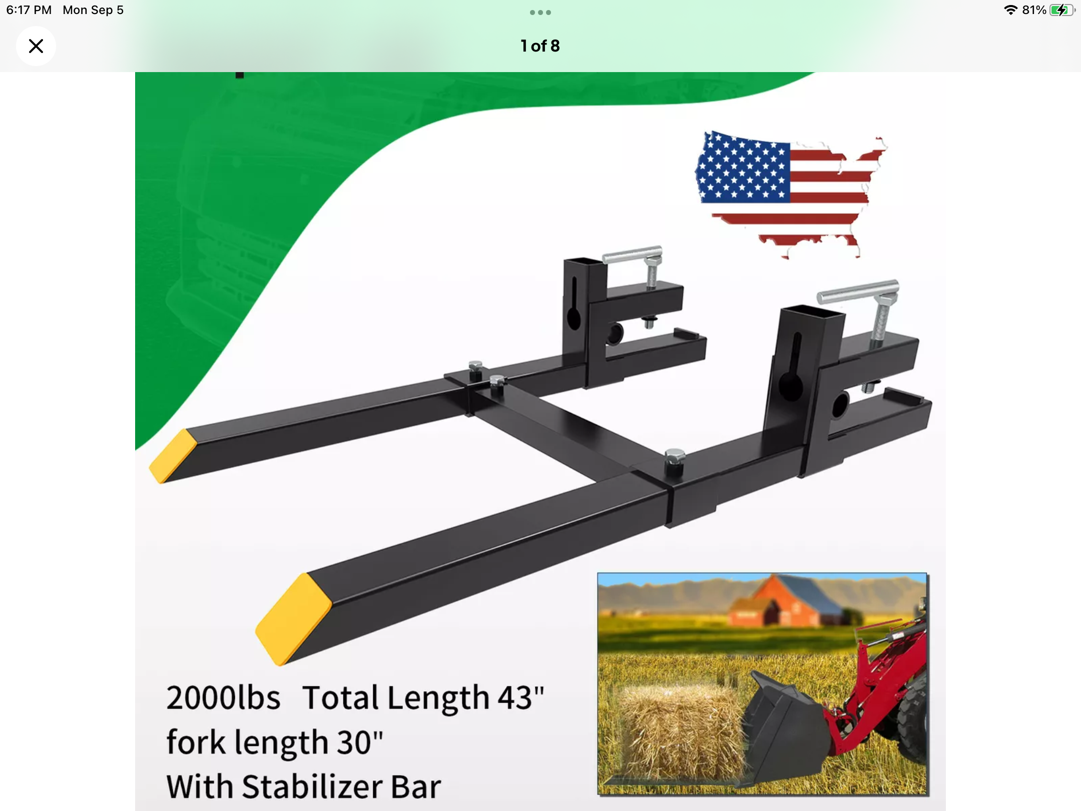

Anyone using clamp on forks similar to these? A set of forks would sure would be handy to have. I wouldn’t be picking more than 300-500 lbs. but I don’t want damage my bucket.

I bought one of the Titan sets off EBay. Well, my neighbor actually bought them, then I bought them from him. I don't lift things frequently, but when needed, they work great.... for my use....
That use is considered "light use". I have lifted a full 55 gal drum off of the truck, lifted 16- 4"x6"-8' pressure treated posts, carried / moved pallets with 4-500 lbs on them. Nothing like continually having to use them.
The only issue that I have had was the 'screw' loosening allowing one or both forks to move out of 'alignment'. Not really a big deal, more of an occasional nuisance.
If I had to use forks on a daily basis... well I would get an SSQA set of forks.
The bolt ons are ok for those occasional uses

I also have a Titan set, without the stabilizer bar. I have the same experience.
Great to have around for moving a pallet with something on it, lifting stuff out of a pickup truck, etc.
But given the geometry, don't expect to pick up anything remotely close to the nominal lifting capacity of your loader, a number reflecting capacity at the pins, not several feet out in front, pinching the bucket at one point.
I've seen people who have put a divot in their bucket through carrying excessive weight on them. I'm being careful, and I have a heavy duty bucket.
I've learned the hard way to keep the screw lubricated and to unmount them at end of day: they can get semi-stuck if you leave them on too long, tightened. Nothing you can't get off, but it's no fun on a rainy, November day when you need the loader for something else.
In case useful to anyone, I do have a screwed-on Piranha tooth bar on the bucket. The forks will go on over top, but need to be set between the teeth.

If you decide to get a set of bucket forks. Couple of things to remember. Bucket materal is thin, per 5030 post above. So I use a couple of 6"x6"x1/8" steel plates under the bolt clamps to keep from "dimple-ing" my bucket, esp if you're trying to lift 500# or more.
With the forks so far out in front of your bucket, your lifting capacity will diminish by 50% or more depending on your hydraulics. Just keep that in mind.

Just be apprised that using clamp on forks with a light duty material bucket can have detrimental effects to the bottom sheet if the forks are overloaded and once you put a smile in the bucket, it's almost impossible to remediate without extensive cutting and rewelding.

Anyone using clamp on forks similar to these? A set of forks would sure would be handy to have. I wouldn’t be picking more than 300-500 lbs. but I don’t want damage my bucket. View attachment 761195View attachment 761196
I don't prefer them. They just can't perform like real forks can and they can ruin your bucket. Or rather the operator can ruin the bucket by execting too much of them.

I have a set just like them.
As said before the buckets can't handle any weight cantilevered so far out.
The most I can safely pick up without damaging my bucket, is about 250-300lbs.
Do they help? Sure, I can't lift 250lbs by myself.
I paid about $125.00.

I have the Titan set (1500 lb) and only lift that 200-400 lb range. I love mine for their utility and quick mounting. The riser tubes at the bucket end of the forks are crucial to proper usage. Whether with square steel tube or just timber, when risers are used and secured (I use ratchet strap..) to the top of the bucket, the forks are much more stable and kinder to the steel plate on the bottom of the bucket.
/ Clamp on Bucket Forks #16
To a point. The bottom sheet on a material bucket is still taking the brunt of the deflection. You'd be better off chaining it as chains to stretch, straps do.
/ Clamp on Bucket Forks #17
For the weights I work with, the straps have been working fine. Any more than a couple hundred pounds, I would move to chains.
I have a set of the 42" (fork pallet length) with the bolts on top. Those bolts on top are in the way and stops going into a pallet (less about 4").
That is the only problem that I've had. I have used them only once so far.
It does work - but you have to be very careful !!
