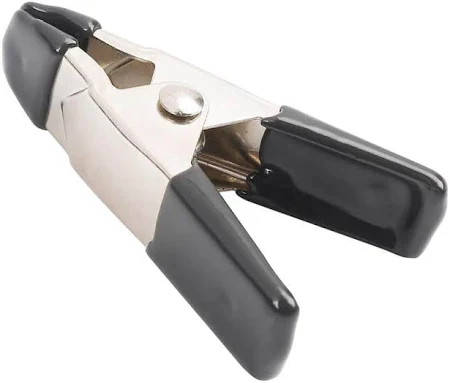

It takes forever to thread all 4 wingnuts. It's also a pain, because of the location of the holes, to get the bolt through the holes. Ideally I would want some type of clip. The solution Tinhack solves one of my complaints. It's not perfect but a step in the right direction. Plus, I was able to get those clips in red. Really hard to loose those in the leaves. Of course I could always spray paint the wingnuts I have. I'll likely paint the bolts anyways.

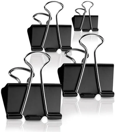

Didn't really think of it but something like this might be ideal. Mainly the binder clamps. I remember having some large ones that grip pretty tight. I think they would stay put with all the jostling a UTV goes through over rough terrain. I might just return those cymbal nut if they work.
