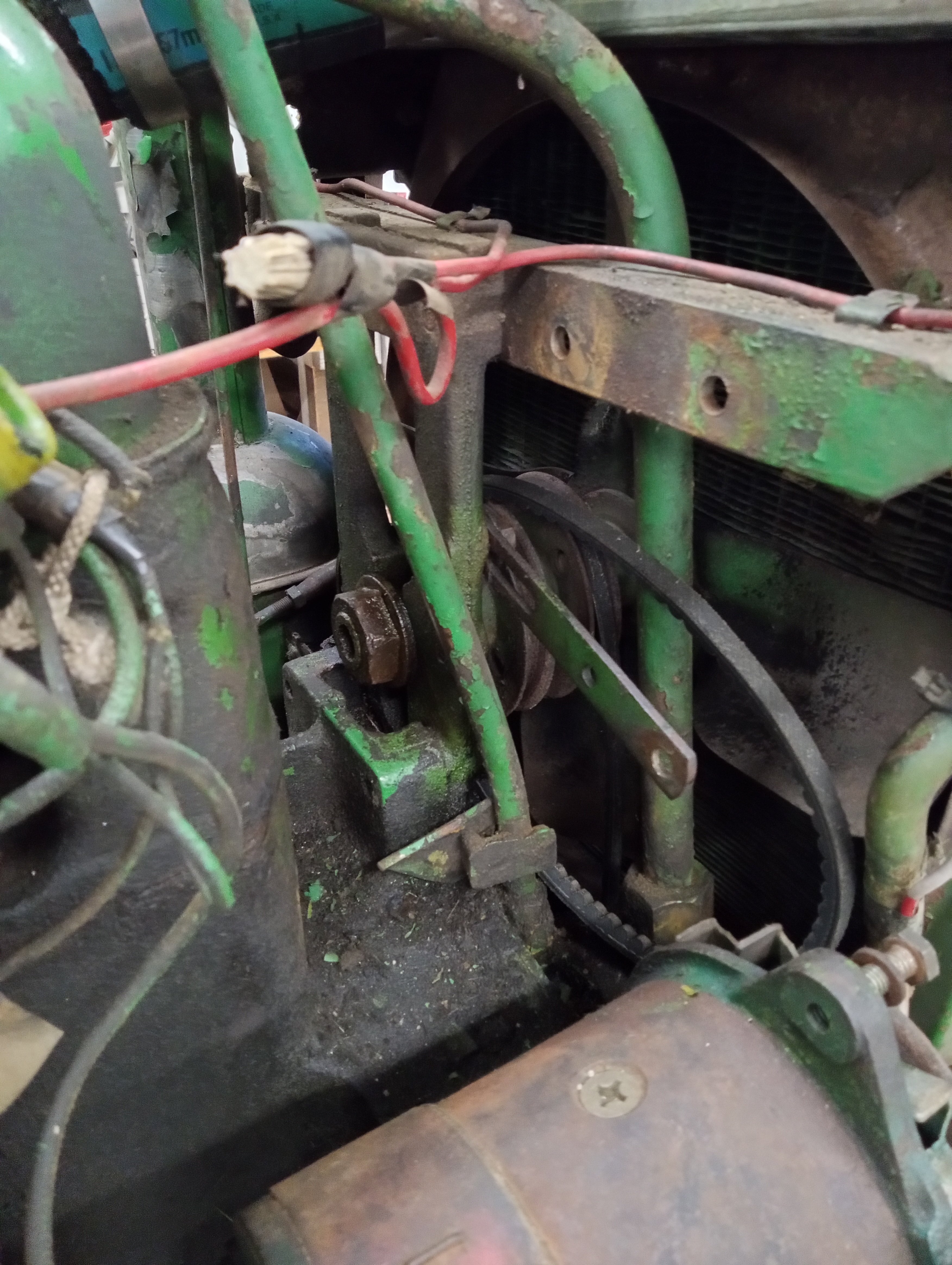

I need to replace the fan and generator belts on my JD model 40 tractor but cannot seem to find much information on the net. I have removed the sheet metal exposing the engine and radiator areas. I have also moved the coil and generator out of the way. I have obtained a 1 7/16 wrench that fits the large nut on the back of the fan assembly. However, I have not been successful in loosening the large nut. I have been applying penetrating oil and tried hitting the end of wrench with a rubber mallet but with no luck so far.
So, before I break something, I am asking for advice.
The first question I have is the thread on the large nut...is it a left hand thread? Or am I actually making the nut tighter unknowingly. Is there a better way to loosen the nut?
Beyond that, can you impart any suggestions or advice on the best way to remove and replace the belts once I get the nut loose? There is not a lot of working room in there and any suggestions are welcom.
Thanks.

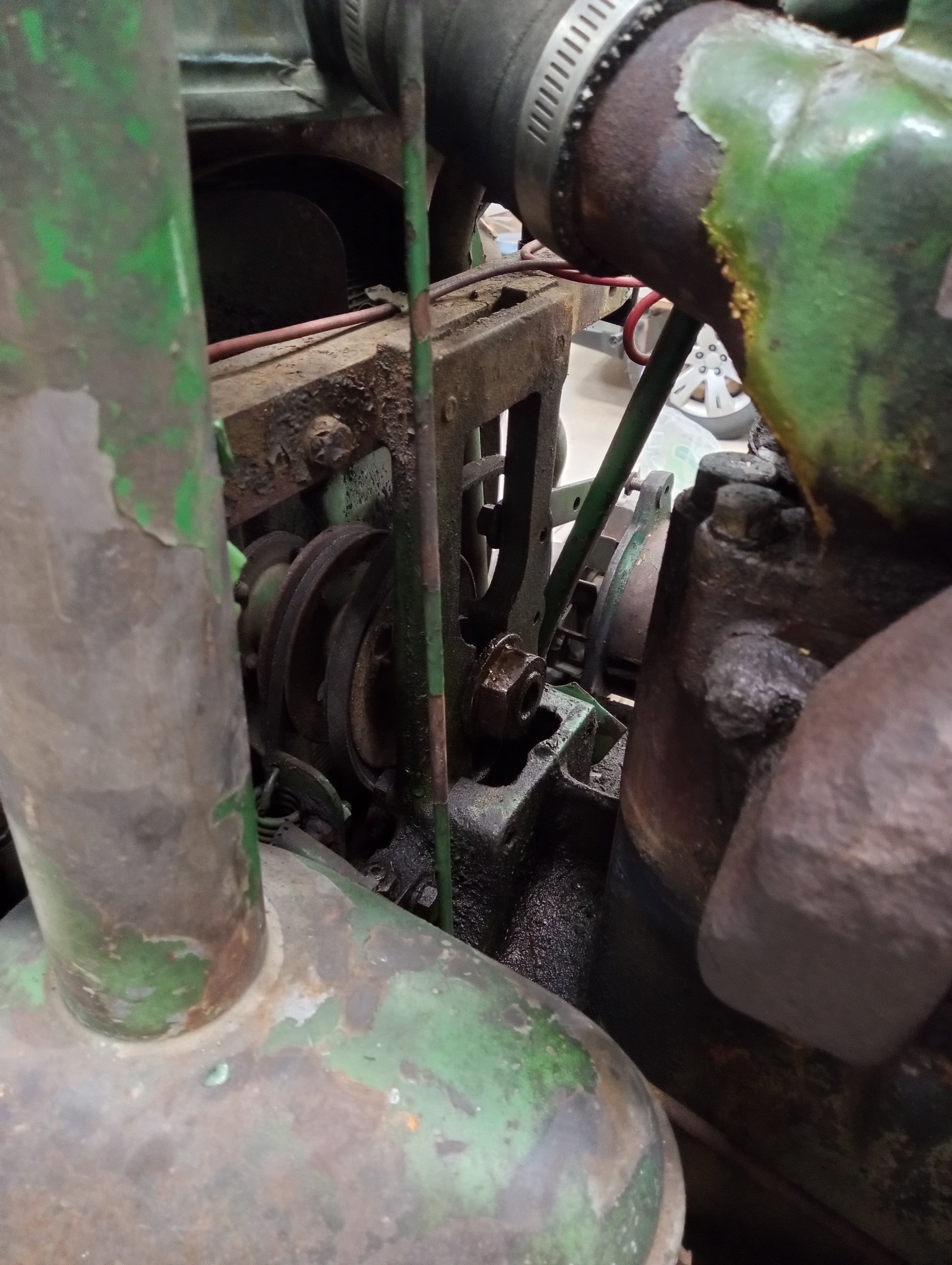

/ JD 40 Fan Belt Replacement
Thanks for the video but my problem concerns the large nut at the back of the fan blade assembly. Here's a couple of pictures of the area.

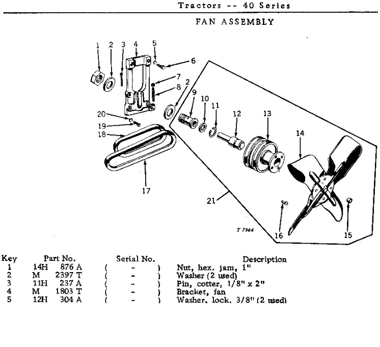

Maybe easier to remove that fan bracket (key#4) that the nut is attached to for better leverage (heat ? ).
Suspect that large nut is regular rh thread.
Thought about that possibility but temporarily rejected the idea because it looks like some other stuff is bolted to it and it will be tough to get the whole assembly out of the space. Thanks for the idea...I may eventually come back to it.

/ JD 40 Fan Belt Replacement #8
Is it necessary to remove the fan at all..?? Try slipping the belt over one fan blade at a time. Should be enough room for it the belt to fit between the radiator and fan if you loosen the fan to adjust it.

The problem is that the nut in question is what loosens the fan assembly to adjust the tension on the fan belt. To this point, I have been slightly successful in that I can now move the assembly up and down a bit. If I can move it enough to get the belts on and off as you suggest, I could consider a means of pushing up on the nut to adjust the fan belt tension, maybe a wooden wedge? or a piece of steel with a couple of adjustment bolts?

#11
I am not sure what you are suggesting. The problem is that I cannot turn the nut. It is frozen to the shaft on which the fan assembly is mounted. It is likely 40-50 years if not longer since the nut was turned and has rusted to the shaft. Unfortunately, everything is pretty tight so there is not much room to apply penetrating oil. There is also almost no threads exposed to apply oil to.
I am getting closer to your previous suggestion where I would try to replace the belts without removing the nut. Then I would need to adjust the belt tension with a pry bar and come up with a way to hold it in position since the nut cannot be tightened either.

Update. Decided to just try and remove the belts from over the fan. That was a success. However, there is one tight spot that has become a problem in installing the new belts. There is a spring loaded shaft that is pushed into a couple of detents on the crankshaft for crank starting the engine by hand. The old belt fit through the gap between the start shaft and crank pulley because the belt was worn so thin on top. However, the new belt is much wider and does not want to go through the gap.
Any ideas out there? Can the spring loaded starter be removed easily....or pulled back somehow?
