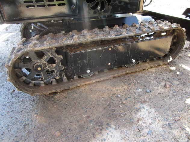

The splined or tapered with nut shafts should still be universal. They're on the outside of the machine. Easier to go to a tapered shaft since the nut and pin come with it. Here's a splined version on a MIVA VA13.
/ Chinese Mini Excavator Main Drive Question #6
I guess I don't understand what you're asking. You can't just change a spline drive motor to a taper drive setup. And I don't see a splined motor in your picture. So, I'm lost. 🤪
The splined motor is typically used as the rotator not the drive.

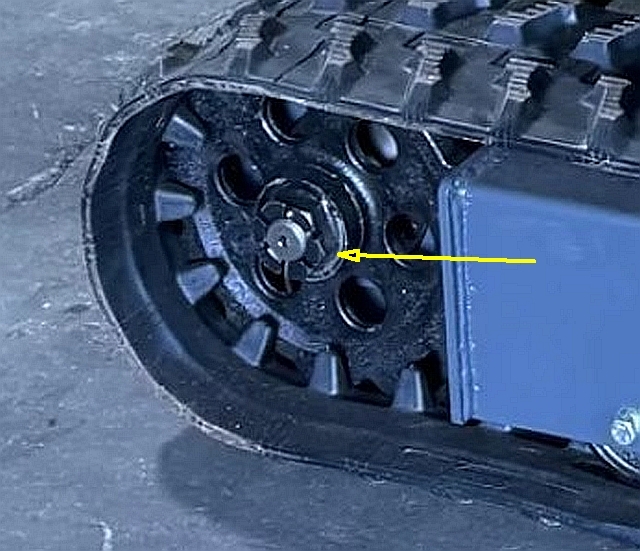

The MIVA probably does have a splined motor, but it's most likely used as the rotator motor. The BM6-310 is a splined motor and also likely used as a rotator motor. I can't tell in your picture of the "MIVA" but a close up look at a sample AGT (shown below) clearly shows a nut on the drive sprocket. That's surely a tapered-shaft BM6K-315 style motor--On the DRIVE.
You seem confused about where the motors are used. There are typically three motors used in the Mini Excavators. One to rotate (swing or slew) the cab and two as drive motors (one for each track). It's also not enough to know just the 7-8 prefix motor numbers because the BM6K-315 is also available in a splined version.
