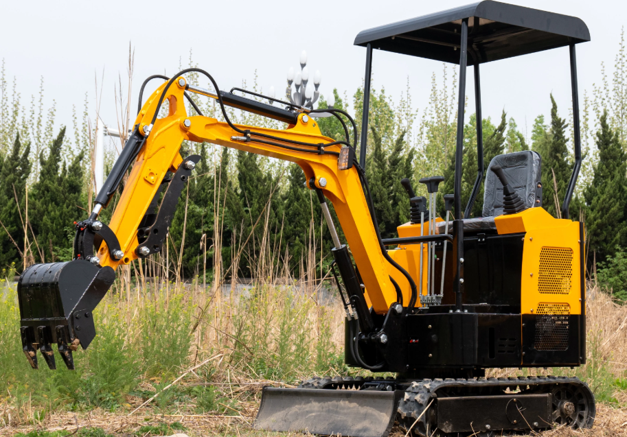

Not sure what your budget is, but I have been looking at these....it's between one of these and a towable backhoe.
Yep, those are similar to the ones I am looking at. Keep your eye on marketplace, they can usually be had for cheaper. Ebay also has some pretty good deals. Local auction yard has 2 for their April 15th auction, I will watch them closely. 1 is a cabbed model with the front window out. Hoping to score that one at a good price.

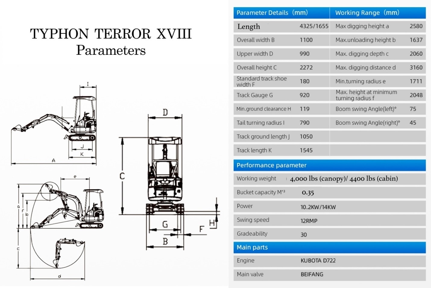

On the same boat as most of you. Looking to buy a 2-3 ton mini ex diesel. I sold my previous machine a 1-ton Rippa NDI313 gas. I found it to be too tippy, unstable, jerky, light and severely underpowered. It would also overheat. Right now, I am close to making a choice. I made a spreadsheet with several categories that I though mattered. Track width/length, machine width, engine, weight, engine access for maintenance, price, shipping cost, build quality, digging depth, digging reach and boom swing angles L/R. I wanted to add digging force but I couldn't that information for all of them. The machines were Huayee HY18, Rippa R15 and Terror XVIII. The Huayee came on top followed closely by the Typhon. I though the matter was settled until I saw the Terror X2. I like the size of the X2 and the enclosed cabin with heat and AC. I couldn't find info on the AC system, if it is electric or engine compressor driven. From reading through this thread, it seems like the X2 attachments are much more expensive than those for the Huayee. What are your opinions on my process and machines picked. Another one I am looking into is the AGT-NTB45U. But I can't find much information on build quality, reliability and real-world usage.

I just bought the Typhon XVII with cab last month. My previous mini was the 1-ton Terror X.
My experience and research before buying the 17 followed a lot of the same things you mention in your post. Unfortunately I found that there is real problems with the imported Chinese excavators having all the things you would want in any one of the minis that are for sale.
It seems if you get one with a good Kubota diesel it often is not easily accessed for maintenance. Or if it is easily accessible that some other feature you might want is not available. Such as a better quality hydraulic pump. Or if it has a great hydraulic system it might not have a good thumb or use the common attachments for the 25mm pins. Cabins may be poorly matched to the excavator or Aircon units if DC may exceed the engines alternator ratings.
Manuals and specifications may be hard, inadequate to find or simply wrong. You can appreciate why some folks go for the dealer imported units that they brand for sale. Those dealers have often specified things to make their brand a better unit.
From my research I will say that the Auction machines are the lowest average quality, AGT is basically in this category.
Good luck on what you decide. You can read about my TT-17 in the Thread I made about it here at the forum.
