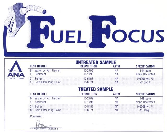

That's one of the big problems. Your fuel may be fine in your region of Kansas, it's not fine everywhere. Fuel quality vary's a lot from region to region, even fuel station to fuel station. All depends on which terminal it came from and which crude it was refined from. Try telling the New York School District that there's no difference in fuel. They had to shut down school last year because they were having such a bad fuel gelling problem.
Here's a prime example of how the CFPP has gone up. A sample taken from a pump (treated at the terminal) and then the same sample treated with a off the shelf pour point additive. Not sure about where your at but it can get below +7 deg. F. where I am and I'm on the MD/PA state line.
