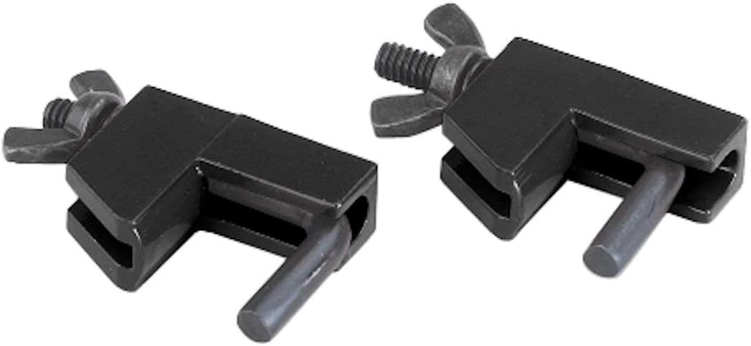

Closest I can come is a BX24. No deck to remove but did have a Bro-Tek crunch plate in the way. Once stuff is out of the way it's no big deal, but I'd suggest you have something like this handy. Otherwise it takes 3 hands and a lot of shop towels...

OK, I give up ... what do these things do?

Those clamps are used to pinch the hose off without damaging it from sharp edges like pliers or vice grips can.
Oh, OK. Understand. I have been using small vise grips for that purpose and just being careful not to crush the tubing.
