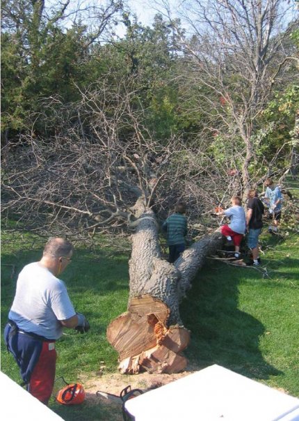

Here is a typical oak I cut. This one was 32.5" diameter............
