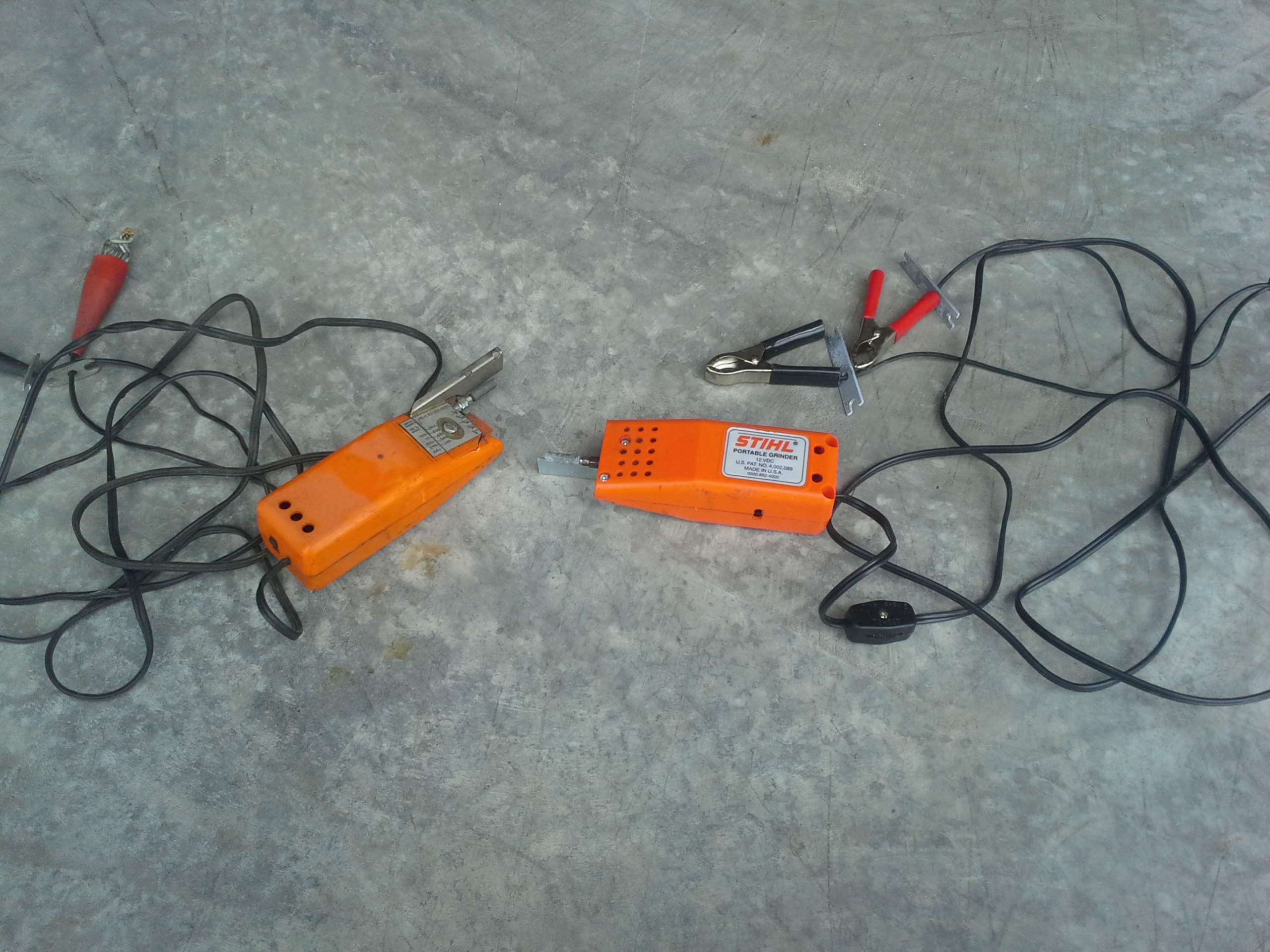

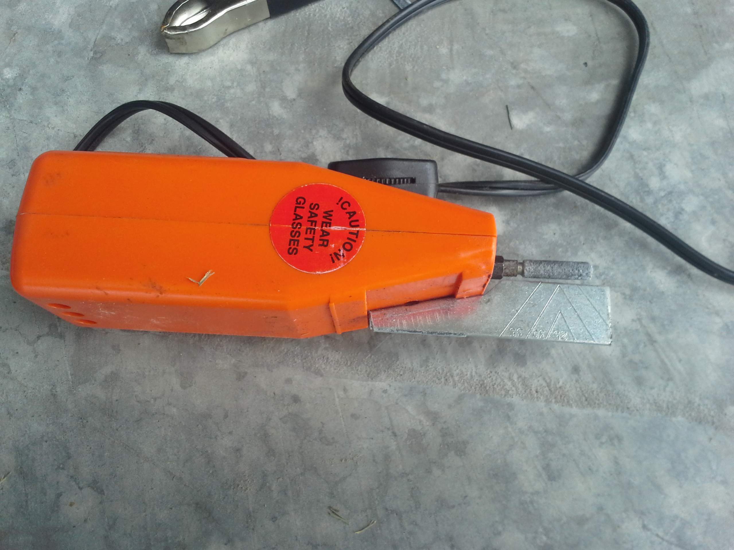

I would assume any Stihl dealer would have them. That's where I bought a new one just a couple years ago when I bought a new saw. It was like 30-40 bucks and its so easy to use.
The one on the left is the old one. Still works but has a broken housing. The right one is the new one, in the close up you can see the lines that you line up with the bar. Only takes a second or two on each tooth.
