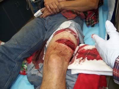

I cut pro for over 10 years and have the same pair of full wrap chaps and they don't have a mark in them from a chain. BUT I always wear them. When I don't have them on I am way over careful and I don't feel right without them. I offered them to a friend when clearing land for his house and he said no. Well you guessed it, cut his leg bad. The few minutes he would have spent taking them on and off would have saved him a month off work! CJ
