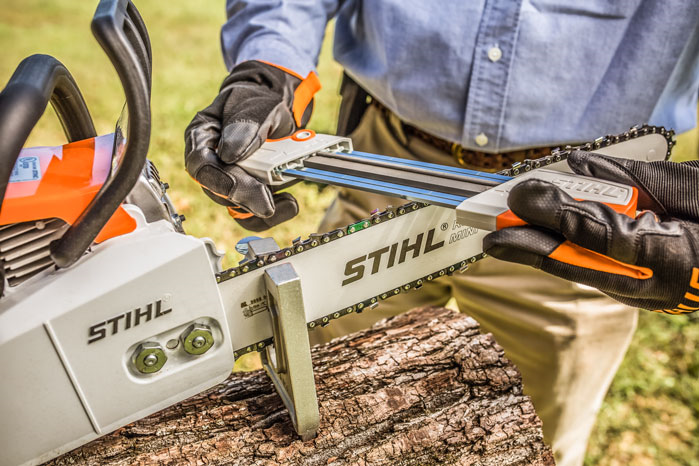

I bought one of these a few weeks ago. I was skeptical but thought it would be good for touching up the chain in the woods. It works great and takes only a few minutes so I bought another one for my 3/8 chains
I recently replaced my 40 year old saw with a used Stihl 290. The chain had been abused and is .325 so I needed a new file setup and lots to be filed back. I went for the fancy Stihl sharpener and I am amazed with the strips the saw produces. Clearly I was not filing back the rakers enough on my old saw.
I highly recommend this file for anyone doing their own sharpening no matter the brand of saw.
Peter
I’d recommend starting fresh with a new chain. It’s a lot easier to maintain a sharp chain vs clean up a damaged or poorly sharpened mess.
