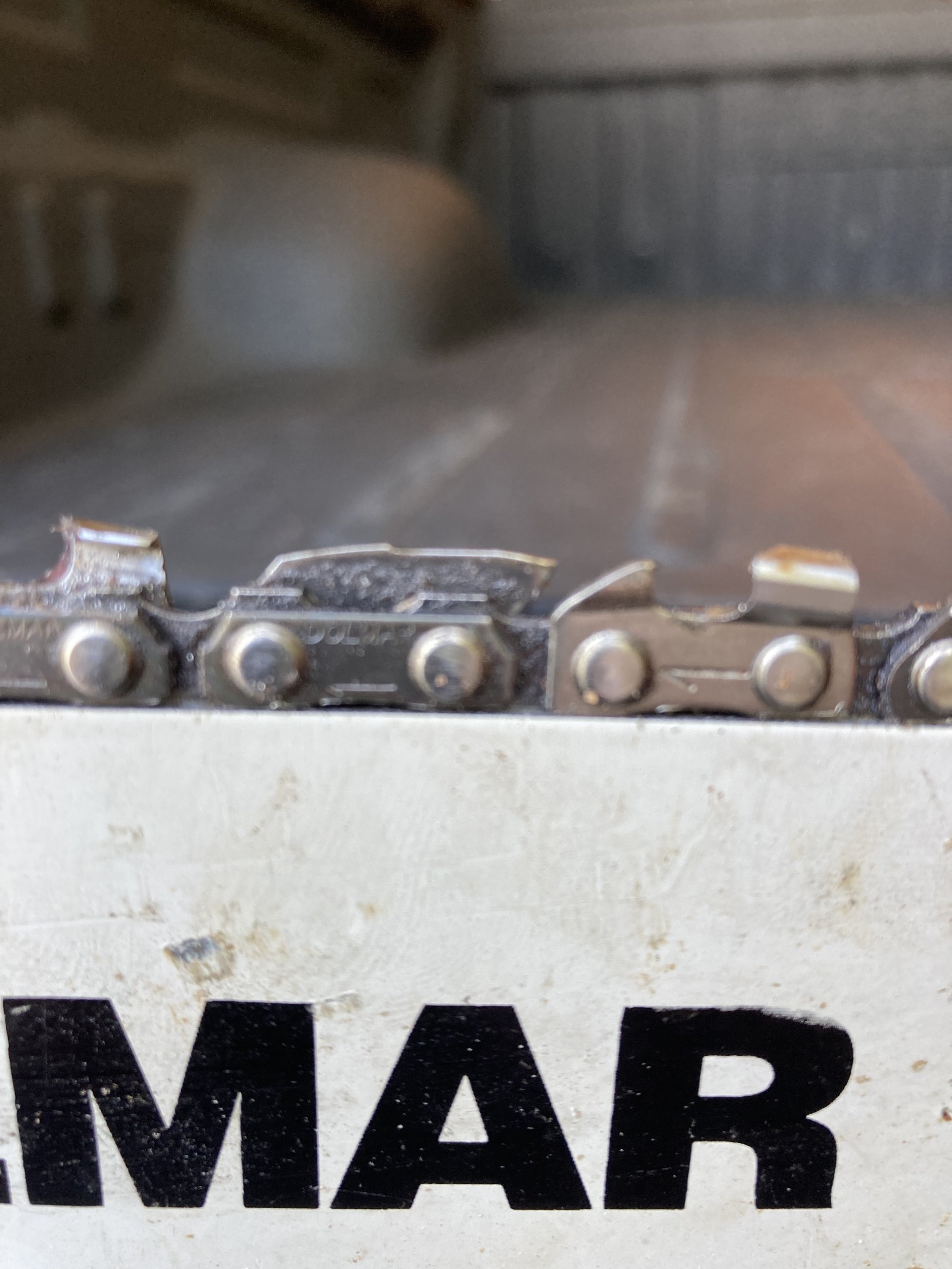

When I lived in Maine I cut a lot of wood and like to think I know what I'm doing and stay as safe as I can. That's how I wound up with low-kickback chain in two saws that I haven't used in a long time. There are few trees where I live.
In getting ready to use them, I can hand file the teeth correctly but forgot how I used to do the rakers on this chain. There is another piece of metal on the chain that interferes with filing the raker. I don't know if a standard raker plate is what to use or what to do and not much on the internet for advice.
Any help or advice on filing low-kickback chain rakers?

Which low kick back chain? Pic worth 1000 words or at least more info then that given.
Some file just like normal and some dont.

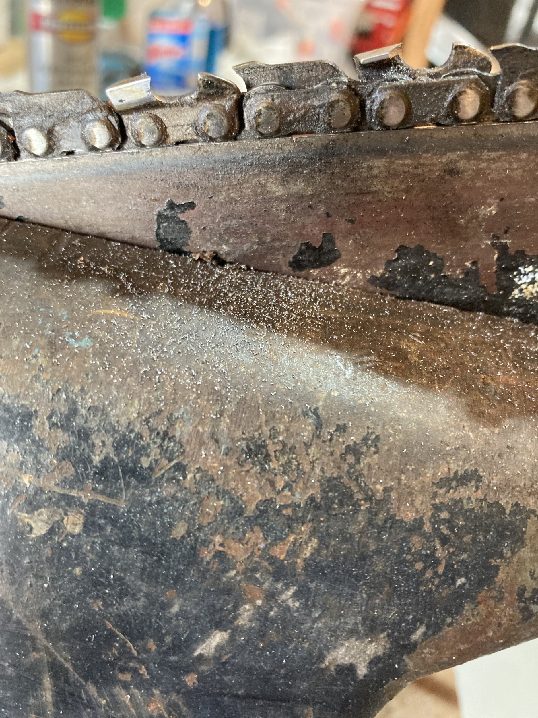

Here they are...
In looking at these ( from two saws) magnified, I can see the anti-kickback things are just thin rakers the same height as the rakers. What do you think I should do?

Those 3/8LP 325 chain with shark fins you just take the raker down with the flat file. Those are easy ones to do.
Slowest dang cutting crap chains made IMO in 3/8LP too. Those are what I use for root cutting.

You can buy a raker gauge that sits on top of the chain with a cut out for the raker. Use a flat file and file according to the gauge.

I’ve got a Stihl racker gauge I use and maybe file them a hair lower. I use a Stihl chains but there are other good ones I know. I’ve never seen a chain like the OP showed in his pictures.
