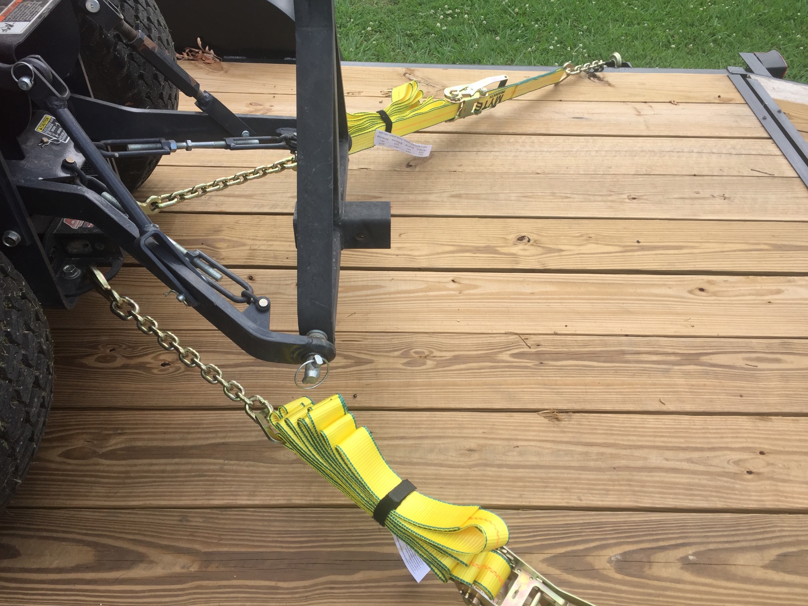

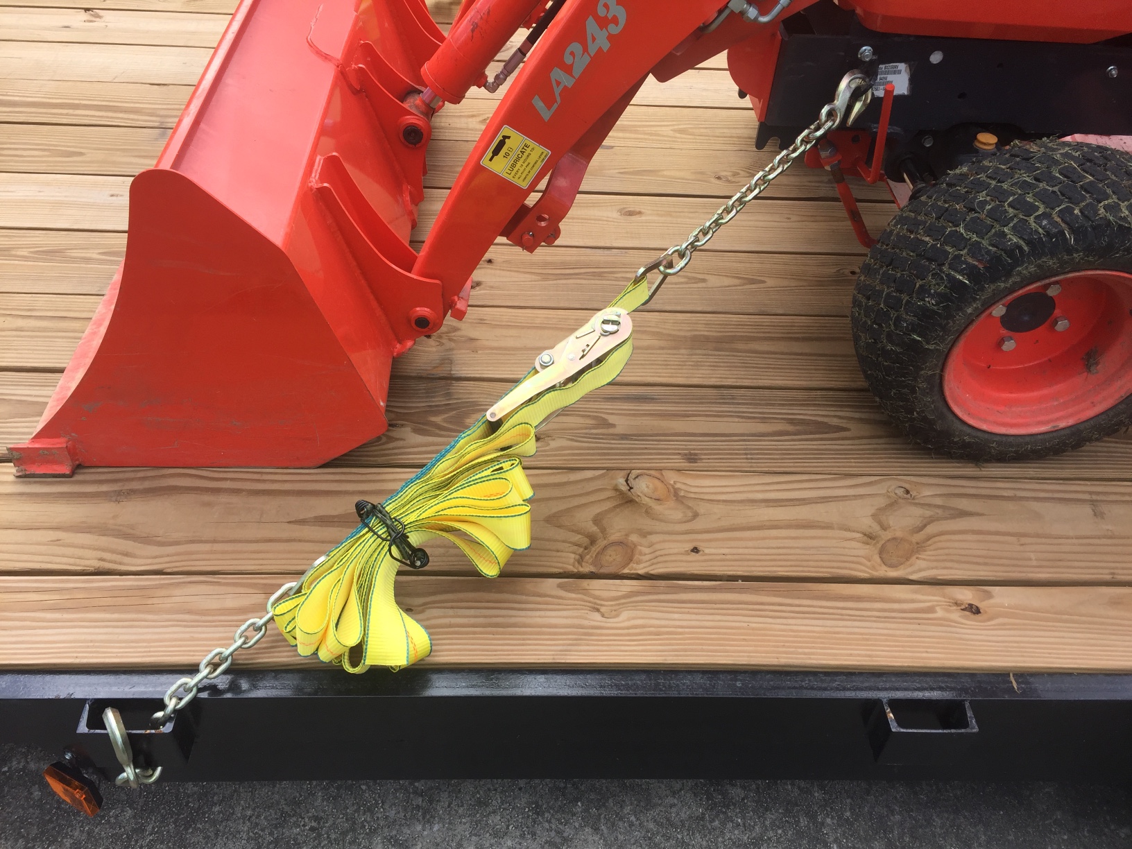

I use these 2in straps with chain ends on both strap and the ratchet. I still have to ensure the strap isn’t rubbing but the chain eliminates some worry.
Way overkill with 4 at 3,333lbs working load on a small tractor but it doesn’t budge. We use them on a BX2360, B2601 and will use them on the MX5200 next time it’s trailered.

View attachment 677323View attachment 677324
Those strap ends are making my eye's twitch.
I started using this method last year for dealing with the strap tails and it has changed my life:thumbsup:
   / Chains vs straps #50
Yea that’s before I trimmed them down. Ended up cutting them down to about 15ft to get rid of the excess tails. I lasted about one day with them at original length and couldn’t stand it! Took longer to zip tie the tails than strap it down!
