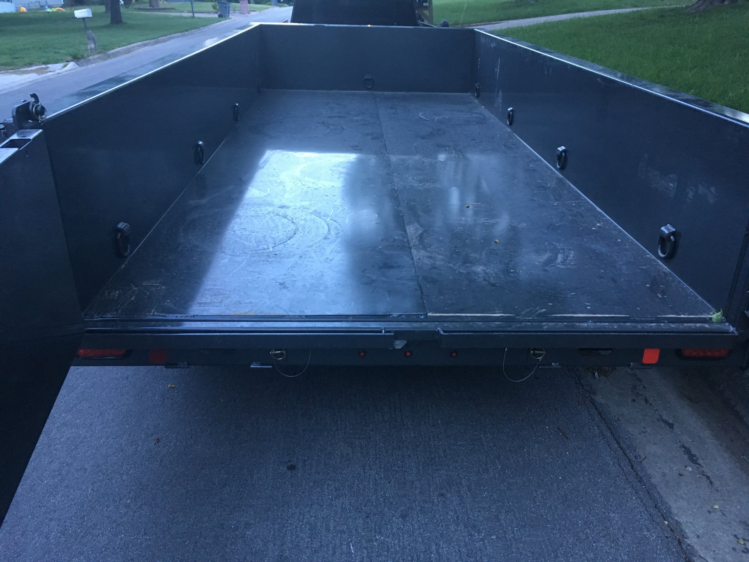

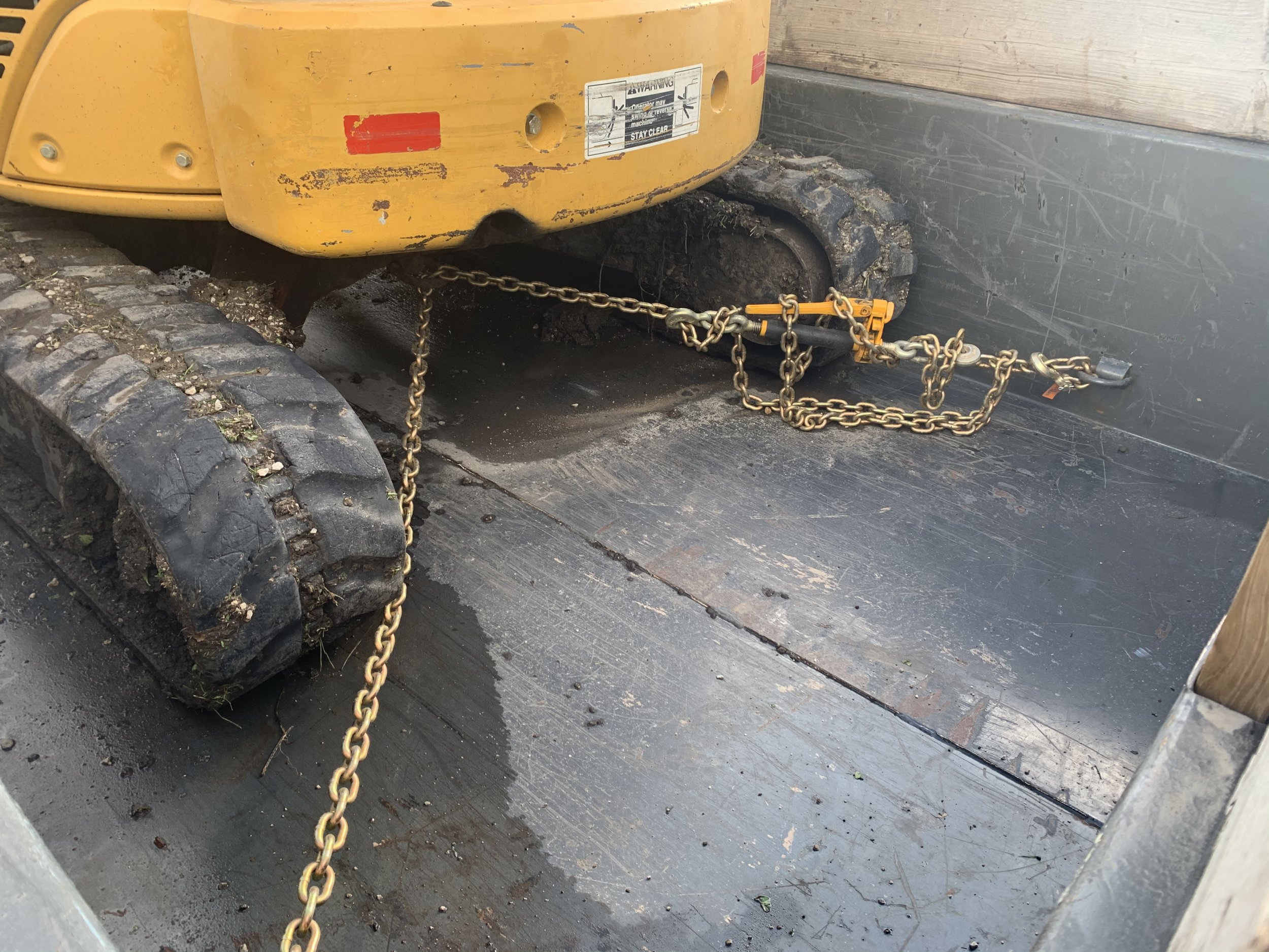

When I ordered my dump trailer, I specified nine D-rings on the walls, six inches from the floor. My floor and side walls are 7 gauge steel. I also ordered one D-ring, in the very front. The front wall is only 10-gauge, but just below the front D-ring is where the floor has a 4” overlap. The front also has extra structural reinforcement through a tarp mount and the fact it’s a shorter run. The front doesn’t get used for a lot of heavy lifting, but the corners do.
Here is what it looked like, new:
And with a JD35D:
You can see, for the mini-ex, I use six of the nine D-Rings.
If your walls aren’t very thick, you can put the D-rings on a backing/reinforcement plate, then weld the plate to the trailer sides. The bigger the plate, the more the pressure us dispersed.
And with a JD35D:

Thanks for the pictures. Those D ring locations are a possibility but your trailer looks to be heavier duty than mine. They would need considerable reinforcement. Maybe something could be fabricated at the stake pocket gussets.

My trailer is definitely heavy duty. Empty, it’s around 5,000 pounds. The box I have is the same one they use in their 24lk trailers (different axles, lifting mechanism, and couplers).

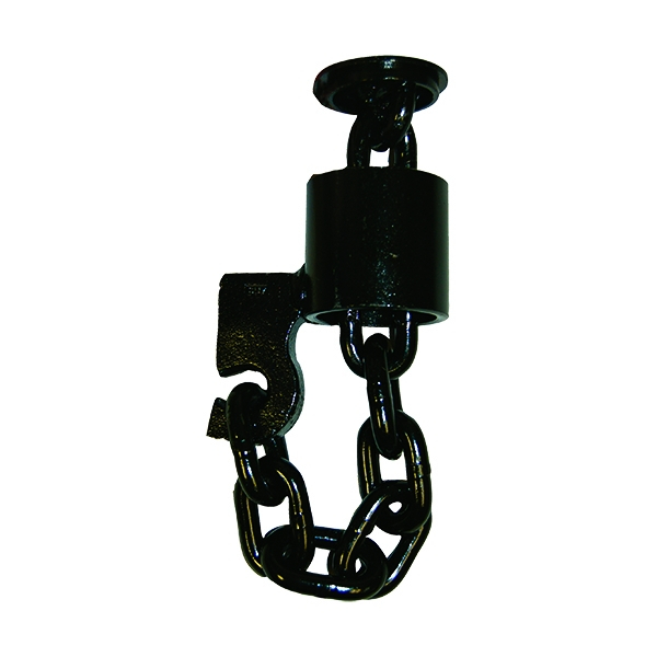

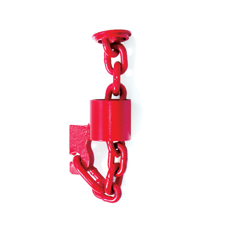

I have seen flush mount chain lately that might work well for you. Not sure what to call it, mounts flush to the floor, you can pull it up and you have a short length of chain to work with that is secured to the trailer. Not sure what load ratings they come in.
These?:
   / Recent projects with new trailer
#28
These?:
Yessir, those are the ones!
I'd probably bolt some healthy d rings in the corners where it will have a minimal impact on dumping material, with a backing plate if necessary, and let it ride. At least for now until I came up with a better idea. I'm all for getting the most out of what I have!
