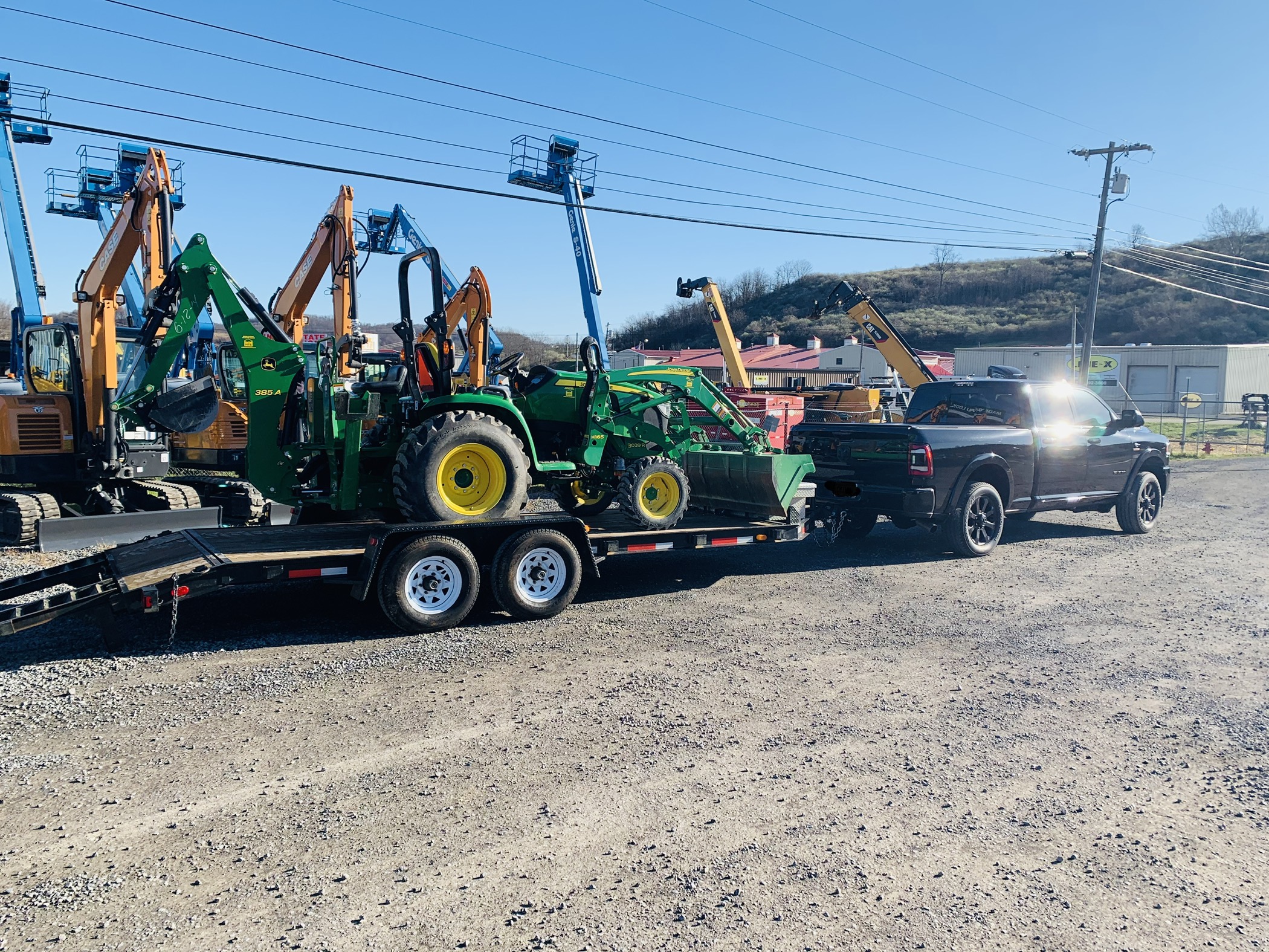

Greetings. I was hauling a John Deere 3039R for a friend recently on a 550 mile trip. All we had to tie down with was 2" ratchet straps. I had a mix of Macs and Husky straps. We put 8 straps on the tractor. It seemed like overkill, but we had them and I wanted to use them. About half way through the trip, we hit some really bumpy roads so we decided to stop and check the straps. The webbing had broken on one of the Husky straps. Needless to say, this somewhat broke our confidence in the straps. All I ever hauled heavy has been Jeeps. Are straps even considered safe for hauling a tractor like this, or should I have used chains? Asking in case I ever need to haul it again. Thanks!
Buy heavy-duty commerical 4 inch straps with end chains and hooks not the 2 inch cheapies ..

Move the weight backwards a wee bit (the pic looks a little front heavy with a lot of tongue weight for your LD truck), chock the tractor wheels, make sure the loader is in its lowest position and can't move (make the bucket flat or all the way forward, not in the middle). Get wider straps than 2 inch and make sure they ratchet properly and the tractor is snugged down tight. Don't waste money on uncertified cheapo straps. If the straps are failing for no reason then throw them all in the garbage and switch brands asap.
What's your tailer and tractor weight?
5700 with attachments and 2300 on the trailer. The suspension settled about 1.5-2". I may have been a little heavy on the tongue weight. I may get weigh safe hitch in the future. Thanks

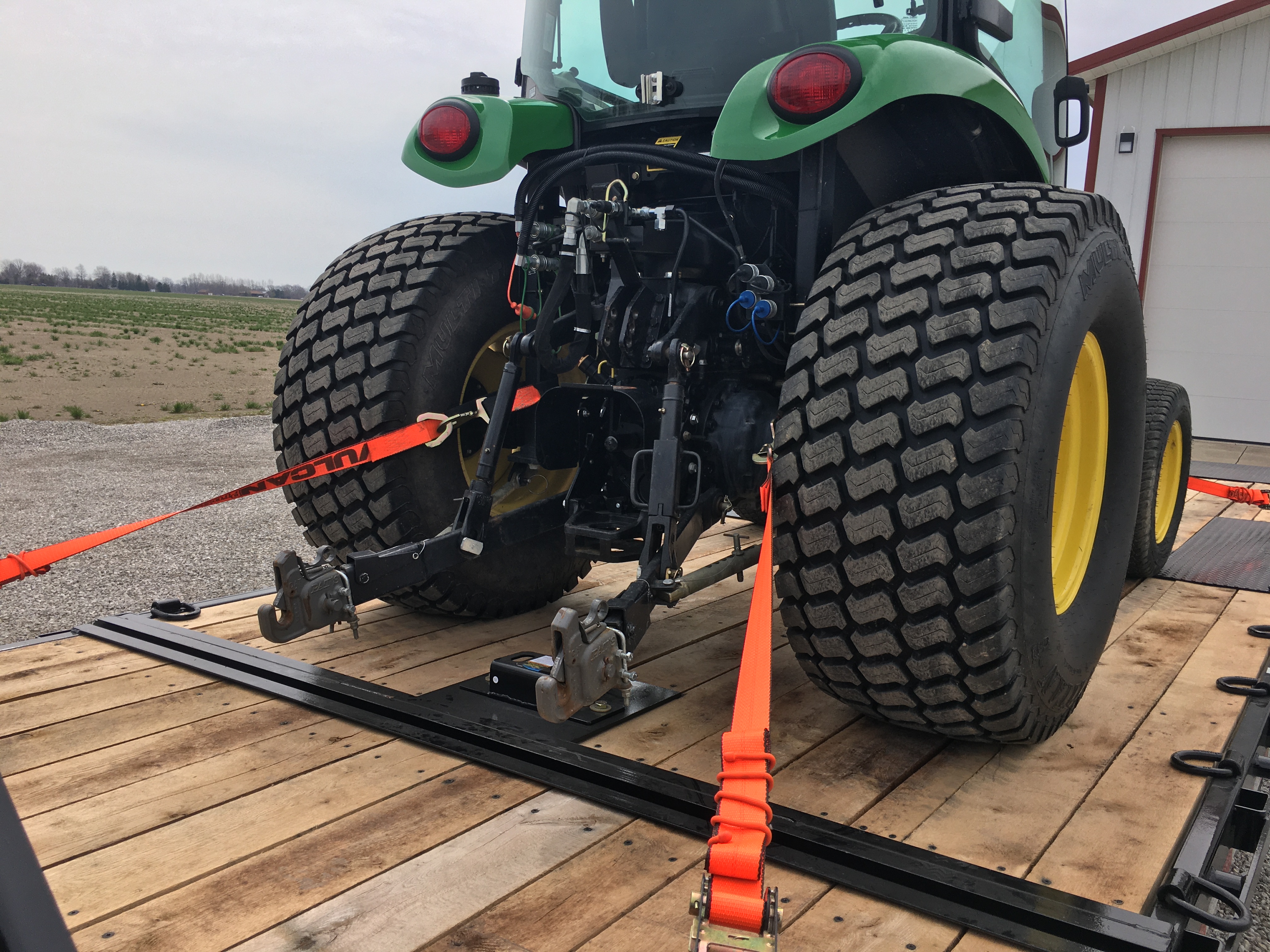

I used to use chain on all four corners. Switched to 2" commercial axle straps. The tractor is only 5K and 4 straps handle it without an issue. The have built in abrasion sleeves and are rated at 3300 lbs WLL each. I still use chain for the loader and any rear attachments as they all have sharp edges that will destroy any strap in short order.
VULCAN Snap Hook Car Tie Down with Flat Snap Hook Ratchet - 2 Inch x 96 Inch, 2 Pack - PROSeries - 3,3 Pound Safe Working Load
Looks good to me, good geometry on the straps, straps are high quality. Only thing I might change is some say don't strap to the front axle. So make some loops to bolt on to front of the frame to attach the straps to.
