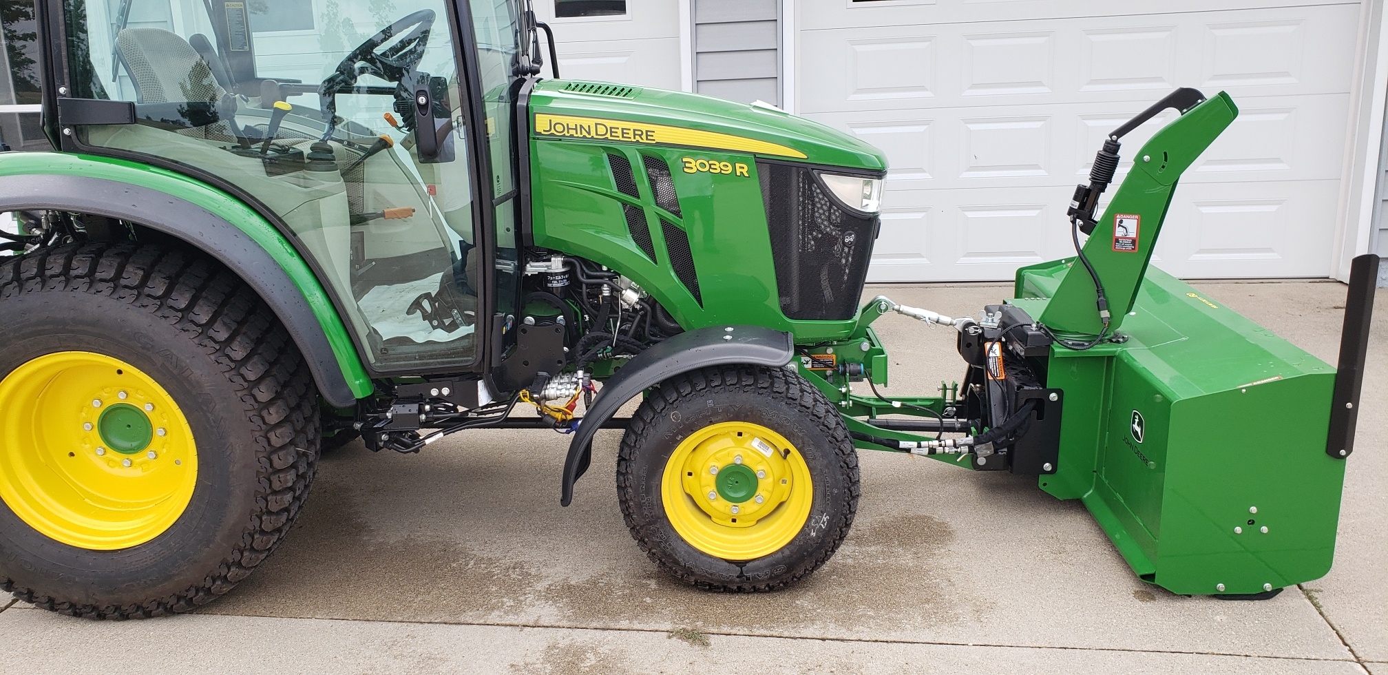

Sure, it definitely IS the front end. But in Europe many, if not most, large tractors use a front end 3pt hitch besides the std rear end one.
We don't have to go to Europe to see one, my JD 3039R has a 3 point hitch on the front.
Is that a true 3 pt hitch or some proprietary design the JD uses and requires their expensive proprietary implements?
A true front 3 pt will accept any 3 pt hitch implements and that's what we have in Europe. It will also have a true front PTO, instead of an exposed shaft underneath running from the rear PTO or the mid PTO.

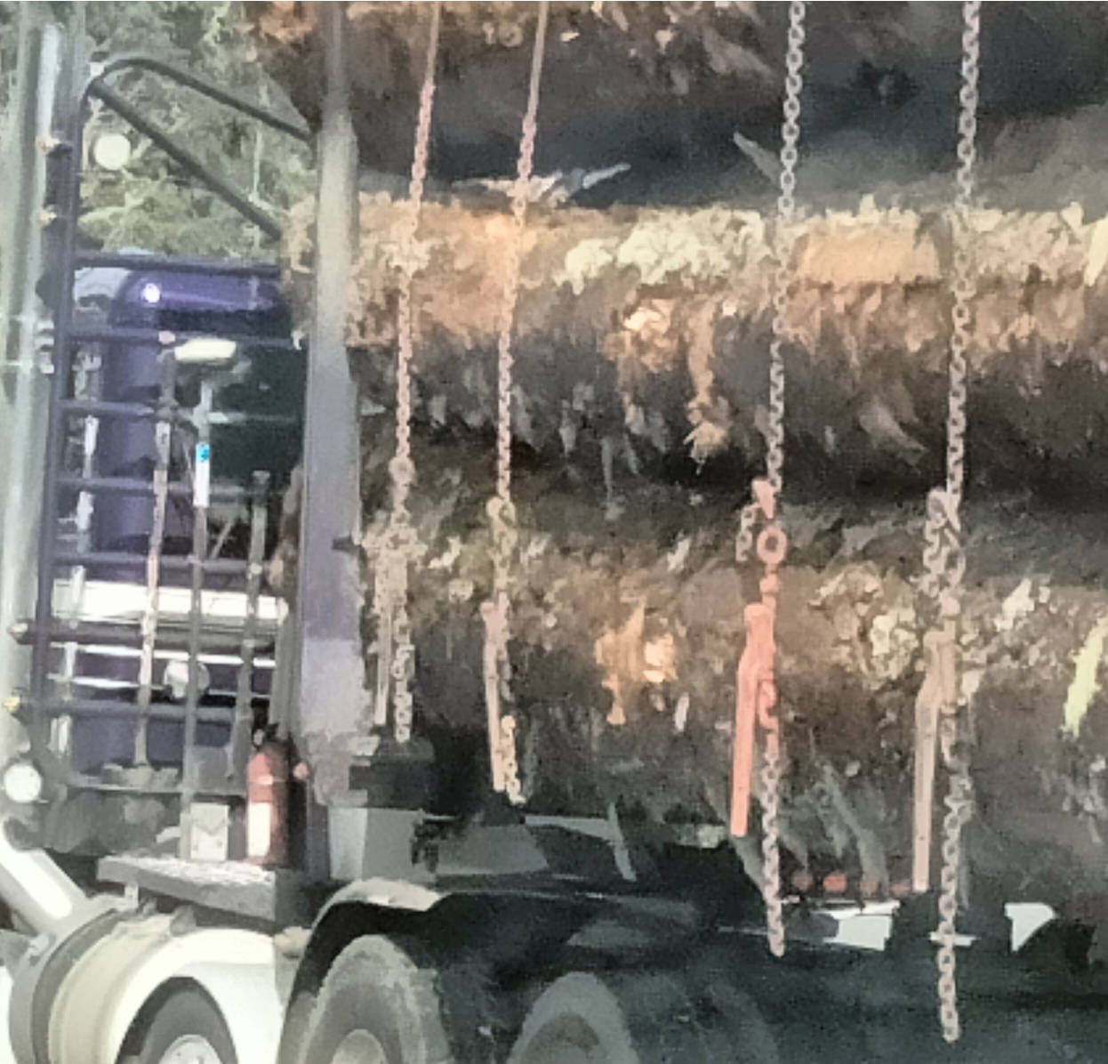

Someone mentioned that the fold over binders have been outlawed by the DOT?
They definitely are still used on log trucks around here.
I don't know if they are load restricted by DOT.
The log loads are perfect for the snap type binders. They don't hang out wider than the load, and weight holds the handles downward.
Plus I've had issues with binders on solid loads like steel, not enough flex in the loads to get them adjusted properly. The logs likely have enough spring to tighten down well.
It's a proprietary hitch for Deere stuff. I like it, does everything I need it to.
