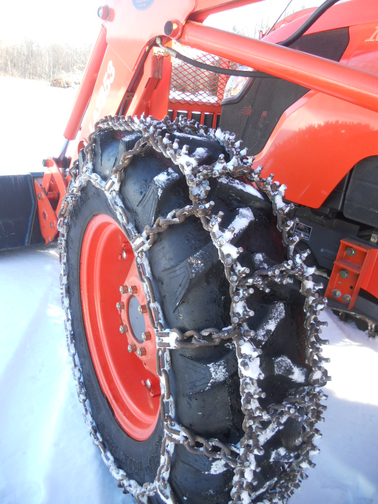

I'm sure this has been discussed, but couldn't find.
Are tire chains best on front or rear tires?
I use FEL to push and scoop heavy snow that falls off the roof of the barn. The way the layout is, I'm pushing or scooping on a side slope, that's usually vey icy, and turning and taking the snow down the slope to push over a bank. A downhill trap.
Today it was almost impossible to not slide sideway on the ice, or turn (especially if I had lifted FEL with heavy snow). Plus the rear is a bit light with a loaded bucket.
Yes, more ballast would of helped. Tires are loaded (I think 750lbs ea), plus a 470 lb skidding winch on 3 pth (should of bought the 795 lb next size bigger!).
But, if you have to add one set, where would they be?
Same for my four-wheeler Polaris 700 ATV with plow. Where would you put one set of chains.
In both cases it seems chains on back wouldn't be worthwhile without weight.

I have "ice chains" on the front because that's what a buddy found for $300 on CL:laughing: The rear "ice chains" are $1400!! Traction wise, on packed snow/ice I'm fine. I think I'll settle for some 2 link regular "ladder" type chains for the rear, much easier on the wallet. The front chains give you good pulling & steering especially with a load in the bucket. I'd be leaning for all 4 on the ATV, they should be a lot less $$.

There's been loads of discussion on this topic, many let not run chains alone on the front, others do and that works for them. I run chains on the rear only, and that works for me. Rear chains will cost more and they weigh more, so more work to install. Chains make a big difference.
/ Chains: Front or back? #5
Chain up the loaded rears first then add chains to the front if you still need them. The weight on the rears helps the chains bite into the ice. Even brand new not on sale rear ice chains are worth the price. You only need to slide into something you can't afford to hit once to spend way more then that.
