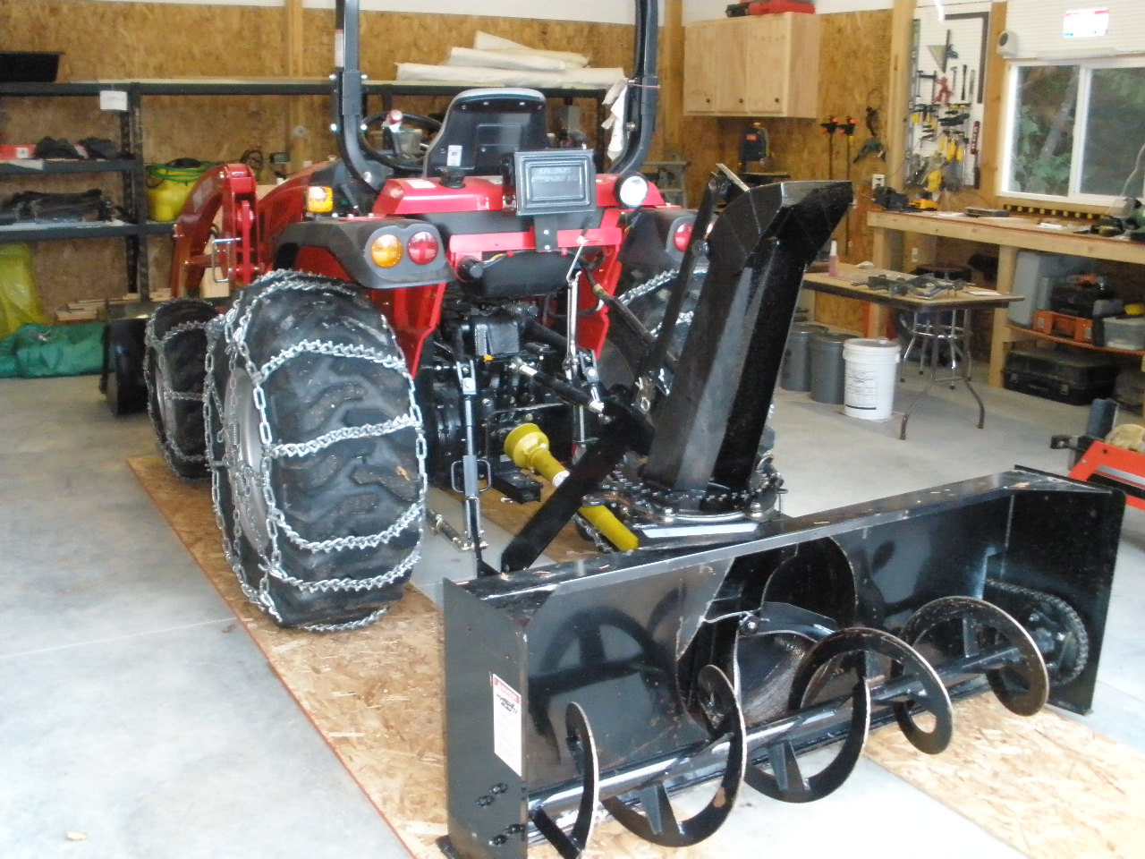

I have been using 4 link v-bars on all 4 tires since I bought my TYM 353 and love them. A little bumpy while riding but no slipping on packed snow or ice. They do eat up the shop floor hence the OSB to park on. I keep the tensioners on and the cross pieces have never slipped between the treads. Tirechains.com has been a pleasure to deal with.
