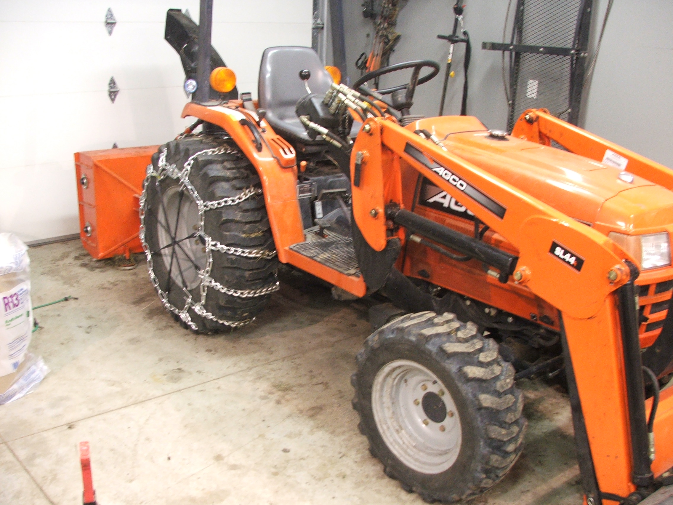

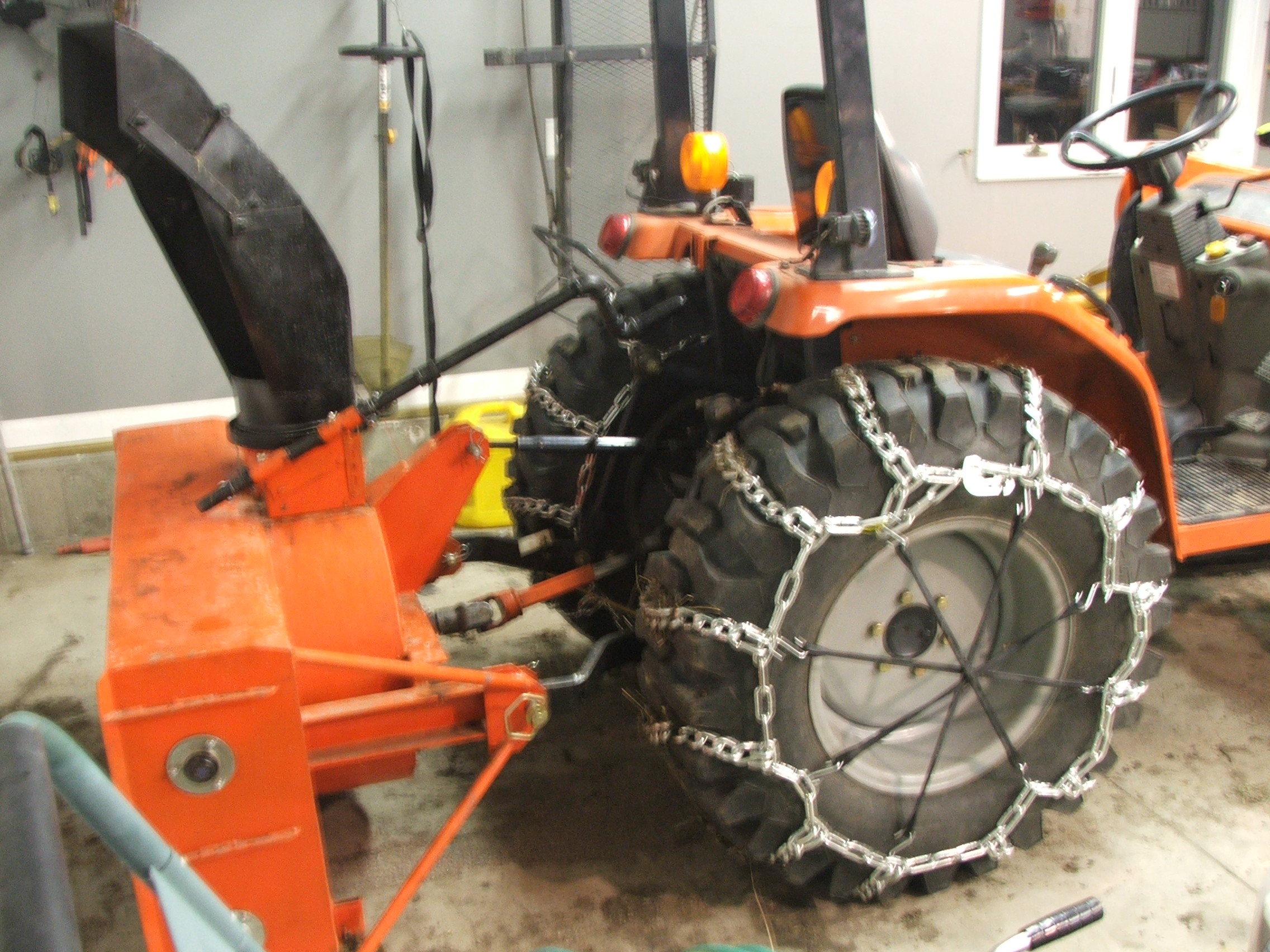

for like $100 bucks i would just buy some chains and try them out. alot of times when i used and angled rear blade the snow would pull my rear end over and sometimes off the road. 4 link chains can be a little rough riding but they are the cheapest. Tirechains.com is a pretty good deal.
